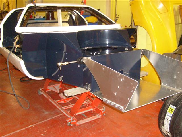

You can get really good effects these days with powder coat. Everything from bare aluminum to chrome. There are different multi-step processes used to get this effect, looks great. Here is a chassis we just did for a customer who wanted the look of aluminum. You can also do metallic colors too. Which looks good.

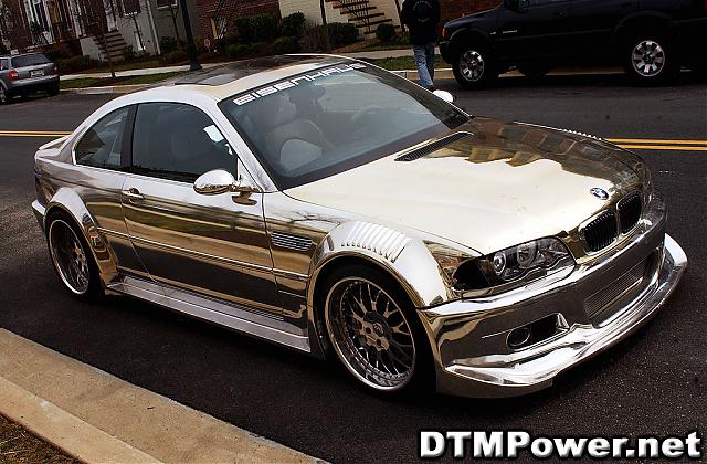

will be possible to have a finish as this one?
will be incredible on a GT40:eek:
