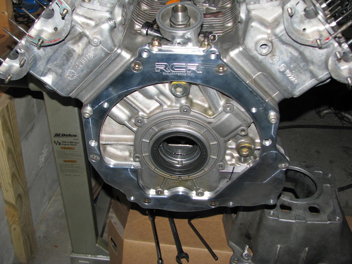

Got the finished adapter this week.
A huge THANKS to Fran and the guys at RCR for making my design into a real part.
Now on to the next challenges. Flywheel and starter relocation.

I wanted a bellhousing that generally matched the Ferrari block. I found all V8 bells were so large that they came up higher than the valve covers, really ugly looking. The Ford 2.3 bell was the perfect size, and came with a T5 pattern.
Also I can get the ratios I want, several tail shafts to place the shifter anywhere I need, and as you mentioned, it’s only 75lbs total weight. Plus compared to the TKO, these can be had for cheap.

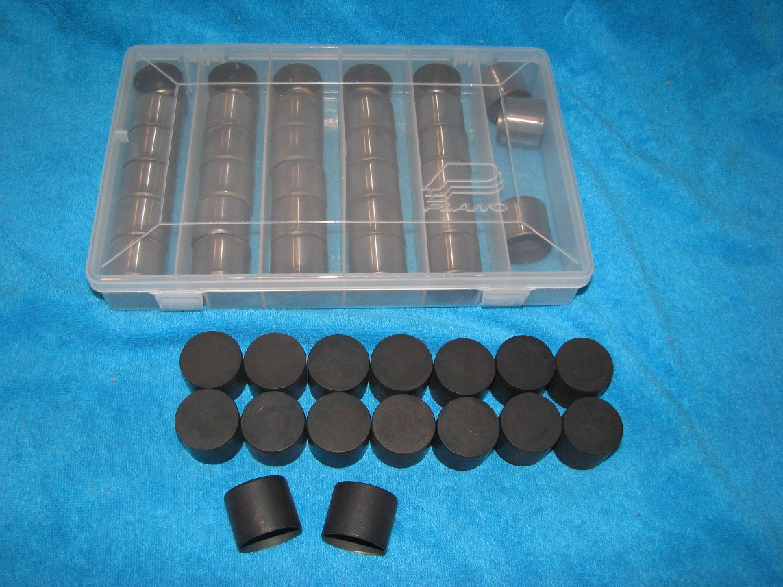

Shim under bucket

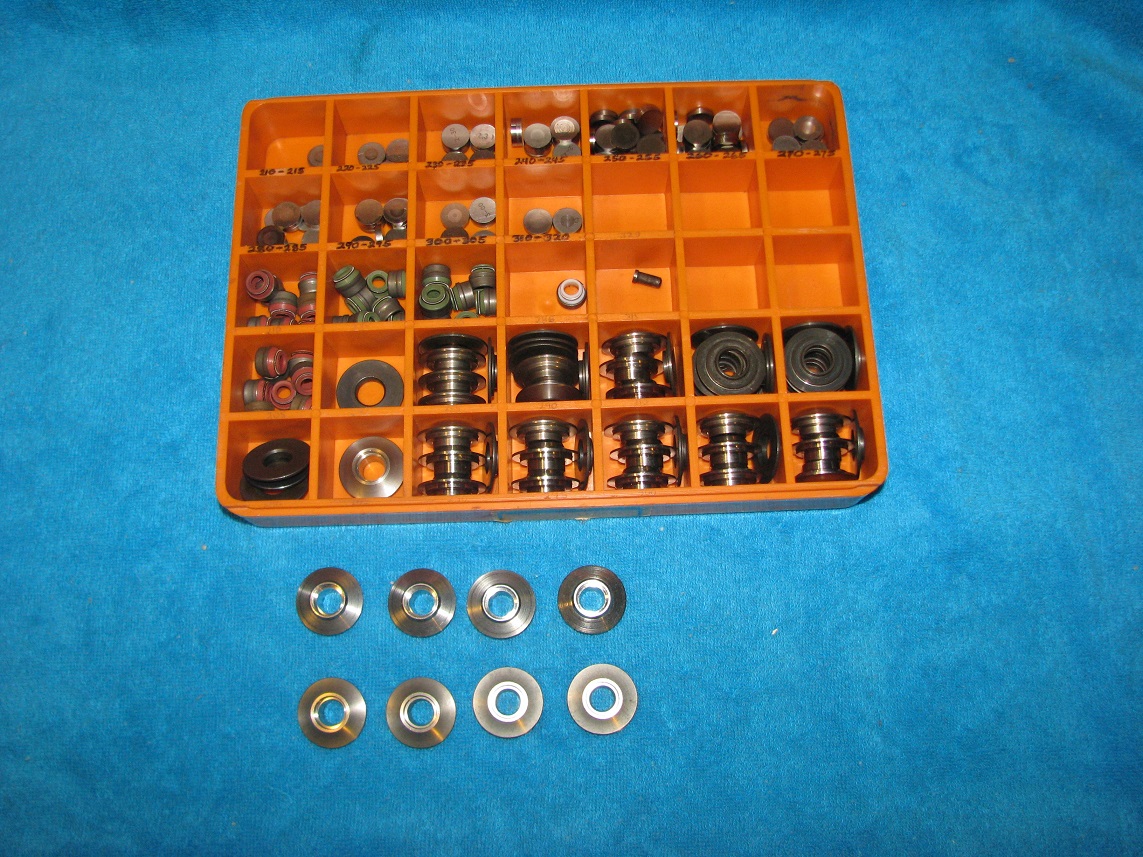

Titanium retainers

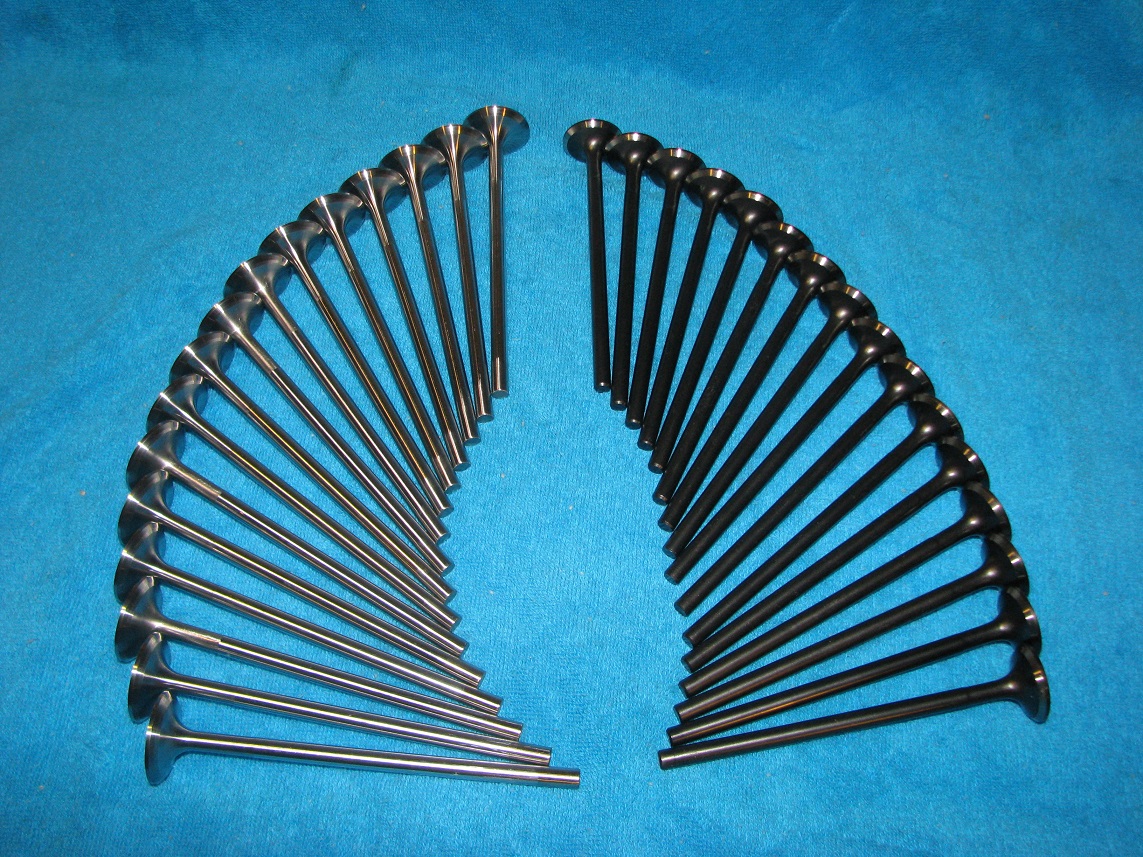

Oversize 31.5mm intake valves
Oversize 28.5 exhaust valves

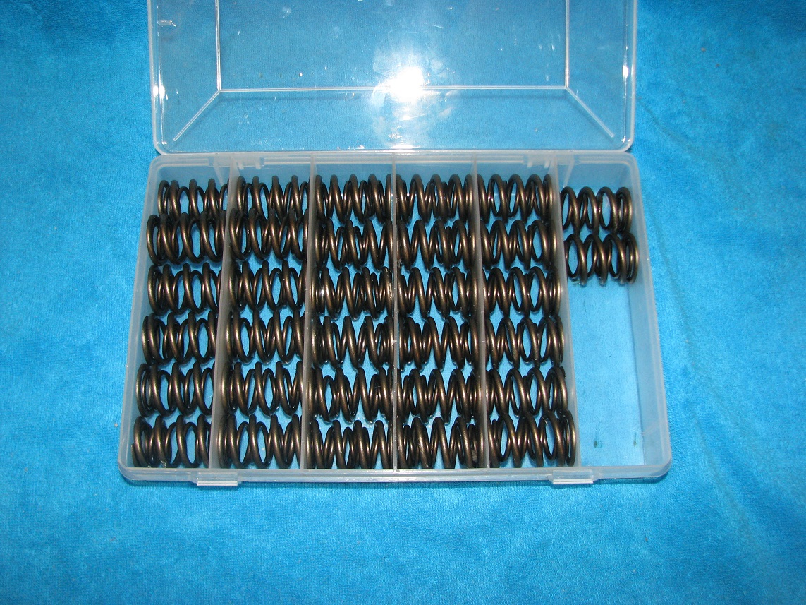

Aftermarket springs

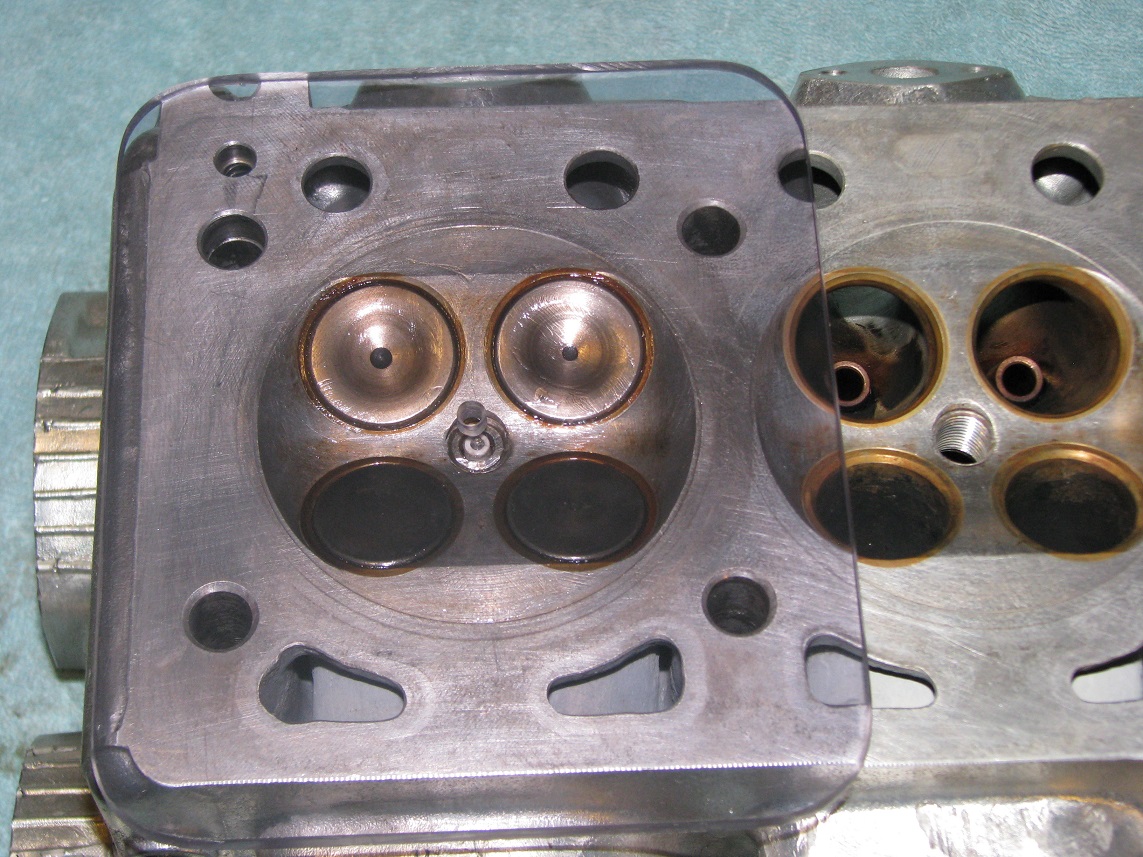

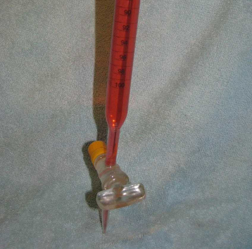

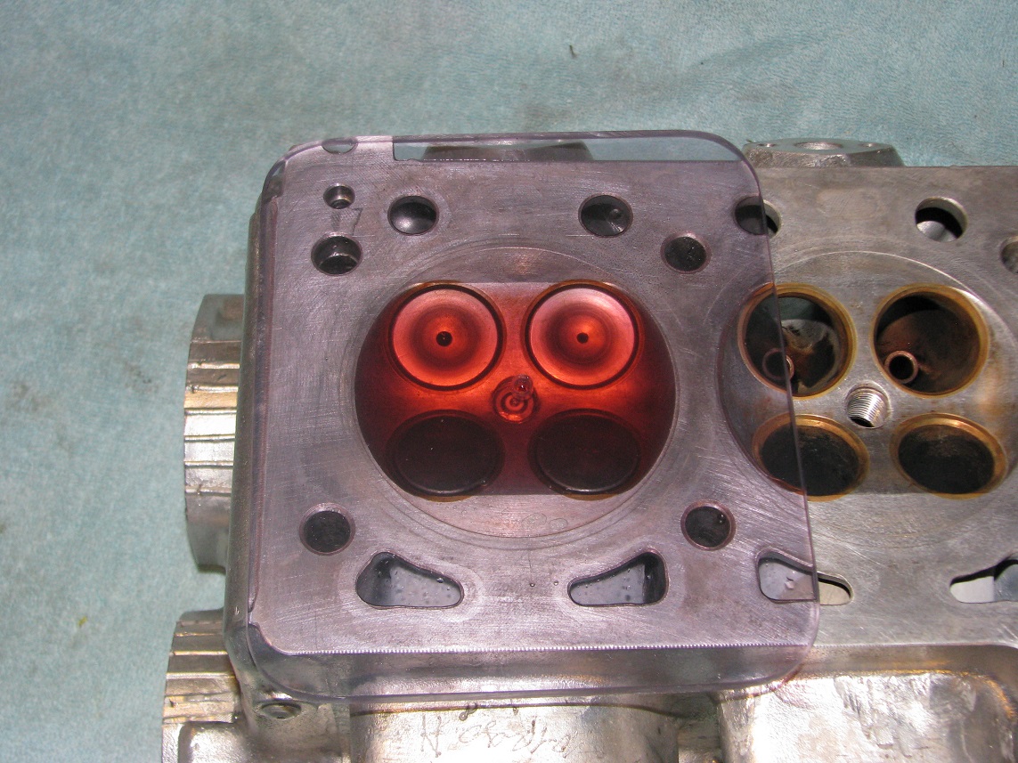

I started with checking my chamber size.
Average across all - 109cc
New parts collected

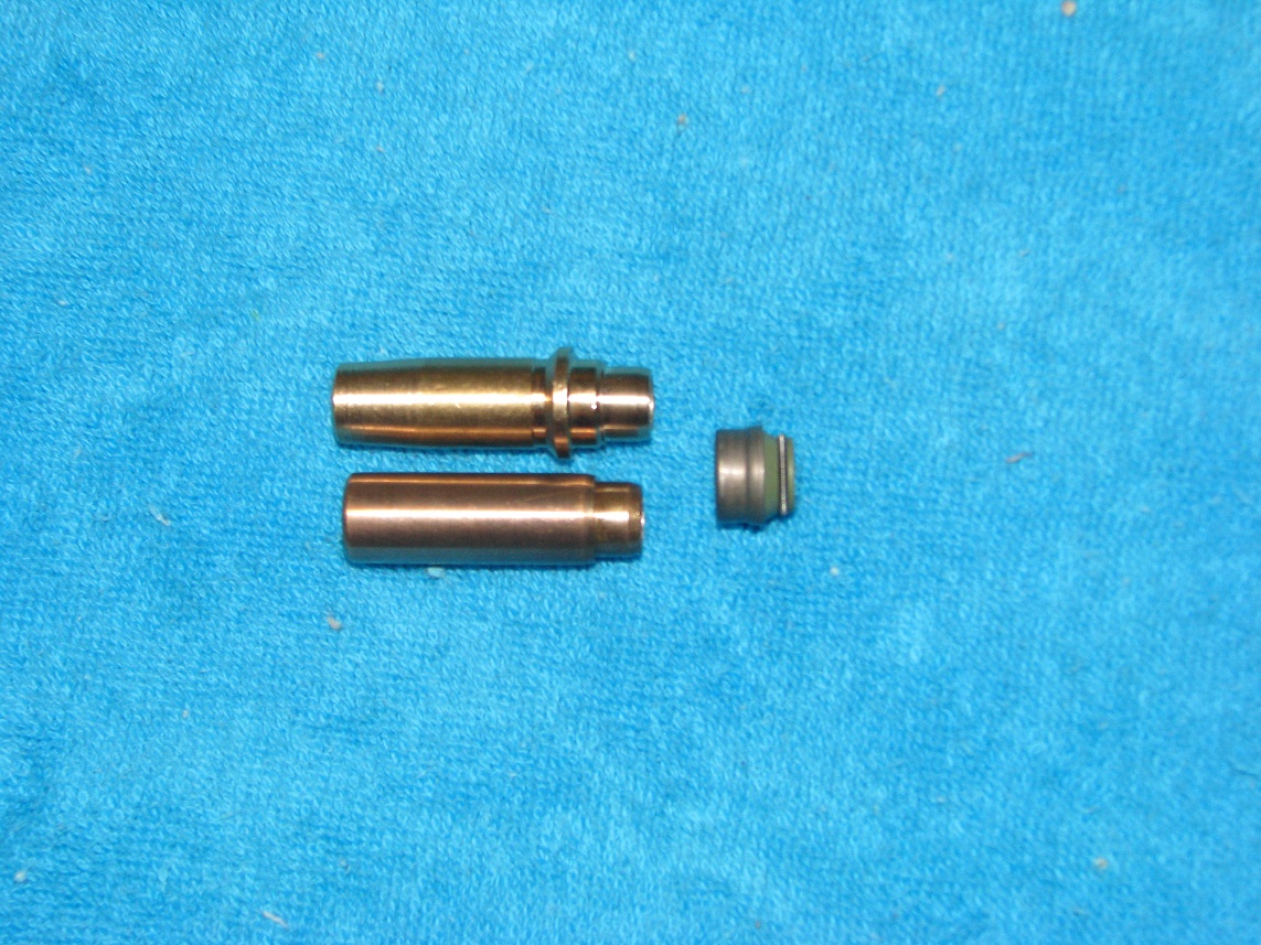

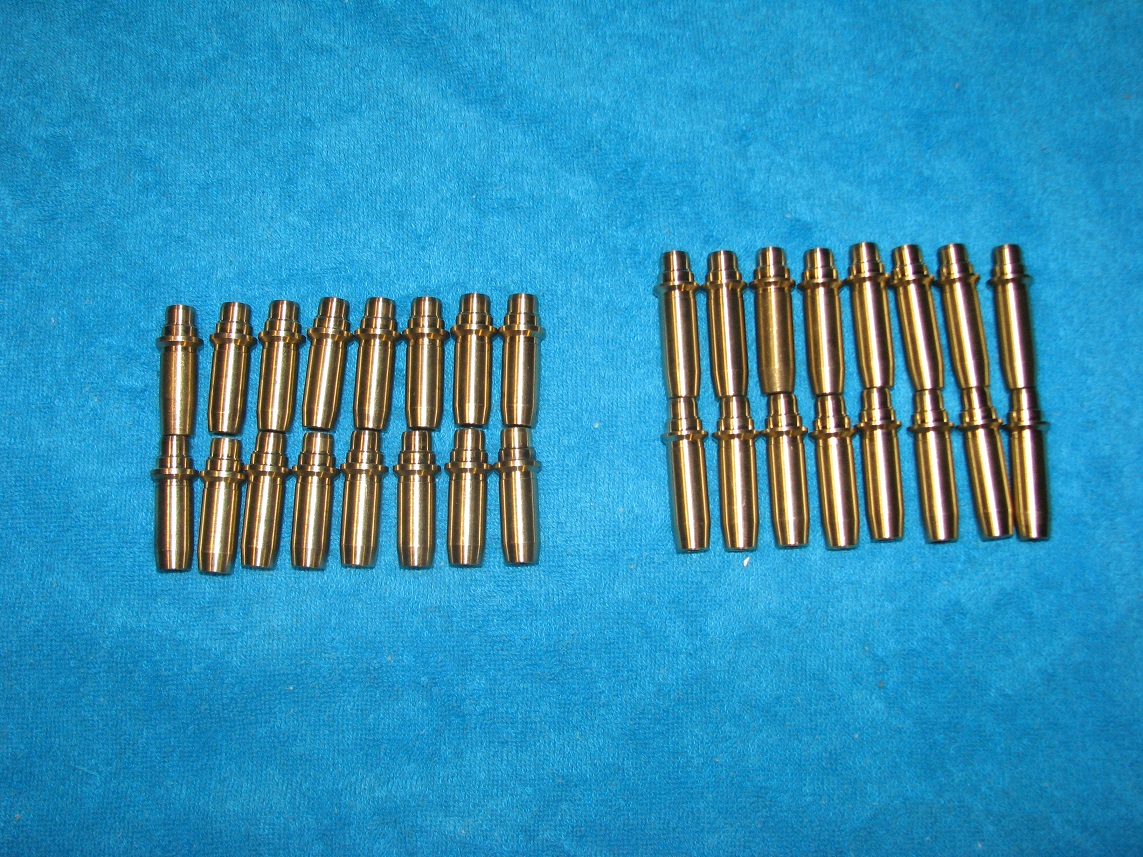

I got the guides from Superformance and then had them modified to use Ducati guide seals. Much cheaper than Ferrari guide seals and I already had a bag of them.

What's the valve stem diameter on those valves?
The stems are 7mm.
I got lucky and SI Valves had the 28.5 exhaust valves as old stock and I got them for $16 each. The 31.5 intakes I could not find and had Ferrea custom make those.
So I'm into the valves for under $1K. Not too bad.

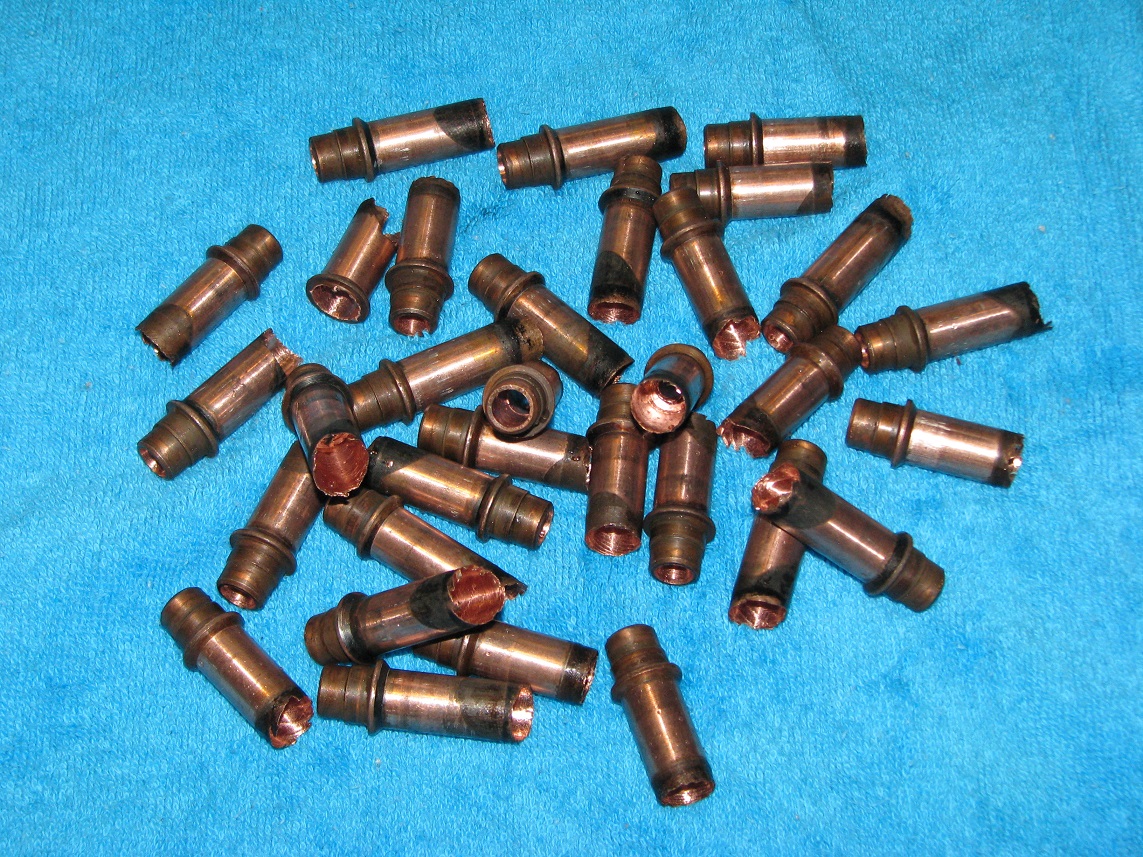

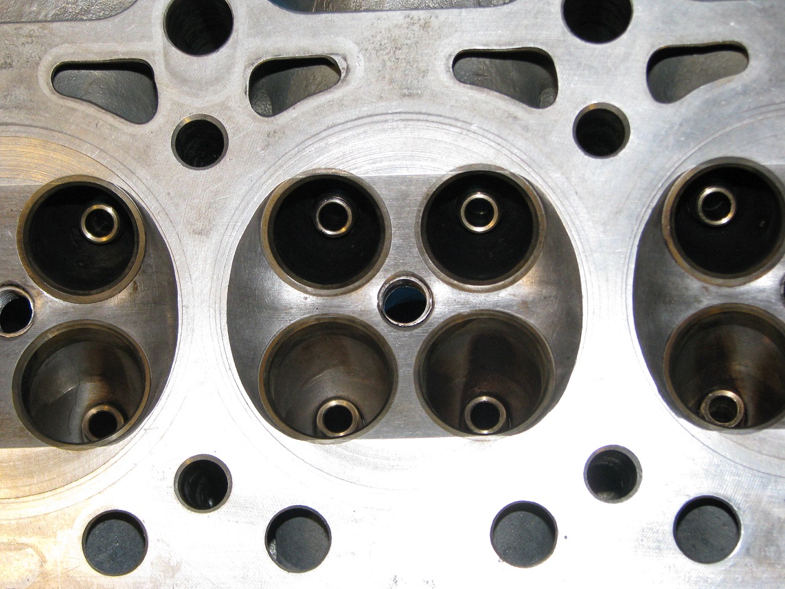

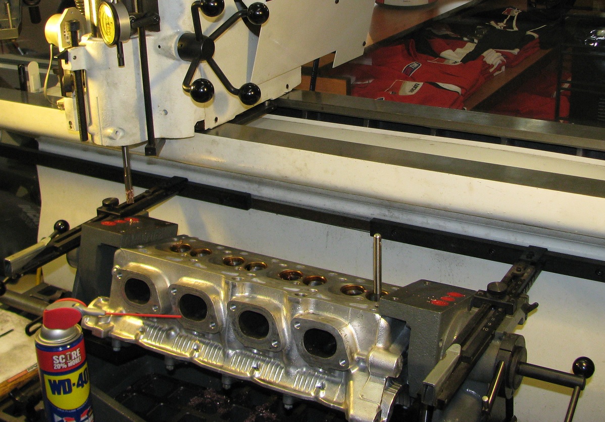

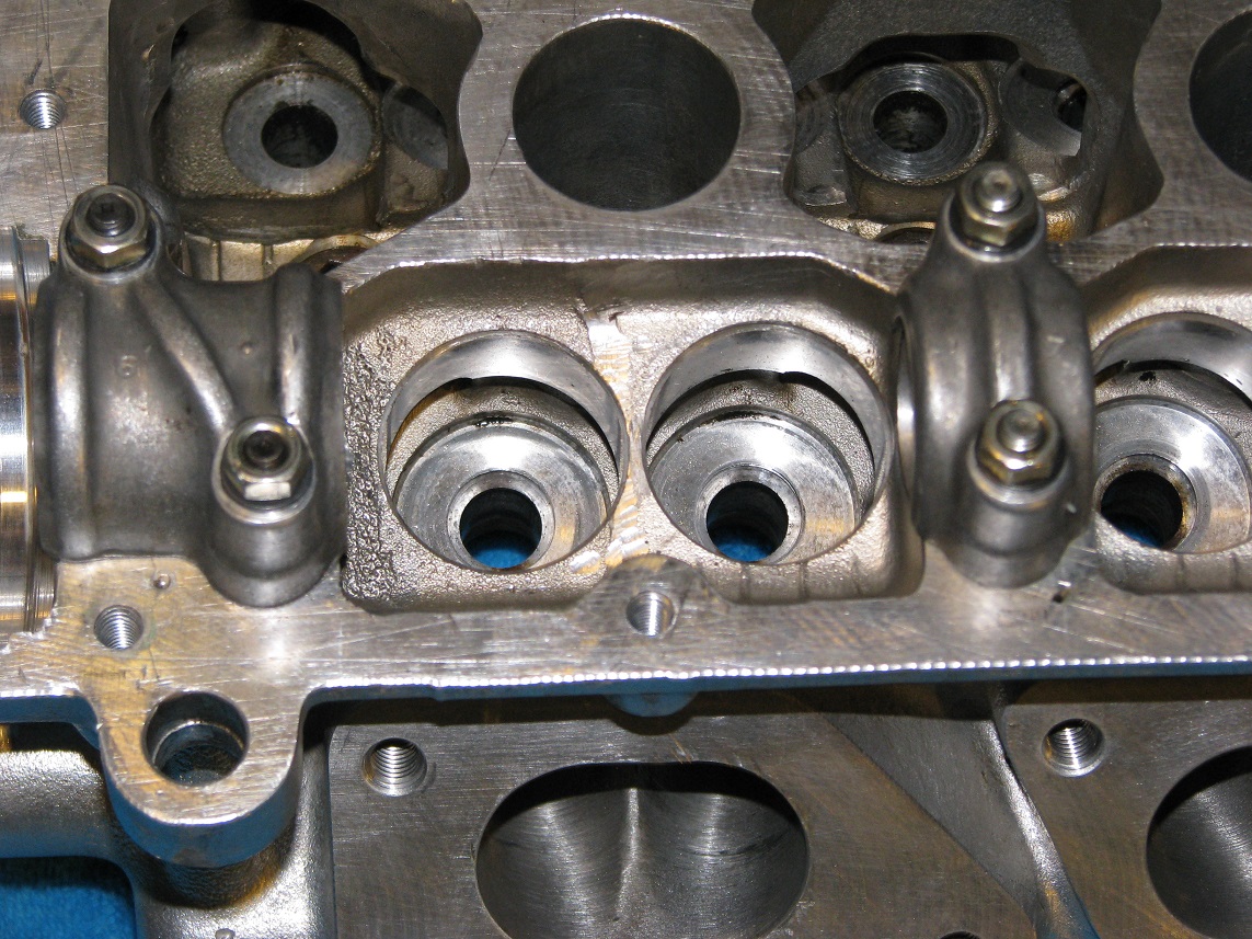

Set the heads up on a Sunnen VGS-20 machine to remove the old guides.
Center on each and use a reamer to shell out the guide. Then they knock out super easy.
No possible damage to the bores and no need for oversize guides.

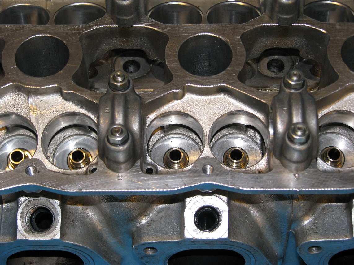

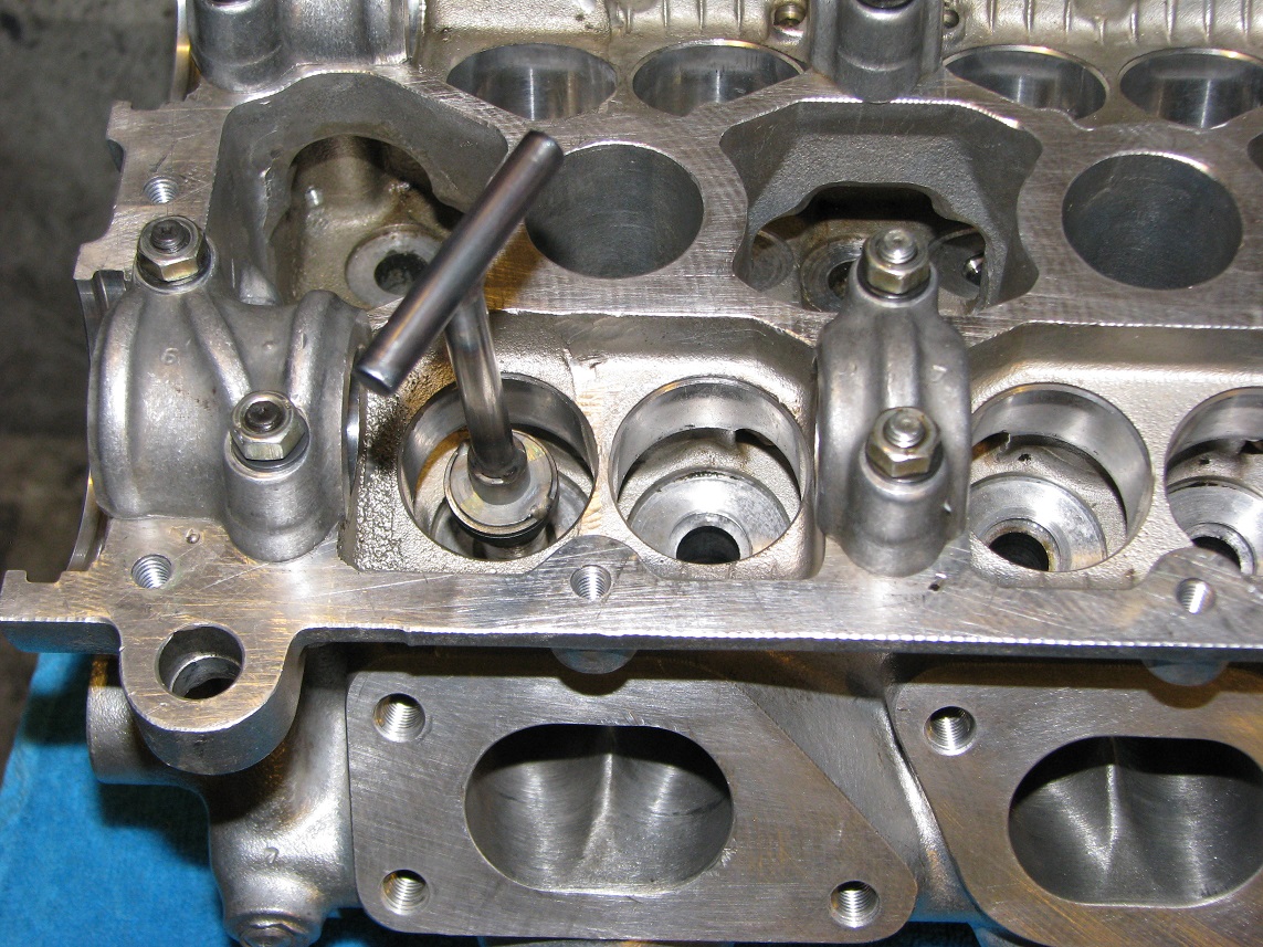

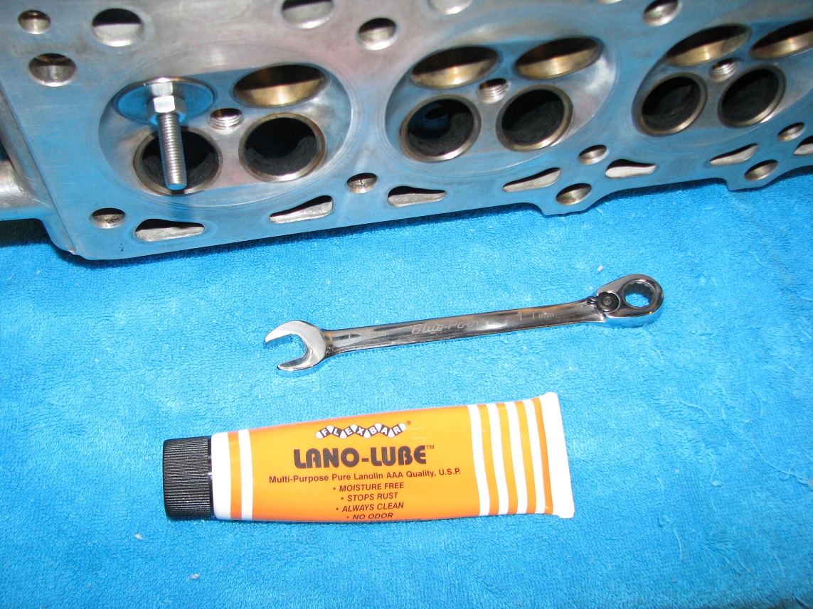

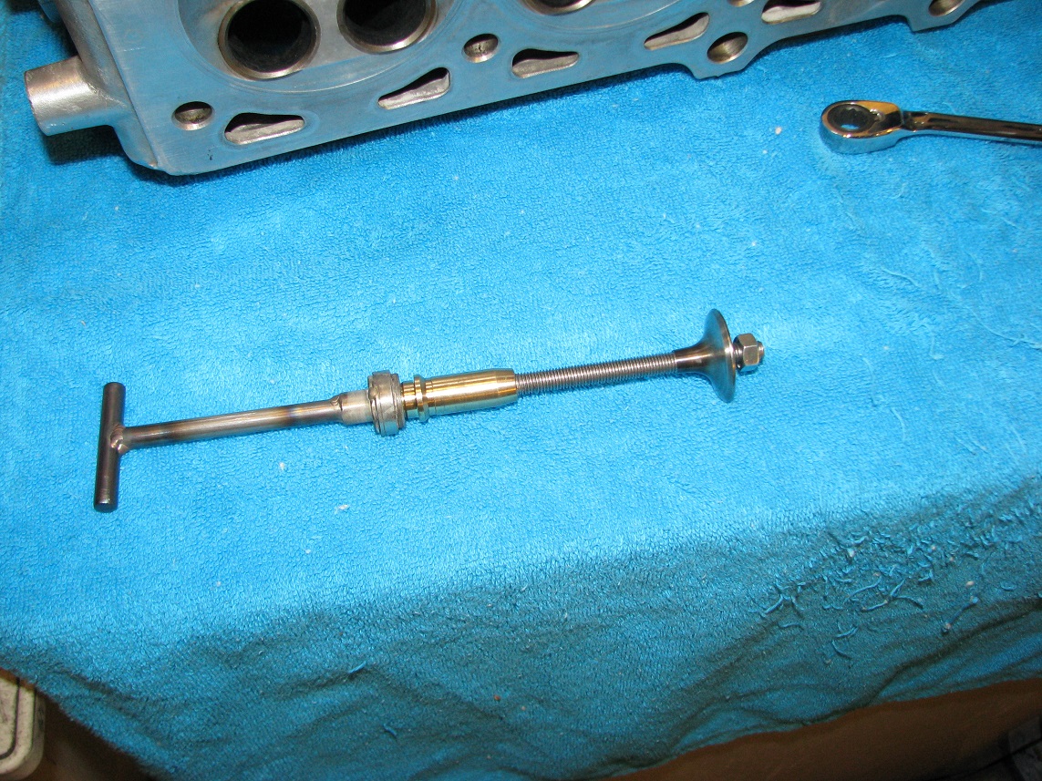

I installed the new guides today.
I don’t like hammering guides in place, so I made a custom tool.
I use a little smear of lanolin on the outside of the guide and they just pull right into place.
No pounding, and nice and straight.
