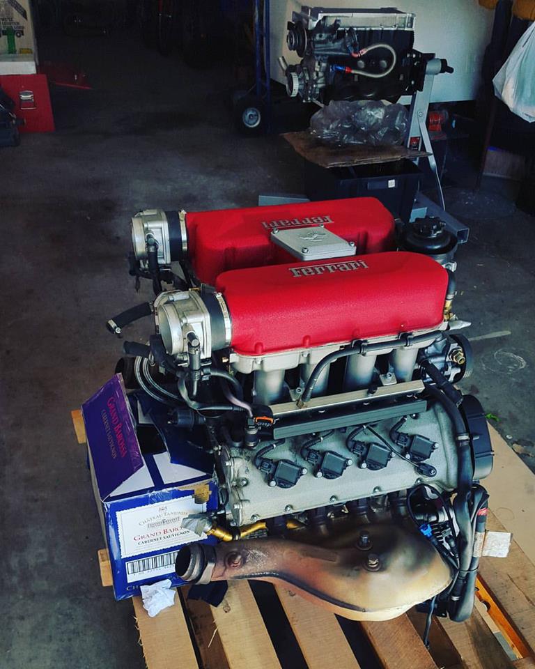

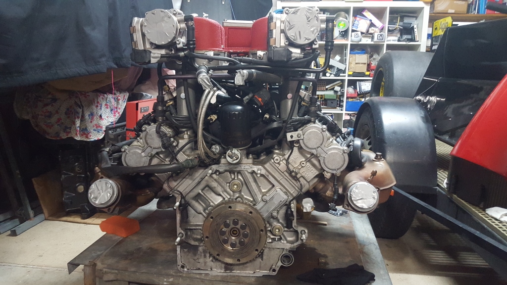

Time to let the cat out of the bag. I have just ordered a new Absolute Pace GT40, and will be powering it with my 3.6ltr Ferrari V8. For those not familiar with the Pace GT40, it features an aluminium chassis and push-rod suspension.

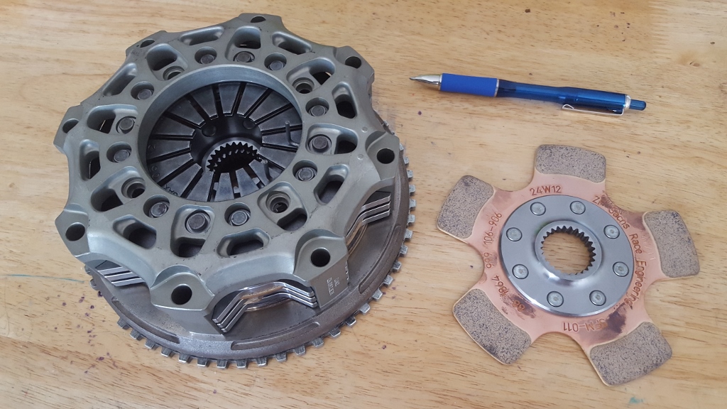

The car will also get a 6 speed sequential transmission, 5.5" triple plate clutch and flywheel from a 458 GT3, and will (at this stage) be running 15" rims and the Gulf-width rear clip. Yes, it'll be red...
More details and specs to come. I've attached some pics to get things started.

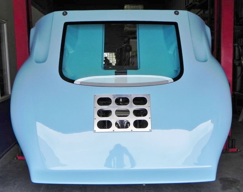

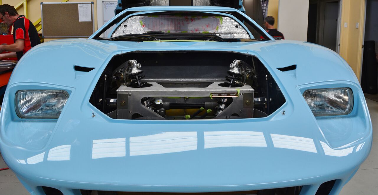

Inboard rocker suspension on another AP GT40 being prepared at the factory. The Gelcoat finish polishes up nicely, me thinks.
Gotta be the best glass finish me thinks. Well done on the new project. Looking forward to watching this thread......

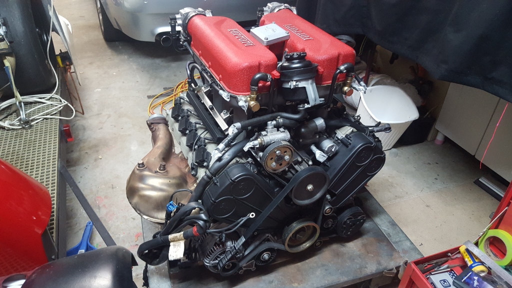

Looks like a 360 motor. What kind of intake are you going to use? (motor is really tall with the stock intake) Do you have any other pics of the bare chassis? (looked on the Pace website, didn't see any) Will be watching with interest, Scott
The motor is a great fit in the chassis - even with the stock intake, which I will use to get it registered. You're right, it's a 360 V8, and is virtually brand new with super-low miles on it.
I have two options once it's all bedded in - either 8 Stack Jenvey arrangement (the trumpets will be very low under the rear clip), or twin turbo. I think a good naturally aspirated, high compression build will give a better sound (no need for cross-over exhausts with a flat-plane crank), even though the TT set up would net another couple hundred HP!
I'll have some photos shortly, of my engine in another chassis under construction. I'll post as soon as I have them. Being an engine from a mid-engine car already, it packages up really well in the frame, and we can get it really low as the crank centreline is already low, thanks to the factory dry sump arrangement.
Dave, another shot of the Glossy Gel Coat for you...

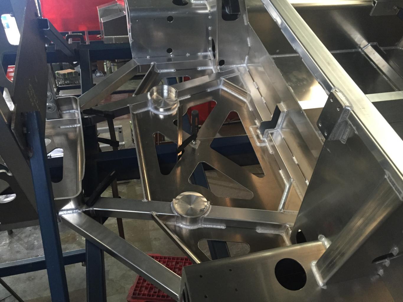

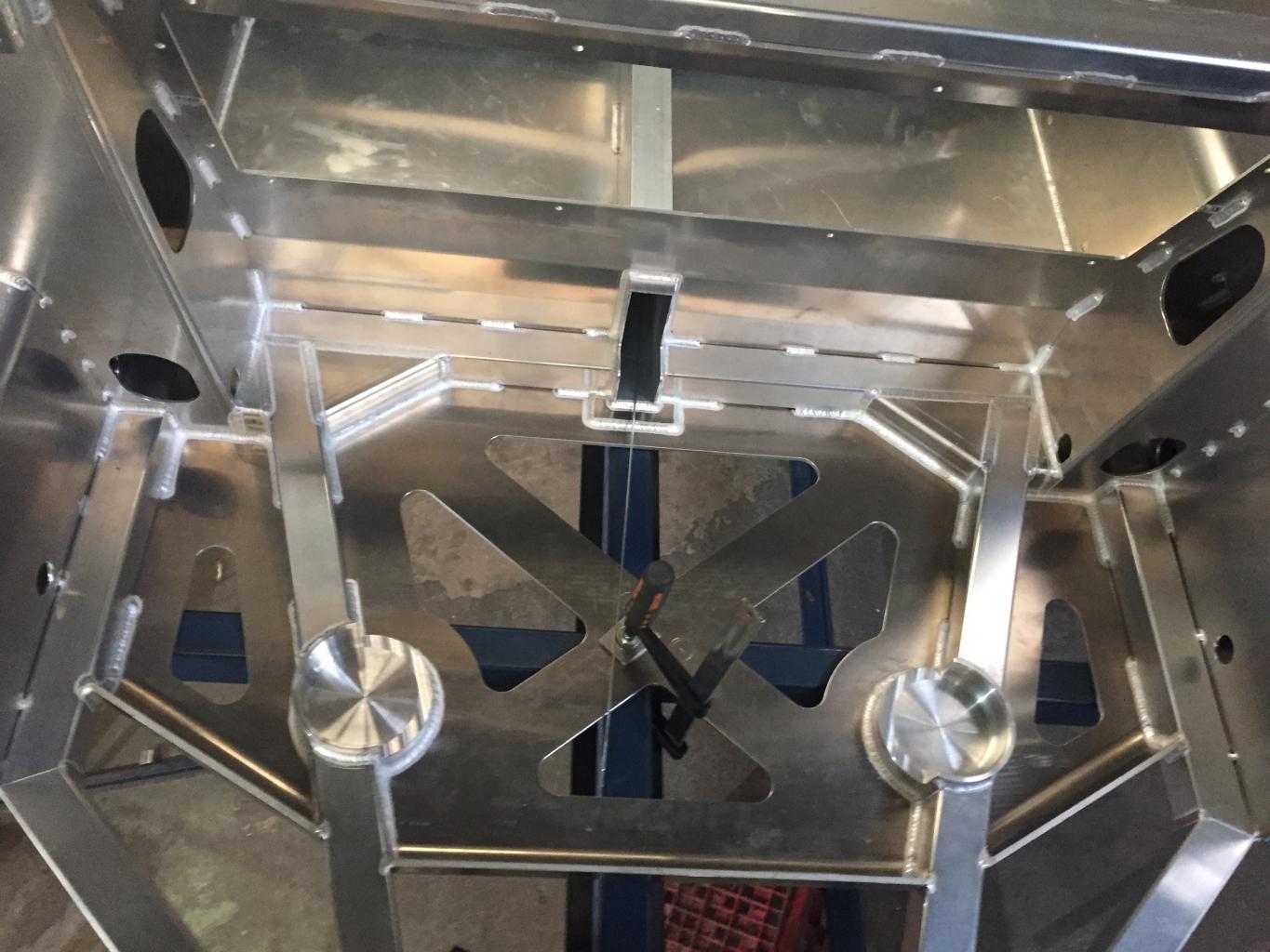

The body and chassis are almost done, and the body detailing has begun. The guys redesigned the engine bay specifically for my drive line. The two round mounts started out as solid billets, being turned down to suit the factory Ferrari engine mounts.
The Pace factory have been onto it, keeping me updated with pics of the progress. More to come soon...
I was going to set it up for both the sequential Elite box, as well as the standard Ferrari 6spd H-Pattern transaxle, but may just stick with the sequential box only. That said, I may have a 6spd H Pattern Ferrari transaxle for sale very soon. It even has the shiny gated shifter and cables!

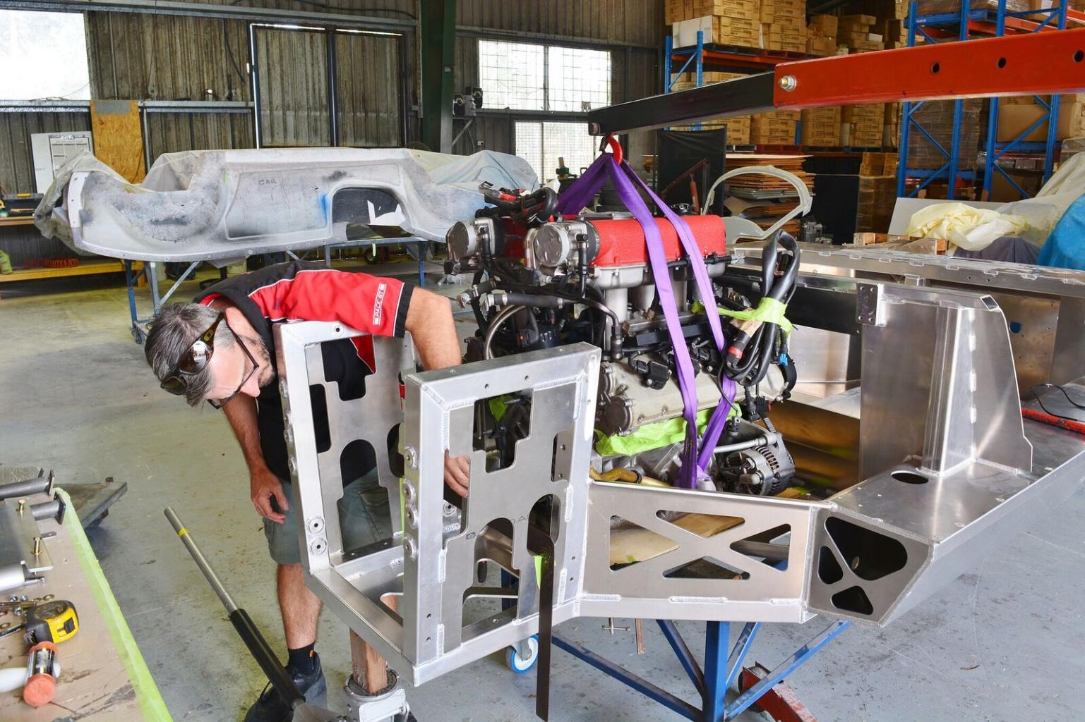

This was the engine being test fitted in a chassis, prior to mine getting started on the jig.
The sequential transmission is now officially underway, and will be done in around 6 weeks. The chassis has been modified to suit the gearbox, and the output flange locations.
