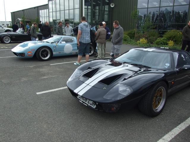

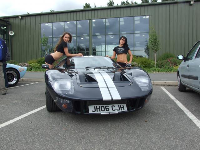

I thought that in the USA there was only a rear number plate required, shows how out of date I am. As for airflow, MDA fitted my number plate at an angle just in front of the rad so that the air actually gets pushed into the rad at a higher flow rate than the car is going. This works really well on mine and I have never had cooling issues. I'm aware that US plates may be a different shape so this may not work, but it might be worth trying something similar rather than risk more tickets.
Note also that from the front the number plate looks OK as if it were totally upright. And yes the second picture does actually contain a car!:laugh:

Thanks for the pictures! I like the second one...

@ Kirby, the way Lucas mounted his plate looks a good option to me.

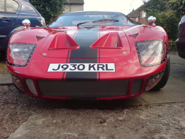

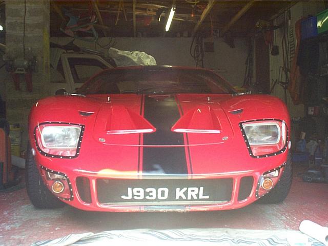

When I got my car, it had a half size number plate, but that still interfered with cooling. After that I painted the numbers on the rad screenmesh, passable and didnt interfere with cooling. Finally I decided that the lesser evil was stick on numbers. May not be technically legal, but are the required size and have a proper reflective background, 2 years and counting, so far so good .

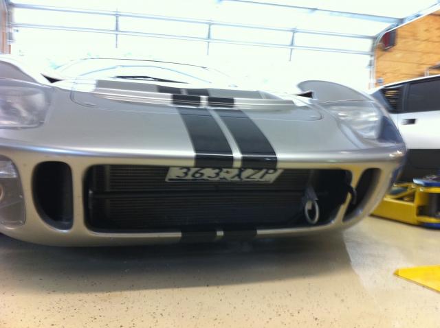

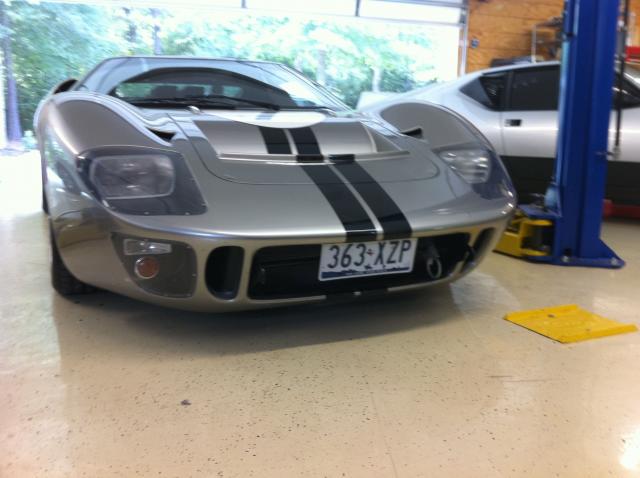

After considerable test fitting and messing around, I came up with this.
I had to drill new holes in the plate, but it is mostly visible when down and swings up out of the way when driving. I tried it out last Sunday when it was 96F outside and no sign of cooling issues.
