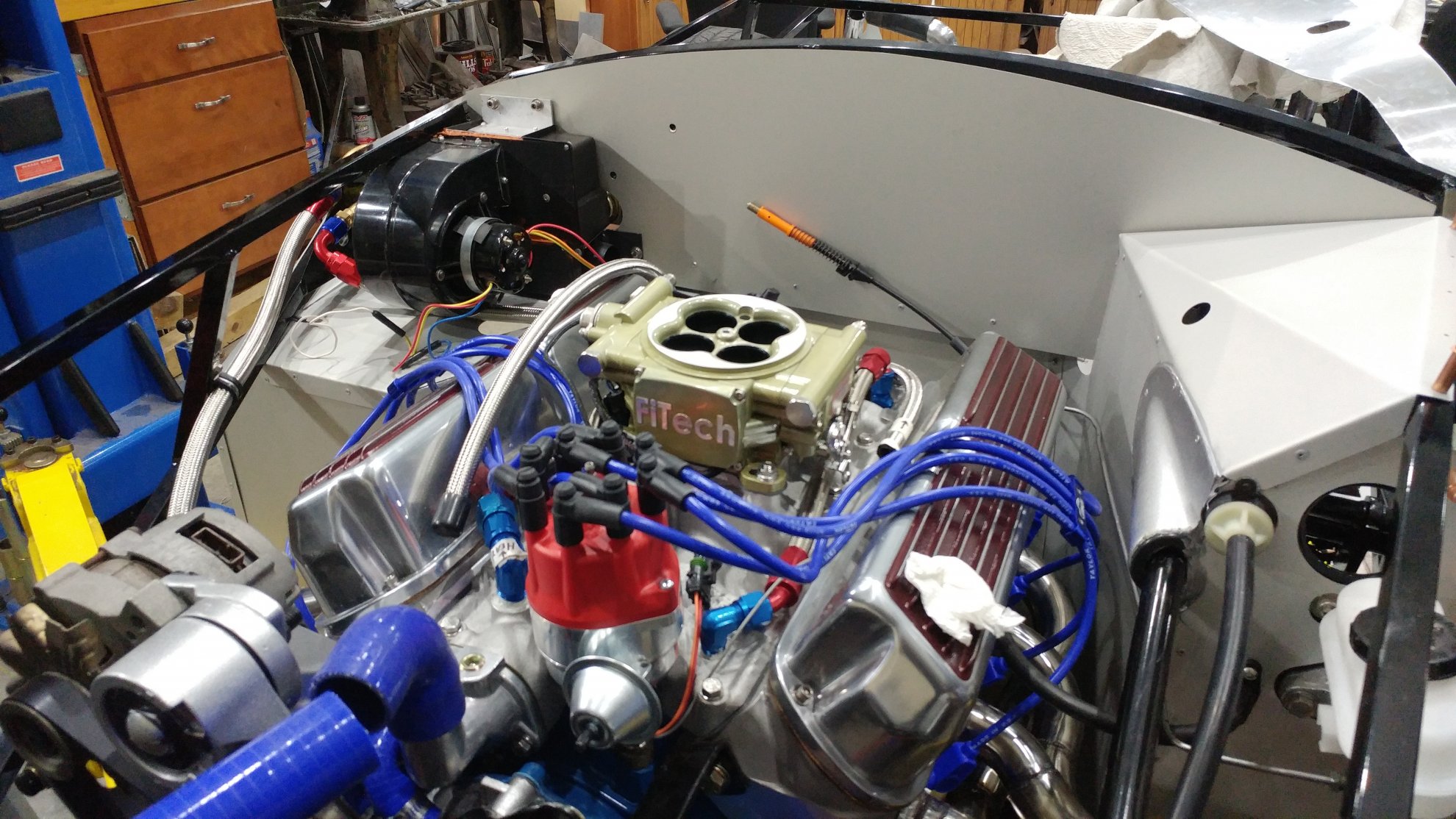

I have first hand experience with exactly what you want to do !! Because I did it and my recommendation is go with the Holley sniper efi system ! I fought with that fitech for a hole summer nothing but problems !!!! Put the snipper unit on and it's been perfect ever sense !

I had the fitech on my cobra and it worked great after i fixed all the bugs. First known problem is the water temp sensor provided does not read properly and will not allow you to get into self learning. Easy replacement with an auto part store replacement. I did not get the fitech to control my ignition timing. Instead I used an MSD programable box and that made things easy. Fitech did the fueling and MSD did the timing.
Another know problem is the prime shot. This squirts some fuel into the throttlebody when you start the car. Instead many of us set this to the lowest setting so it would not be used and instead adjusted cold start based on temperature. there is a great facebook group for fitech
