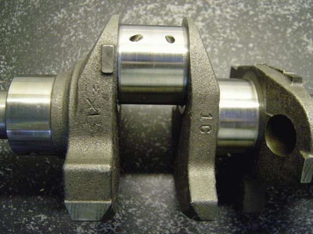

Can you elucidate as to what preparation I need to get done on a new original HiPo crank and bearings for a completely NOS HiPo engine I am building presently ?

The HiPo crank is mint so I will not trust myself as a fresher with the polishing. I am going to an approved FIA shop for that.
