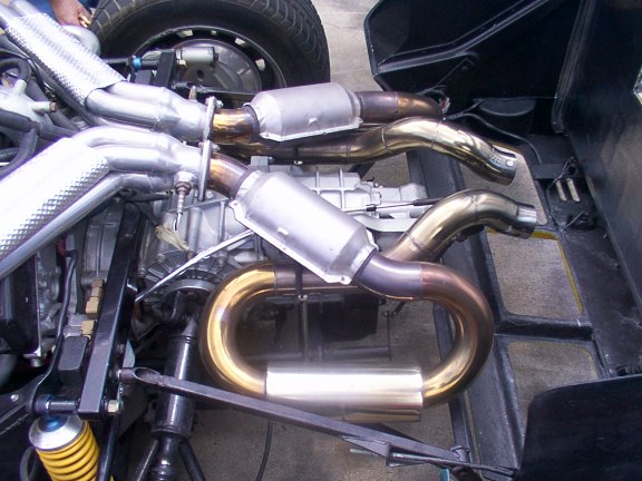

Some have asked whether a 4.6L will fit in a GT40.
Here's a DRB with a 4.6L engine installed.
The primary tubes look like they'll be a bit close to the rear clip. /ubbthreads/images/graemlins/shocked.gif

I bet it sounds great.
Just hope the owner doesn't suffer from windage/oiling problems, exploding cam sprockets, chain over-tensioning, or any other afflictions of the DOHC 4.6.

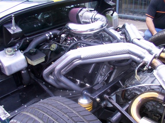

Is that the power steering reservoir I see in the picture?
Does this car have PS or is the pump used for some other purpose?
Inquiring (OK, simple) minds want to know!
Rick /ubbthreads/images/graemlins/confused.gif
