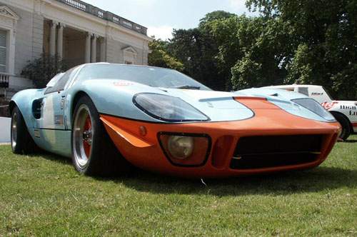

maybe those pics help:

Maybe I'm not seeing things clearly or missing the perspective, but I don't see any difference in the pictures posted above. I always thought only ther rear was wider in an attempt to address oversteer.

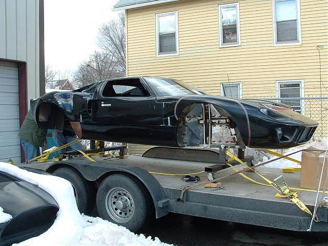

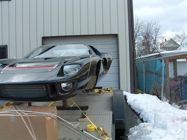

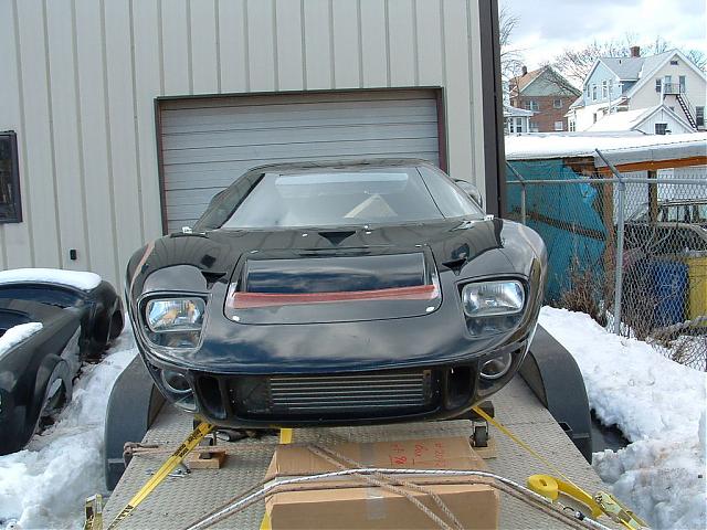

The fronts are flared on my ERA. These are a couple of pictures taken when I picked the car up and one after body work and painting was complete. You can clearly see the red colored glass where the wider flares were added.
Dave

Im more concerned about the total lack of respect being shown to the Cobra body, must be trying to slow the resin cure rate!
I live about 30 minutes from ERA and am always amazed at, well, how plain the operation is. I mean no disrespect, but I guess I expected some flashy building from an outfit that builds high quality cars. But no, there are bodys and bits of chassis all over the place and the GT40 building...well it is a junky building in town, but what is inside is very impressive!
