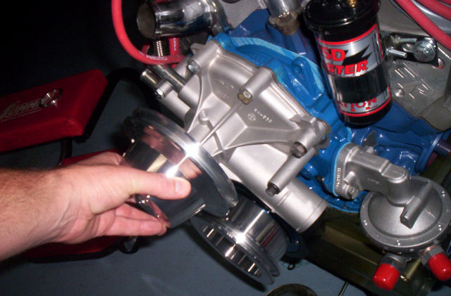

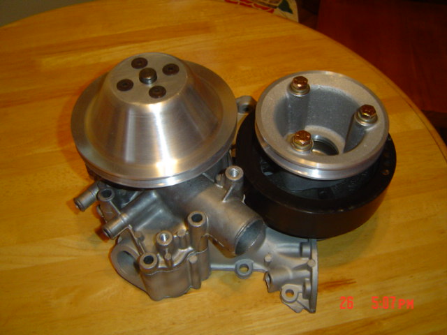

I ended up turning down a spacer for mine - about 0.590" to get it all lined up right, but, making the spacer was simple and far less time consuming than doing a new crank and water pump pulley. There are so many variations of front cover, pump, damper, and pulley sets for a SB Ford it isn't even funny. That is one area that I think the SB Chevy motor had a distinct advantage - front dress. I've not worked on a lot of SB Chevys but the few I have worked on seemed to be the same, although spread apart in years and application. Heck, the SB Ford has changes in mid-year for the same application sometimes.
There definitely is a market for someone to produce a timing cover, with provision for fuel pump, that uses a reverse rotation pump, short style, and couple it with a off the shelf pulley set and spacer with a commonly available alternator and sell it as a set. I don't know how many times I've played this game with a SB Ford, this is just the first time with a old style cover.

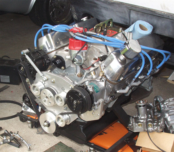

I know this is an old thread, but I was messing about a bit on the WWW and ran across this company, which claims to make pretty complete front dress systems for long or short pump SBF motors with just an alternator, an alternator and an A/C compressor, an alternator and a power steering pump, or an alternator and power steering pump and A/C compressor. The ones for A/C are kind of costly, but the price does include an ultra small polished Sanden A/C compressor with hard lines. Here's a link in case anyone else runs up against this problem: Small Block Ford Kits
Doug
Here is the rub though, their quote:
"Short waterpump (SFM) kits are designed to work on Ford 289/302(5.0)/351 engines using the FRPP waterpump and timing cover (part# M-8501-A50), and FRPP balancer (part# M-6316-K351 or M-6316-M50). Works with electric fuel pump only."
So, if you want to use a short water pump and use the cover with a mechnical fuel pump, as I did, you'll be machining a spacer for yourself.
