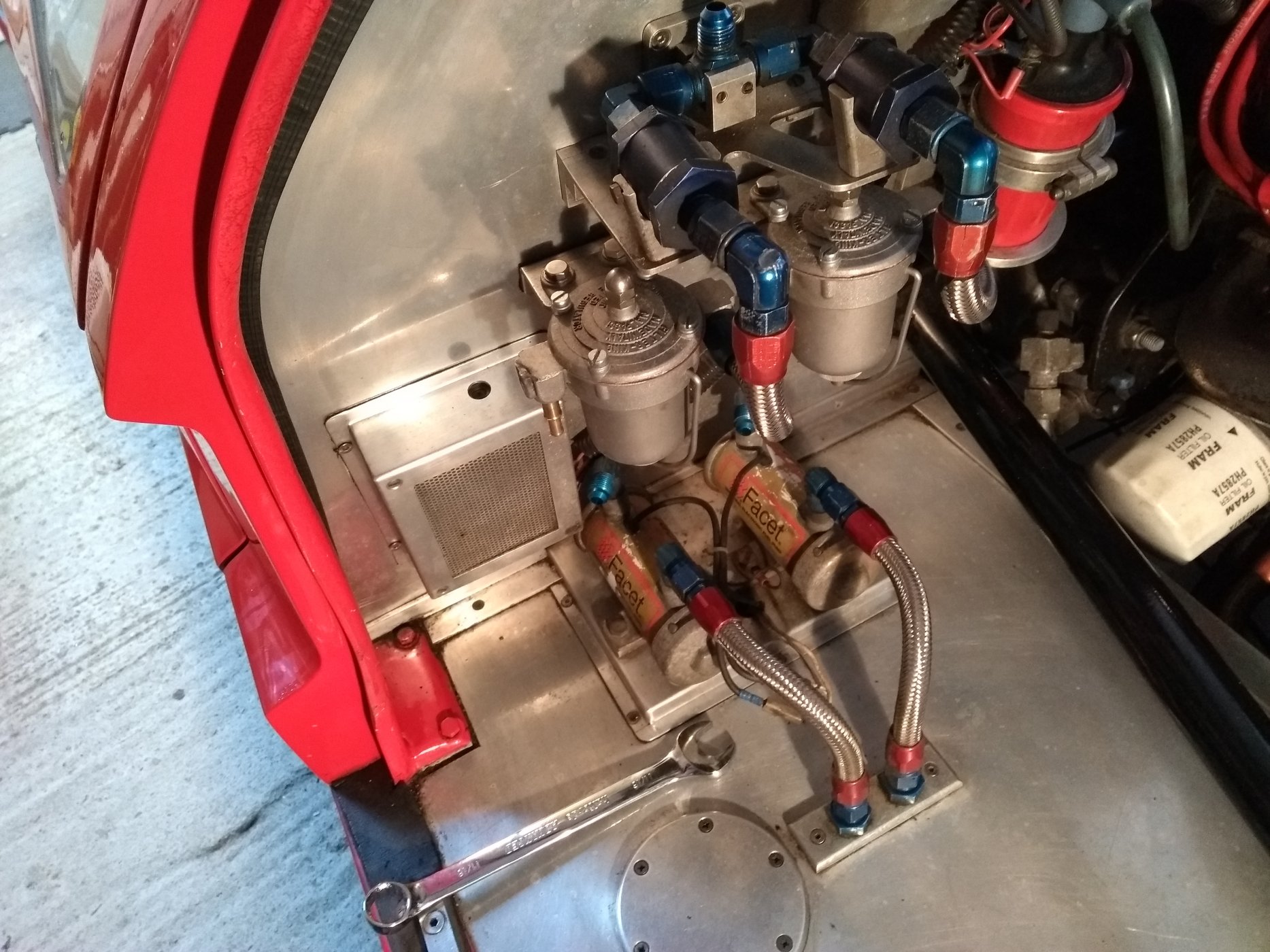

There are two. See pic.
Pump from tank A running - prevents fuel going back through into tank B
Pump from tank B running - prevents fuel going back through into tank A
GTDs have a switch on the dashboard for left pump, right pump and centre OFF.

The fuel line of my gtd40 is connected from two fuel pumps to a three-pronged triangle, through one filter and to the carburetor.
I'm scared because it smells like gasoline because it is connected with a rubber hose. I want to know the correct connection method.

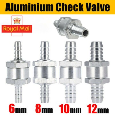

Best thing would be to fit the non return valves, they do not cost much And it will give you piece of mind And if every you replace the pump you know you are safe.

Could you tell us a little more about the petrol line? Please tell me about fuel pumps, check valves, filters, etc. My GTD is backflowing.

I would use something like these
for the non return valve
and for filters
both are available with push on fittings or arroquip connections.
