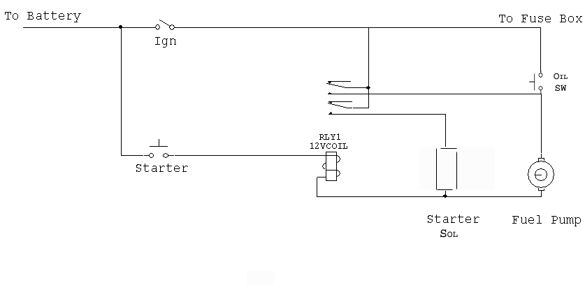

I don’t know how your ignition/starter switch is wired, but you can energize the fuel pump relay, bypassing the oil switch, from a connection to the starter switch or button. The relay isolates the starter solenoid from the fuel pump.
John
