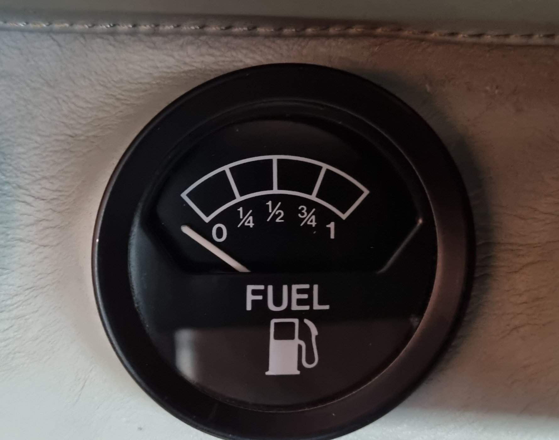

Hi Eddie this is the fuel gauge not much to go by

Ed McClements
Looks like a Smiths "GT40 style" gauge, and would require a 20-220 ohms (or thereabouts) sender:-
Though it might be the voltage regulator which has failed, and these are often wired to provide the necessary 10V feed for fuel gauge and oil temp / water temp gauges (all three of these require 10V to read correctly).
