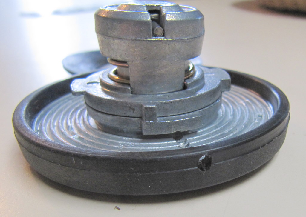

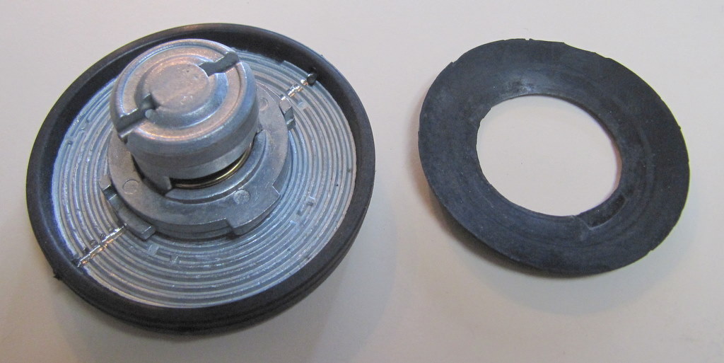

For those of our readers that don't have an SPF GT40 this is what the bottom of the locking gas caps looks like with the rubber seal removed. As you can see I just bypassed the maze by drilling a vent path thus bypassing the whole maze issue. I of course lost one of my caps and I'm now using non locking type which I'm not sure how they are vented.
I've had a gas smell in the car since the the first day I put gas in it.

Richard,
That is what my caps now look like as well where the maze has been drilled out.

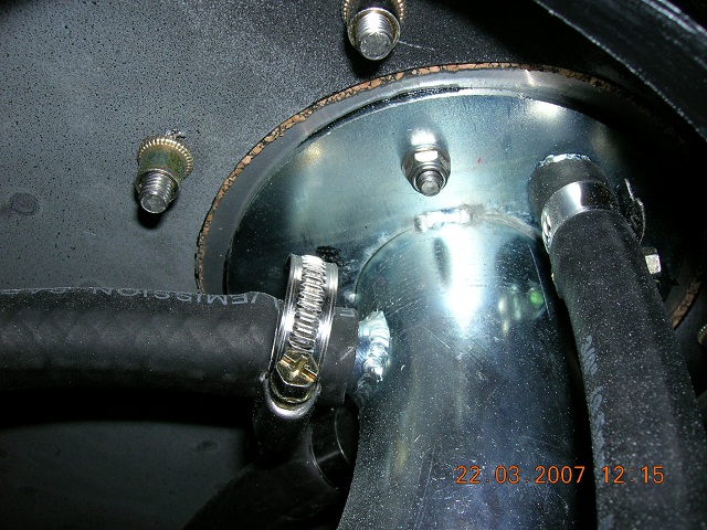

I just found another reason why one car might have this problem and not the others. P2160 has two tiny leaks. The first is where the welder of the tank assembly missed a spot in joining the rear face of the tank to the main body. The other is in one of the spot welds for the internal baffles. So I guess the tank was not pressure tested even though it has about six feet of welding on it all of which has to be air-tight. The tanks have the builder's initials and the date written in black. Hey, HJP, how's it goin'? You forget anything when you built my tanks on March 20, 2007?
Anyway, this might sound like something really difficult to fix, but tank removal actually isn't that hard; it's just a lot of steps. Here they are:
  1. Have a fire extinguisher nearby! Open the garage door! Drain the tank!
  2. Jack up the rear of the car to get the remaining fuel to collect at the front.
  3. Open the rear cavity and disconnect the crossover, feed and return (if any) lines to the tank. Cap these fittings (two 8AN, one 12AN). Or the right size neoprene plugs if you're careful. 12AN = #1 plug.
  4. Remove the two socket head screws holding the tank bracket to the frame.
  5. Remove the access plate on the door threshold (whole bunch of screws) and removed the fuel sender (5 screws). Don't need to disconnect wires, just set it aside.
  6. Jack up front just enough to remove the front wheel, and do so.
  7. Remove the access plate at the front of the sponson (whole bunch of sheet metal screws).
  8. Remove the two socket head screws holding the tank bracket to the frame.
  9. Disconnect two clamped vent hoses from front of tank.
  10. Disconnect fuel filler from top of body (six or so screws, a couple thick cork gaskets)
  11. Unclamp and loosen fuel filler hose from neck on tank and pull entire fuel filler assembly up from the top allowing the hose to come off the tank's neck. The tank is now free to slide out of the sponson. However, the front upright and brake are in the way, so you need to move them temporarily.
  12. Detach upper ball joint from upright by removing large hex socket screw at the top, holding nut underneath with a short open end wrench. Be sure to catch washer underneath when nut comes off; otherwise it can fall into the upright.
    Loosen nut at the top of lower ball joint a few turns with short open-end wrench.
  13. Raise upright a little with a padded jack under the axle.
  14. Tap the lower A-arm until it and lower ball joint drop down from the upright.
  15. Remove nut so ball joint shaft can drop all the way out of upright. The upright, axle and brake assembly is now free and can be set aside (forward), being careful not to strain the still-connected brake line and tie-rod end.
  16. Unscrew the cap beneath the lower ball joint. It has a raised hex boss. It will be full of grease that you don’t want to contaminate so set it aside appropriately. This is a good time to drill and tap the center of that hex boss for a grease fitting.
  17. Tap the threaded end of the ball joint downward through the lower A-arm and set it aside as with the cap. Protect the grease-filled end of the lower A-arm from contamination and damage to the rubber boot. If the rubber boot is cracked now would be a good time to replace it.
  18. The fuel tank can now be slid forward out of the sponson while the upright assembly is held above the tank.
  19. I fixed my leaks with some carefully applied JB Weld.
  20. As with all British cars, assembly is purported to be the reverse of disassembly. In this case it actually is.
