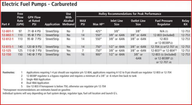

I also ran an oil filled pressure gauge on the end or the fuel rail to tell us what was goiung on during the race. - you may find this handy while tuning on the dyno.

Recomendations from Holley

The chart plainly shows that 36 gph for 48 IDA's are just too light. I'll look closer to the 110 gpm as mentioned above and continue to study out the best way to fix this problem. I like the idea of the high volume with the return, however will take alot more work to fix. ( running fuel lines back to the tanks, solenoids, etc...)
