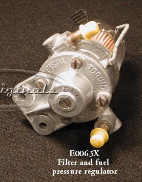

one FISPA filter/regulator (from an alfa or fiat, not original to GT40) see attached picture
I figure that my motor will probably need half inch fuel lines (-8 an). I would guess that the SW 240as working together can supply enough volume, but I just don't see any way that the little FISPA filter/regulator is going to flow enough by itself (I'd guess, from memory, that the inlet/outlet has an ID of about 1/4 to 5/16 inch).
I'll need a regulator with the webers, should I just give up on my hopes to keep things original looking by using the FISPA, or could I try to find another one and run them in tandem?
I've thought about trying to hog-out the inlet/outlet, but I just don't think I can improve the flow enough to solve my problem. Secondly, I don't know how that would affect the regulator function of the unit.

I was planning on running the two pumps in series (they each have integral filters), followed by one (or two in parallel) FISPA filter-regulators. I've measured these, and the id of the inlet/outlet is about a quarter of an inch (-4 an). I think we call all agree, that would be too small. I understand that the Gt40 version of the FISPA has larger inlets, but I don't know how much larger.
I'll probably temporarialy run a modern filter and regulator, and then see what happens with the FISPAs after I get done cleaning them up.
