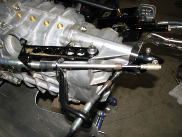

In that thread I saw several brackets for mounting the shifter cables to the nose of the transaxle, and one in particular that looked like it would work for me. I've attached the photo of it below (I hope: first try at attaching a photo), with thanks to the original poster. Could someone please tell me where I could find such an animal? Many thanks!

Brandwood is the maker of the original brackets and levers. I had to make my own lever and Shift bracket to make the combination work with my shortened G50/03.
Here's there website;
Cable-Shift - Home
Good luck on getting them to respond to emails or answer the phone. They would do neither for me which is why I spent weeks doing their work over again..

You may be far past this point, but I thought I'd mention: it appears that if you'd heat and remove some of the existing bend from the bracket just next to the point where the cable attaches (forgotten what the cables are called, but the one that turns the shaft, not the one that slides the shaft in/out of the casing), it would take some of the kink out of that cable.

If you notice - I made no changes at all to the actual brackets and components supplied by CableShift / RCR. I did this on purpose in the hopes that CableShift might supply the correct brackets / lever that would work properly with my transmission.
On the bracket - The side pull cable handles the neutral gate.
If you look at the picture below, you'll see another part of that bracket (right under the cable) that goes to the other side of the transmission. I can't really bent the mount for the side-pull cable without cutting off this crossover part of the bracket and then extending it. So what I plan on doing is to cut a pair of opposing wedges to mount the cable to this bracket. The wedges (one on each side of the bracket) will aim the cable further to the rear.
