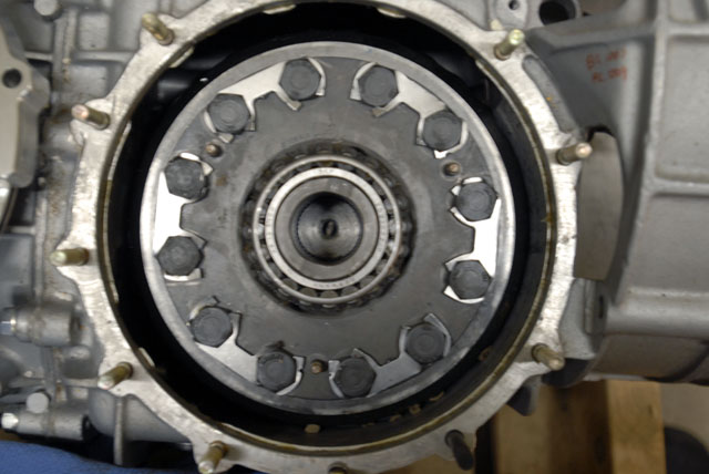

That sounds more likely Pete, now if we could just get someone to take a pic of the G50 & G52 with the side covers off it would be clear to everyone, I would like to see a dimensioned factory drawing/blueprint just to clear up a couple of other things people keep asking about as well, found one of the 930 ages ago but never saved it, wont make that mistake again!!

'89 G50.50, LSD with and without CMS billet side plate:
