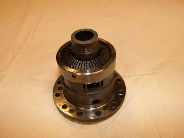

I do not know how to grade the LSD for condition, From what I was told it came out of a 1990 G50 with 36K miles (can not confirm the miles). I pulled the trigger and bought the trans today but I would prefer the open diff. Make me an offer. Here is a photo.

Why do you want an open diff? in a 1990 trans the way to go is the LSD
I am in Massachusetts, I had an open diff from/with my last project and it worked fine. I have no need for the LSD and quite simply if I can sell it to offset the cost of the trans I will. If not I will use it.
Well, you'd have no satisfaction from that particular LSD. It may physically fit the G50/03, but it's originally from an '89-'91 964 AWD, with the lock-up externally controlled by a rod through the 964's cover plate.
Yes the 4wd LSD is controlled by a push rod mechanism that controls the lockup of the differential. It will not work correctly in a 2wd application.

Now that I know what this LSD is, I guess now the question is...is there any $$ value to this type of LSD?
And what other boxes will this fit/work with?
Any idea what this LSD is worth, if anything??

Myself - I can't use it as it's for the all wheel drive cars..
