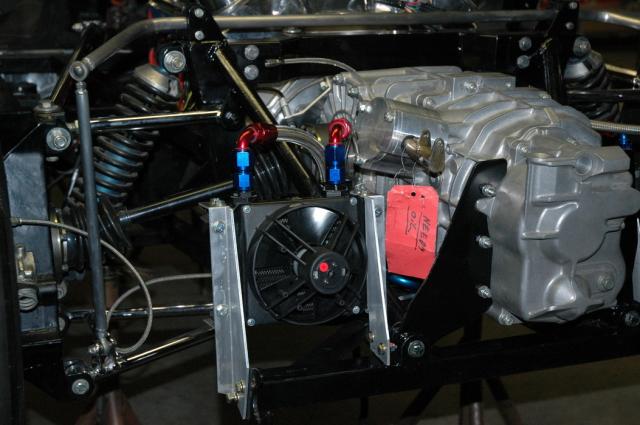

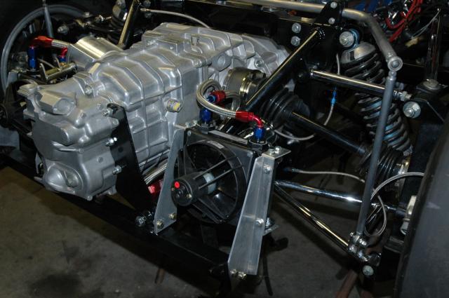

Fred,
I had a similar concern when fabricating my G50 install. I inquired with my trans builder at California Motor Sports (CMS) and he had no real concern whether I mounted mine solid or not and approved the mounts as shown below.
Wouldn't issue be only if one was to use a non-solid motor mount with a solid trans mount. The motor would want to "walk" while the trans would not there fore putting unwanted stress on the mounting points. If the two were to be mounted with solid mounts than outside of increased vibration transfer to other parts of the chasis there shouldn't be a problem (in theory that is).
