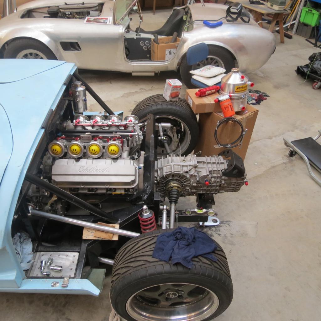

Hi Mark,
I think you maybe thinking of the G96/50 this box has the same bolt pattern as the G50 box's and is also six speed but are only four wheel drive so you would need to modify to convert to two wheel drive which isn't to hard to do.

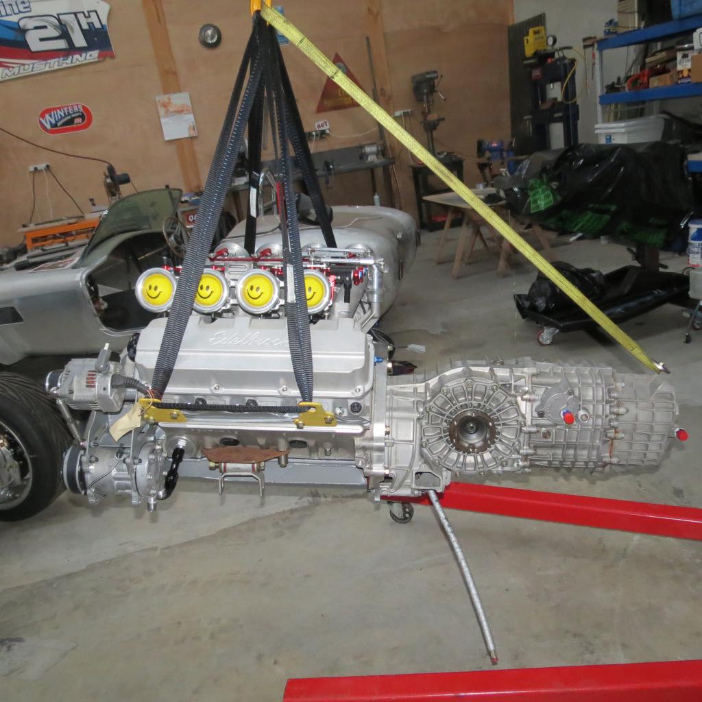

Hi Mark
I have a G96/96 in my GT it is longer but just fits with a 427 Fontana block in front of it. its the same bolt pattern as all G50's If your interested I can give you some measurements.
