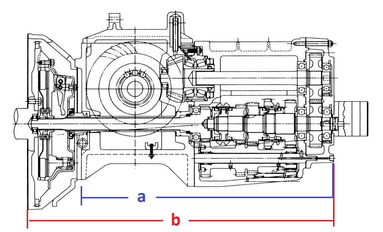

Have a look at the t44, it is essentially a 4spd toploader gearset with a custom input shaft, quick change gears in the back and a shaft forward to the diff... Which is similar sized to a 9 inch unit. They are available but at a cost.

T-44's are not available unless you know someone whom will sell you one they already own. You may be able to scrounge together the internals to build one IF you already have the Magnesium case that is usable. Chance of success, .001%. They are all owned by somebody and not for sale generally.
I have one that I race in my MKIIA and have done some partial overhaul of it. It was rebuilt/blueprinted 15 years ago at a cost of 36K. Should one magically appear and be ready to run, no less than 75-100K today. IMO.

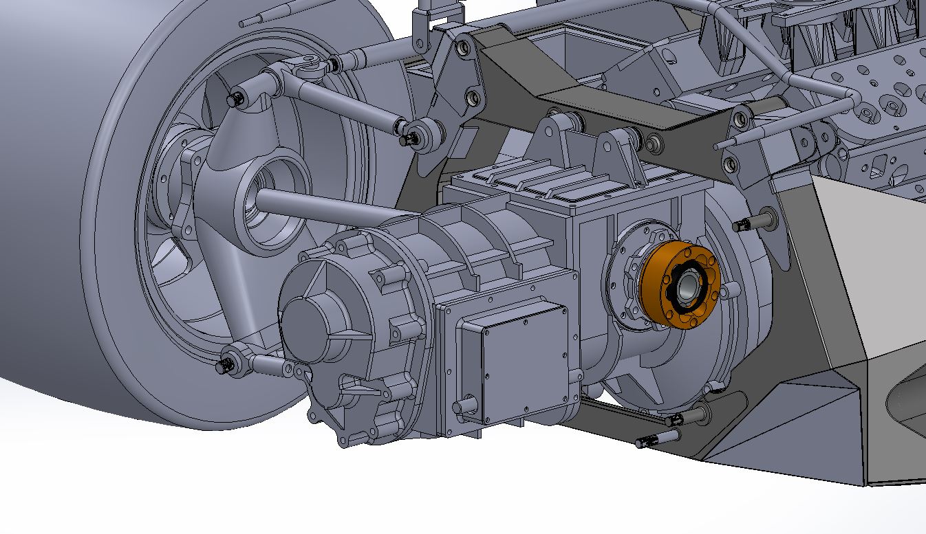

I have sketched a bit on one aswell, basically a whole gearbox rearranged to get the diff on top. Time will tell if it ever gets materialized.
