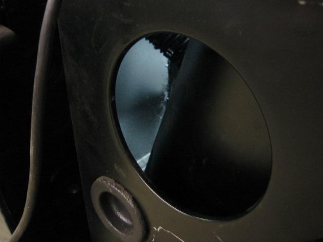

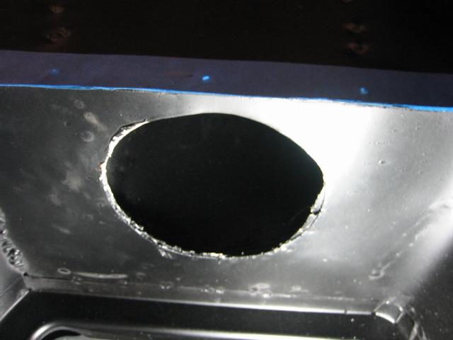

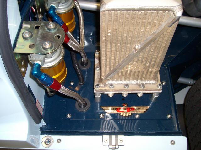

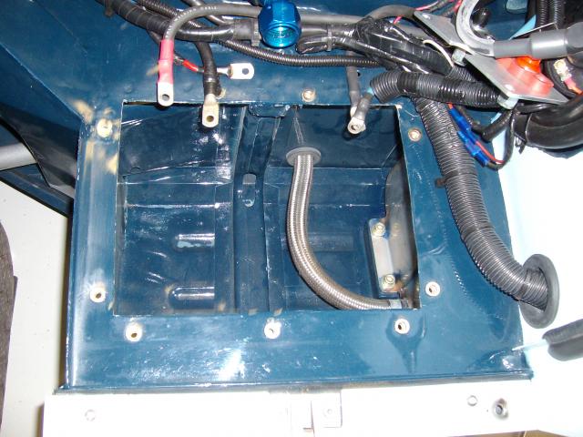

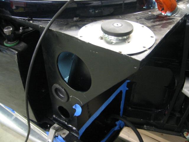

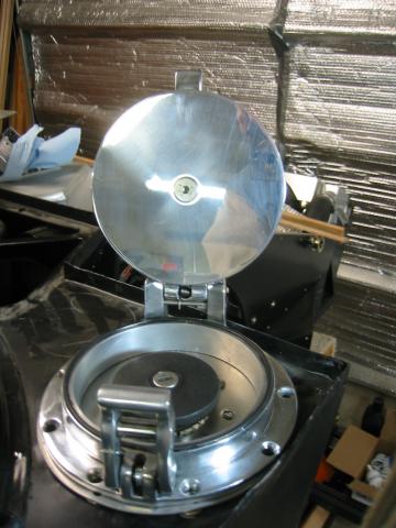

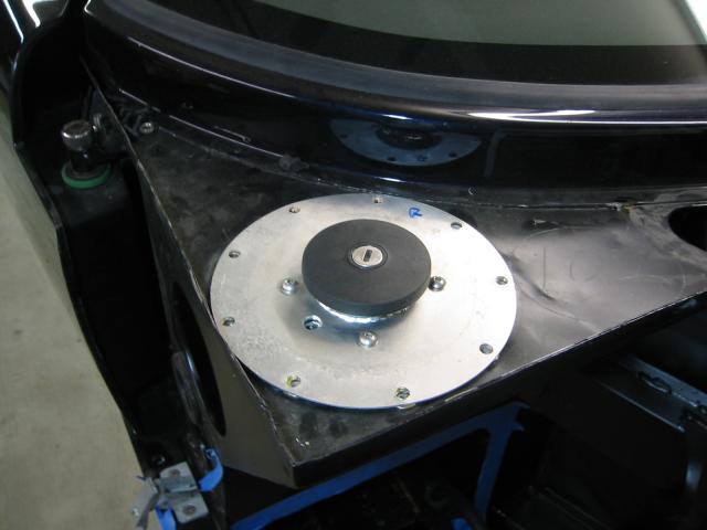

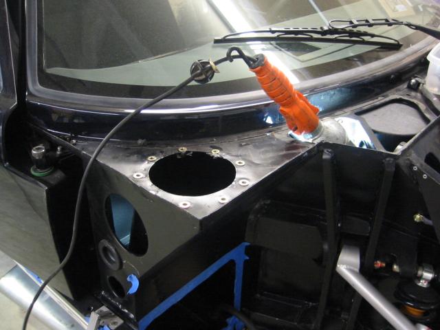

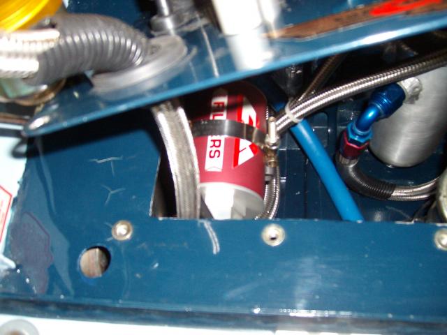

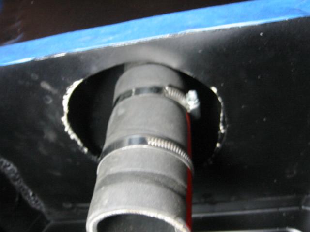

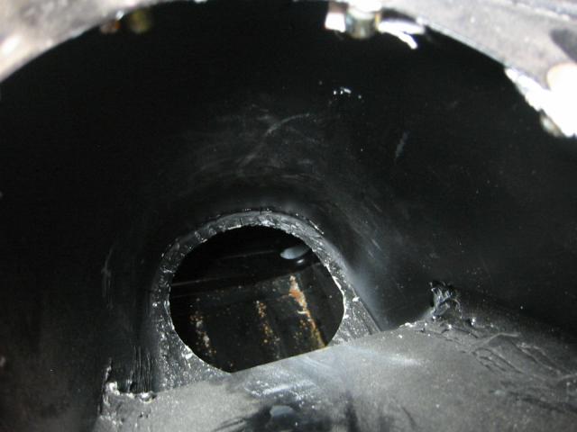

Well Spielberg I’m not, my attempt at making a video was a total bust. I did however take some additional pictures which should clear thing up. Pictures are as follows.
1. “Fake” old style gas cap, besides being decretive its only use is to contain and then dump any overflow fuel out of the bottom of the car through one of the three vent lines.
2. Real gas cap and filler neck that may or may not work as expected. Two vent lines that come up from the tank enter the filler neck just below the cap.

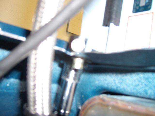

3. The tank end of the filler neck as it enters the sponson.

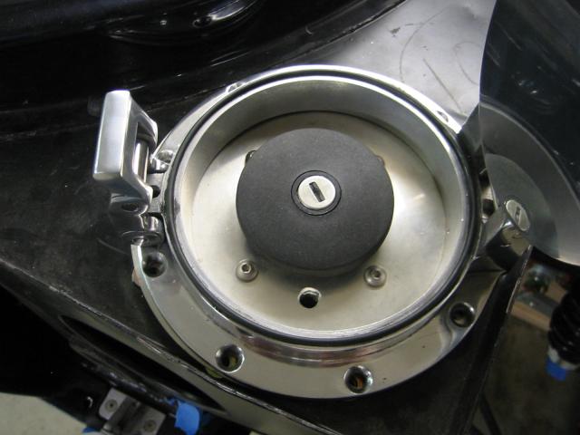

4. This is the important one. It shows the area where the filler neck and vent lines pass through. As you can see it’s sealed at the bottom to the top of the sponson and at the top to the gas cap thus separating it from the remaining A pillar support and dash area. It’s kind of like a stove pipe stuck onto the front of the sponson.
5. This picture shows the outside of this “pipe” as it passes through the A pillar support. I stuck my shop light into the area behind the dash and as you can see the light comes out the holes in the side of the A pillar but more importantly it shows the cover (pipe) around the filler neck and should prove that that area is separate from the dash area.

Hi richard,
After your pics above I get it. The "stovepipe" really describes it.
I havent pulled my inspection cover off yet to inspect but, I looked at a pic I posted in the SPF forum under P2125...on page 3 showing new inspection plate gaskets and it looks like I do have a base of what might be the "stovepipe" like yours.
If I'm like you with the stovepipe and closed off sponsoon to the void where the large holes are plugged it won't help to drill holes in the plugs as Lynn has; we need another opening into the forward end of the sponsoon. Where do you think would be a good place that won't let water or debris enter?

Richard,I DO NOT have this stove pipe, but wish I did, I see that SPF has made more my changes to in order to keep these fumes from entering the car. I retract my statement about the holes going to the cab. I see that our cars are 33 apart, so I wonder when they started making the change? Your pipe has solve many of the problems I have been trying to fix. I hope to see and meet many of you on this form at Road America, it will be good to compare cars and notes.

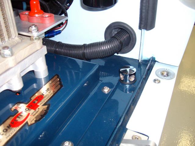

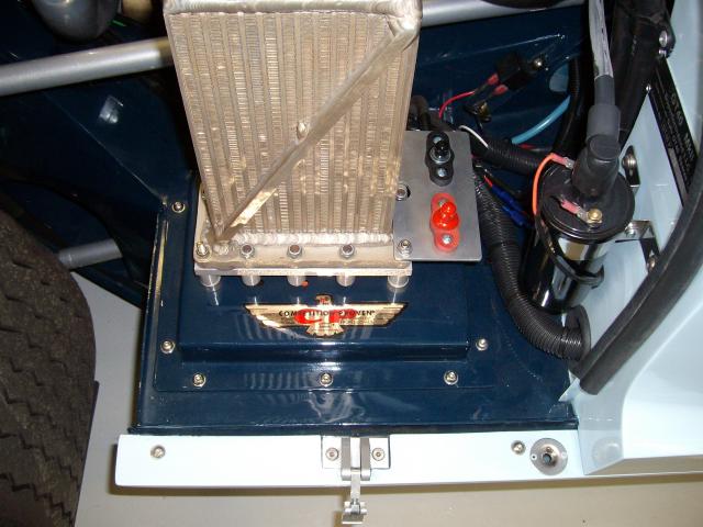

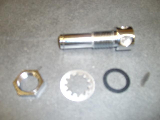

See pics below of vents I added today to the R & L rear sponsoons (similar to what SPF is now doing as shown by Richard above):
This post before and pivc of vent components (vent is a chrome plated brass thru hull vent purchased form "West Marine" store.

Below see hole location and completed R & L sides:
