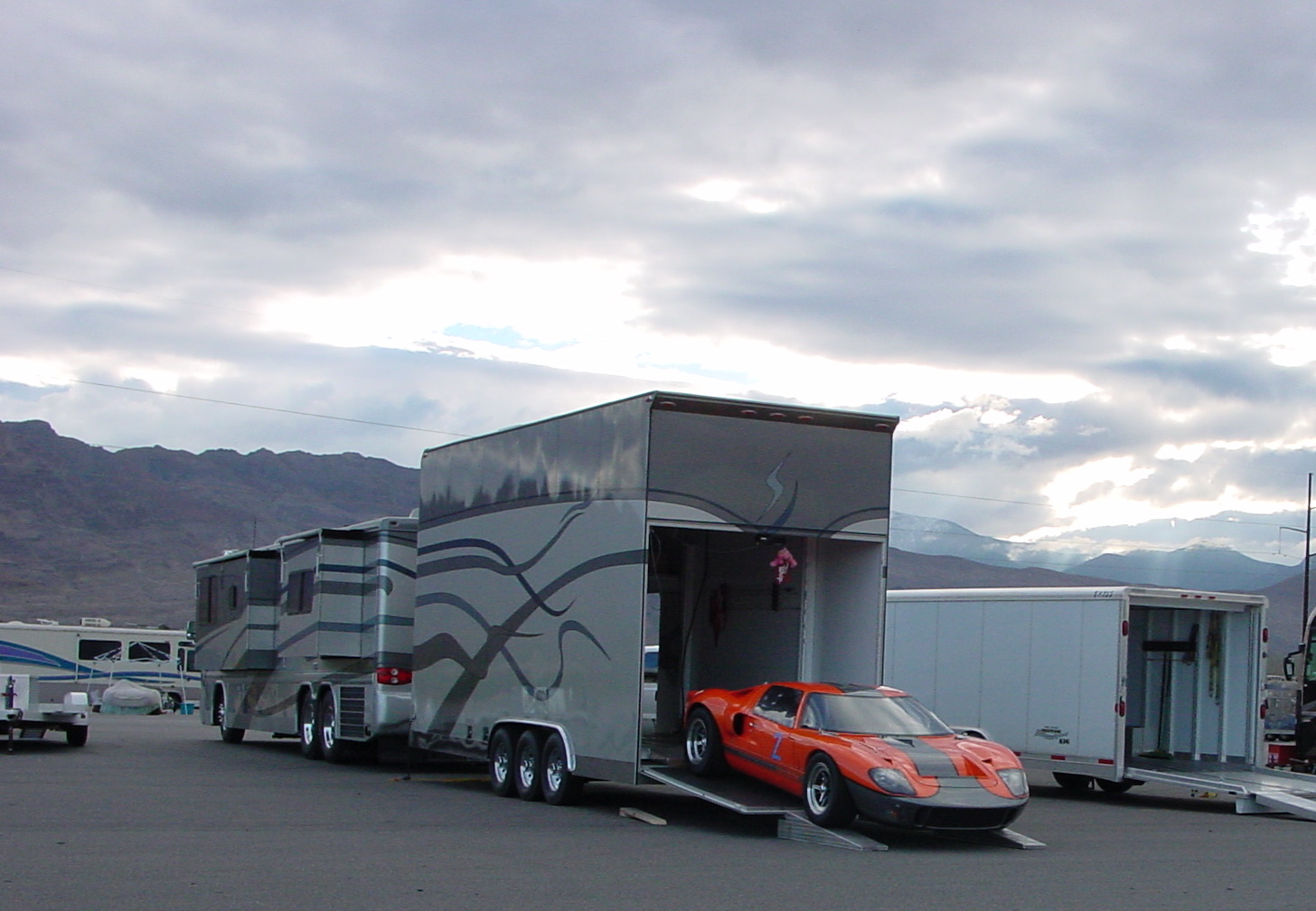

P-nut's right, California maximum legal length (overall) is 65 feet. Majority of coaches are 40 feet, so a 20 foot box trailer (plus 4' tongue) lies just under the limit. With that said, 'size matters' and how lucky do you feel. Even a 22' box would be overlength in this instance so my thoughts are what's the difference if your 1' or 5' over. In the unlikely event you get pulled over you'll be dropping the trailer and calling for a tow either way. I've had my 24 stacker box for seven years here in Calif and no issues. That's not to say, I do pick my routes and fly under the "radar" whenever possible, the pic below explains why it does stress me a little.
I agree with P-nut that a 24' box is a prefered length even for resale and I've never heard "Gee, I wish I had a smaller trailer" either.
Also, from what I've see the majority of track days are not like Nascar where everyone drives a 40' coach. It's more dually's, pickups and smaller tow vehicles.

Does the GT40 door (about 16" off the ground) clear the trailer wheel wells?
On my box trailer - Floor to top of wheel well measures 12.5" and on my open trailer it's 9.5" The prloblem opening the door is not the wheel well but the wall.

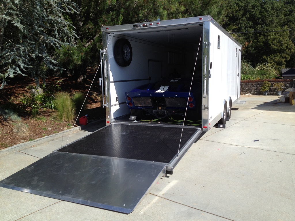

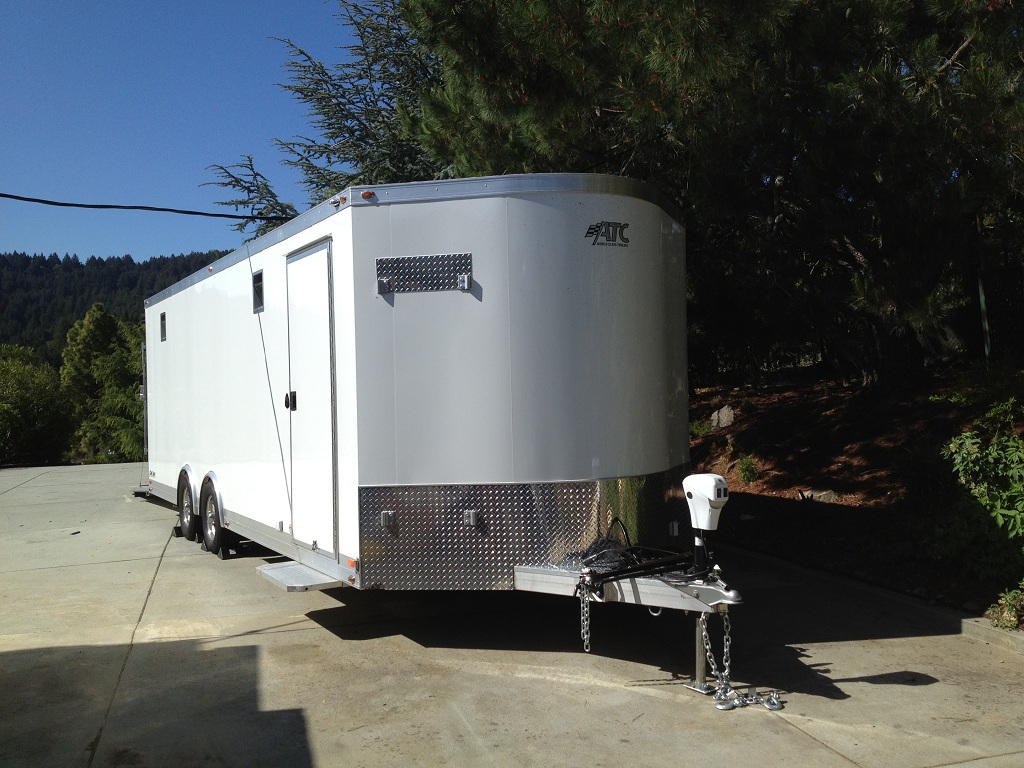

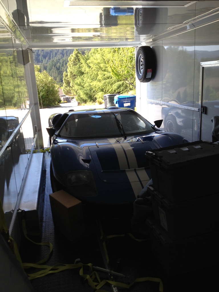

After moving the key elements of the household (P2160, my wife and the four cats) 500 miles north in one 9-hr drive, here are some pictures of the trailer with P2160 still unloaded. Thanks again for the great advice.
BTW my original color choice was silver to match the tow vehicle, but couldn't get that with 0.050" skin (which I preferred over more wavy 0.030"). So now I'm going to "wrap it." With wrapping providing nearly total freedom, looking for suggestions on a color scheme....
