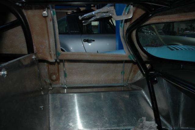

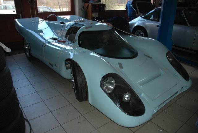

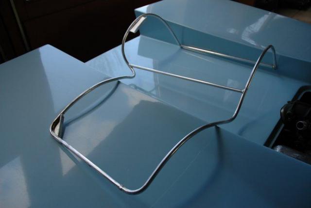

hi everybody.attached som pics of the current state off my 918.as you can see the lights are mounted.i bought vw golf typ 2 lights and they look perfect to me.had to stretch the body a little bit around the windshield so there would not be tension on the window.for this purpose i riveted some L shaped aluprofile between tub and lower windowframe.then my panelbeaterfriend had to cut small slits in to the door so it woul allign properly with the body and now he is building a aluframe to be glued to the inside of the door to give it some strenght .the next headache will be to build original looking door hinges,but this is somthing for my next post.solong petr:thumbsup:
