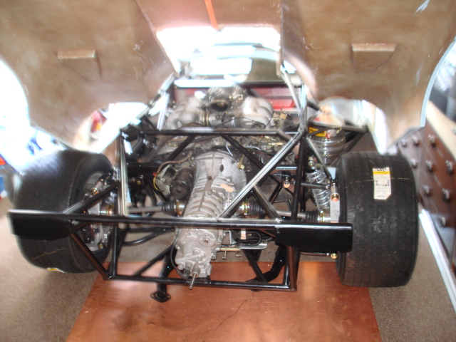

so,in the meantime i put in a 3.2liter carrera engine and a 915 gearbox with reversed ring and pignion.for all the 12 cylinderfans,i can tell you this engine fits theigt and i even had to take the heatexchangers off, of the headers.of course,by relocating some smaller gastanks to other aeras one would gain some space.
on the stock fuelinjecton i had to cut and reweld the part with the butterfly,so it would not stick out of the body,but otherwise it was a straight forward action.

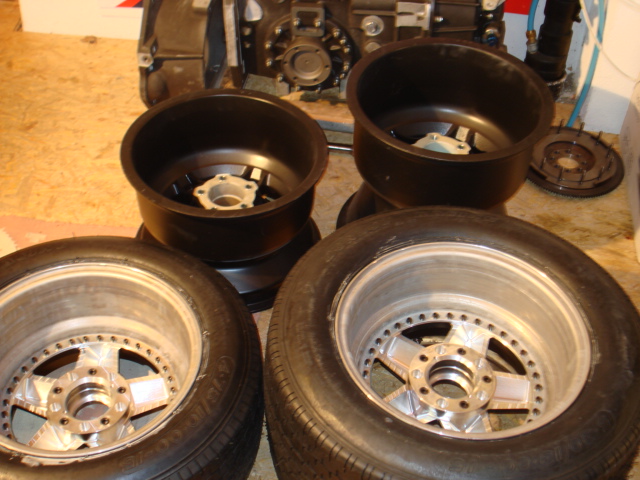

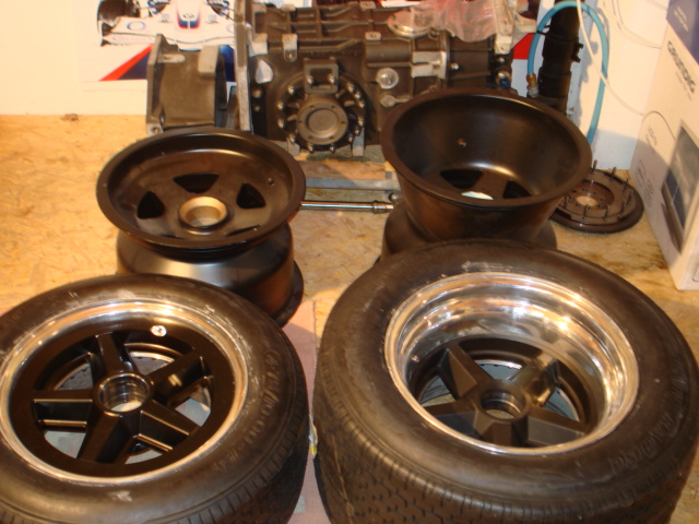

i attached a picture of the 3.2literengine and the 915 gearbox with reversed ring and pignon.as i said,it was a thight but easy fit.i ordered 2 bursch headers(490usd) from eckler industries in titusville fl. and they went on easy again.i will fabricate some mufflers now or even put some cherrybombs on for the beginning.
then i went on working on the wheels.

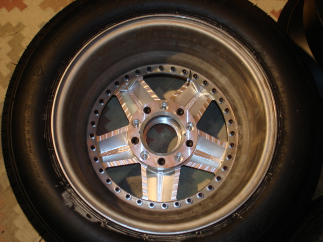

on the 3part backwheels it is enough space to fit a regular airvalve and after finding a supplier for 140 pieces of 1/4x20 bolts(2.25usd each)the fun started.however the frontwheels are a different story:you have to glue two wheelhalves together and to bolt in the center part.on the outer wheelhalf there is not enough space for a regular airvalve.i decided to go with some design valve where you need a extension to fill in air.so i had to drill a hohle in the centerpart and to find the right angle from the beginning was not easy.
i also attached pictures of this.the wheels with tyres on are rcr.
the wheels in the background are real campagnole 917wheels(i will keep those for wintertyres:laugh:)
:idea:dear fran:i know i have early wheels,but i am shure the next customer will be very gratefully to pay a little extra for complet and assembled wheels.
ok that is it for today,i have to work on the bluemonster,so i can send more storys.petr

hi timbo,after a call to fran,it turned out that the holes in the centerpice should have been drilled while still on his cnc machine,but the silly machine forgat about it:laugh:.however on future wheels this hole will be delivered from new and that makes it easy to bolt thogether.(similar to a bbs):thumbsup:sorry for the confusion.petr
