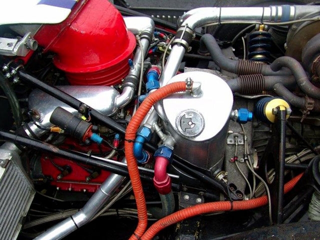

This is a different style of 962 flat fan. It is run of of a jack shaft.
You could make onme out of a bush hog transmission if you had to !

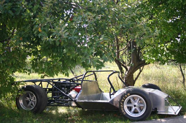

So where are you going to put the radiator(s) for it? And from the looks of Frans pictures, It looks like they are putting the fuel cell just behind the cockpit, which is intruding into the engine bay; so I doubt a 12cyl engine would fit. I wonder if you can use the sponsons on the mono-version of the car to hold fuel, like the originals.
John
Take a look one page upfront at the biturbo 917. One could as well fit the watercoolers there.
The "fan function" of the wheels could also be used there.Have you ever seen a picture of the famous BRITTEN V2 it had the cooler underneath the seat just using the pressure difference there and the fan effect of the rear wheel.
TOM
The space certainly is there but for the 6 cylinder package we mount the fuel cell in the safest and most logical location possible.......
John..we build everything to order so anything is available and possible...check out the VSR as proof....whe do you fancy ordering the 962????
