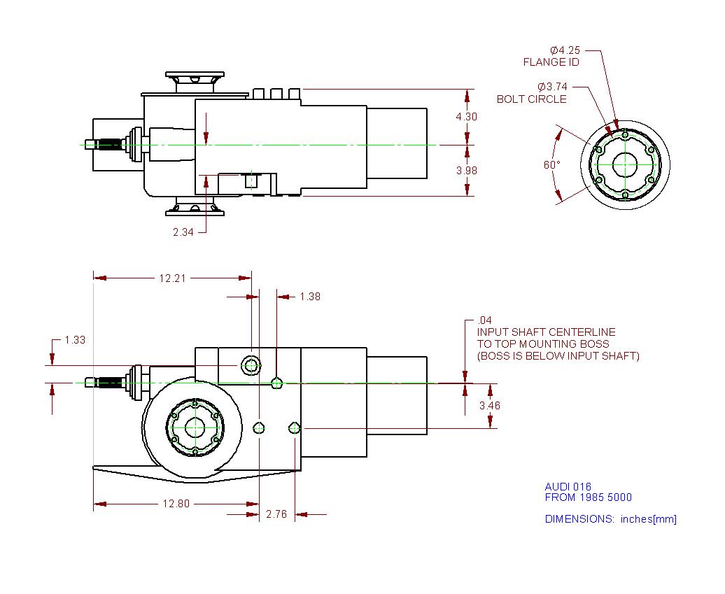

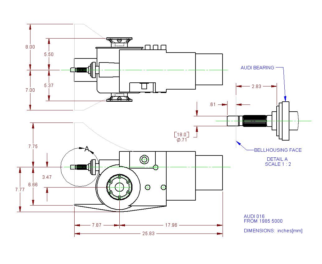

Here are dimensions from a 016 (credits to Chris P)
attachment.php
attachment.php
It's likely an 012 gearbox and very weak. The 016 gearbox was not used in any vehicle since 1991. The 012 dimensionally is different than the 01E, 016, or 02A so using that for a dimensional reference won't help you much as you'll have to use different mountings, different axles if you plan to put a different gearbox in there.
