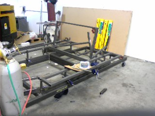

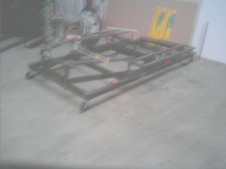

Here is the progress on the chassis that was made this week.

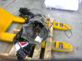

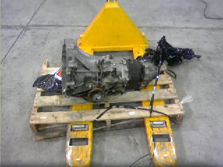

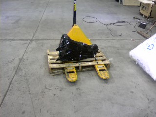

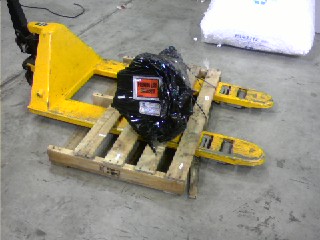

This is the Audi 5N trans I found off Car-Part.com--Used Auto Parts Market. It looks to be in fair shape no cracks or what looked like major oil leaks. Freight was about half of what the transaxel cost
Ordered more steel tubing today. 1 more length of 1 1/2" x 1 1/2" x.125 wall and 2 lengths of 1" x 1" x.125 wall tube. Have not worked on chassis much the last couple weeks have been preparing for my wedding in May.

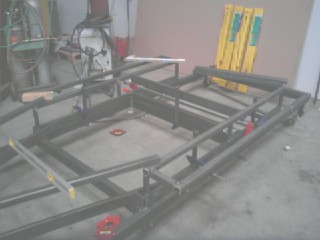

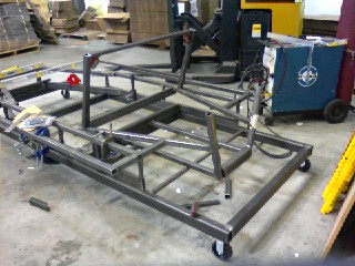

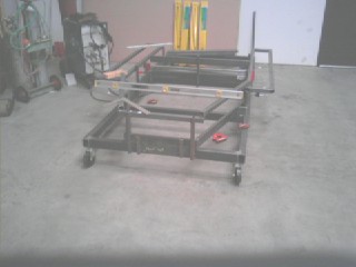

The tubing shortage is over worked a bit on the chassis last week.
The rear chassis section has been cut and tacked in place. Now I am running into time problem my schedule is getting quite full. 12 days to my wedding and moving house holds and such. Luckly my future wife (Luana) is supportive of the GT40 project.
Here is a couple of photos of the progess over the last couple of weeks

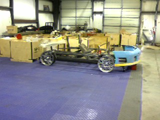

I had to laugh this morning when I walked out to the warehouse. Jokers always seem to show up. BMW wheels, Dodge caravan seat,Porsche nose and some side skirt for the wing. I am leaving for my wedding today wonder what it will look like when I return!

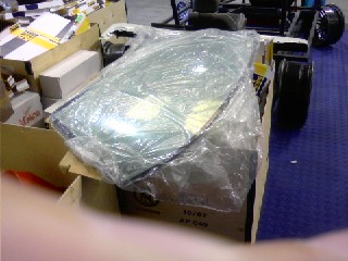

It is my first day back to work today. I was happy to see that my windsheilds had arrived while I was off on my honeymoon. Mailorder is like having Chirstmas year around. :pepper:

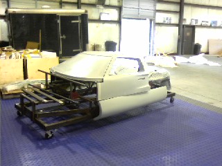

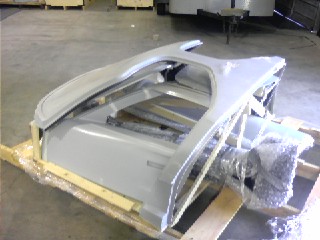

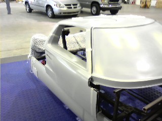

Hey Guys:
I got a smile a mile wide today. A freight truck driver called as I was going out to take my lunch. He had a skid of body parts for a GH 40. Ater guiding him to our hidden loading dock. We unloaded the coolest thing I have gotten so far. The spider,doors,side pods and dash where on a skid. After a few minutes of flying cling and bubble wrap. I was able to set the parts on my chassis. I just want to say Thanks to Daytona Bill:thumbsup:. The parts are quality and the trim edges are cut nice. I am impressed much better quality than the Locost 7 parts I bought which were not that locost. I'll post some pics a little later
Took some time to set the body parts on the chassis yesterday. It looks like they will fit as planned with room for adjustment. The main question in your mind when you started welding a scratch built chassis together is will the body parts fit. I widened the seating area of my chassis to 45" which caused the fuel tank side pods to be narrower than other builds. I figured better less fuel than trying stuff 10 pounds of me in a 5 pound sack.
I would like to say Thanks to those forum members that have helped my dream take shape:thumbsup:. Thanks Guys

Hi Guys:
I need some information, Does any one have the crank shaft centerline height using an Audi 5000 trans? I need the bottom of the chassis to the crank centerline.
Thanks in advance Dave
Hi guys:
It is good to be back in the saddle again.Cool weather is meant for welding. I discovered my first error today on my chassis. I had wanted to keep the rear of my chassis as stiff as possible. So I chose to use a section of 2" x 3" rectangular tubing for the lower cross member between the two upright tubes that hold the upper cross member. Now the Audi transaxle hits the cross member and is preventing a lower crank centerline.
Oops time for the gas axe!!!!!!!!!!!!!!!!!!!!
Hi Dave,
The tubing I used for the rear sub frame is 1.5"X1.5". In order to get the engine as low as possible I removed the "skid plate" from the bottom of the Audi 5N. If you look under the 5N right behind the bell housing mounting surface you will see the rather large part of the casting I'm talking about. This modification allowed the engine to be lowered over an inch. You could also leave the part you're talking about in and profile it to clear the transaxle and weld a .125" cap to box it in. This would give you a very strong cross member as well as the clearance you need. Just a thought.
Steve
Thanks Steve:
Because I have most of the assembly welded I will have to clearance with the torch and then weld a 2" X .125" piece in a arc so it looks like I somewhat planned for the problem I created.
