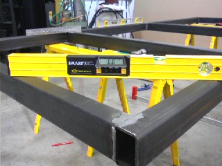

Started welding together chassis jig today. I made a good investment a couple of months ago. It was a smart level made leveling the jig a breeze.

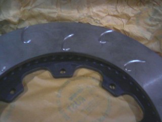

For the front of the 40 I have chosen to go with 12.19" x 1 1/4" 8 bolt on a 7" bolt circle rotors.

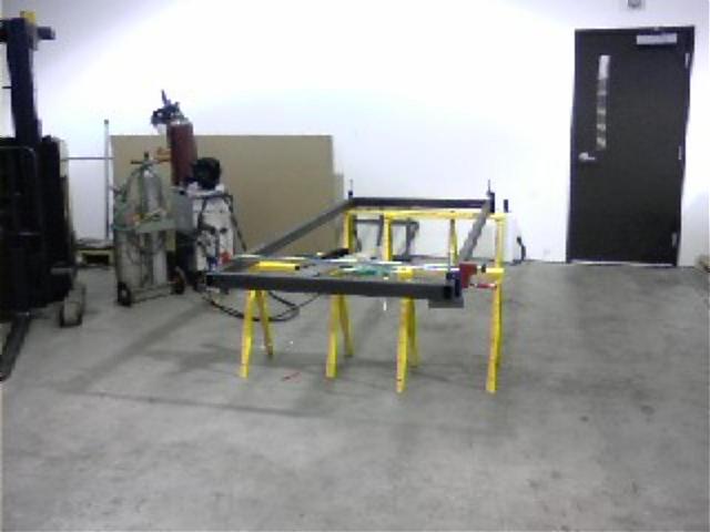

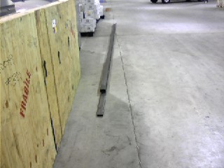

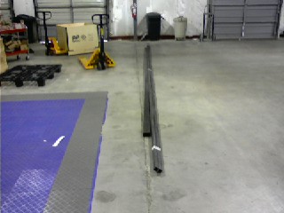

Here is my starting point with tubing
2" x 3" x 3/16" wall for chassis jig Thanks to Russ Noble for helping me get these pics up Cheers Dave

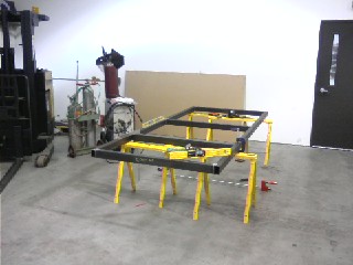

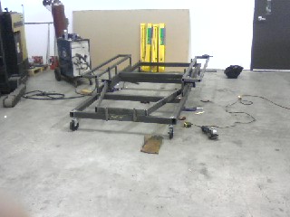

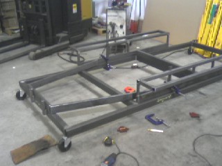

More welding on chassis jig today. Should be done on Monday.

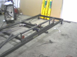

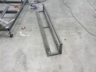

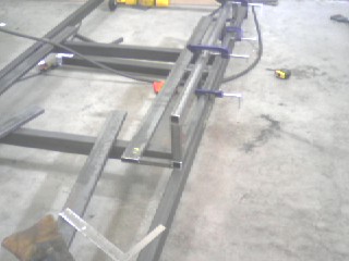

Started tack welding and fitting some chassis pieces together today. I used chassis jig to clamp and tack the side pod portions of the chassis.

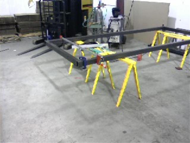

After the side pods were tacked together I clamped the side pods in postion on the jig. I laid the front snout portion of the chassis in place to get an idea of available leg room. I have opted for a tapered foot box area simular to the KVA chassis but my lower frame rail is 3" x 1" x.125 wall tube. I only have a few more days to use the welder here at work as we are getting ready to install my last fabrication project our brake dyno.
Chris Duncan
Your chassis will have less warp if you anchor your jig to the floor. What happens with a light jig like you have is it has no torsional rigidity unless you anchor it. You can get the chassis all perfectly straight while it's tacked but with the heat of the full final welds it will twist.
If you look at some of the pro builders they have a monolithic jig table that can't warp.
Also realize that you will get some warpage no matter how ridid the clamp down is during welding. It will be "sprung" at least a little no matter what, so if you anticipate this you're better off. If it's an unacceptable amount you can jack it straight if you have some anchors in your slab. Minor tweaking will not hurt mild steel.
One thing you should do is have all the tubes already final welded before you weld any of the suspension brackets. That way you can place the brackets for optimum alignment no matter where the frame rails end up.
For example it's acceptable to have up to 1/4" warpage in the main chassis rails but it's not acceptable to have that same 1/4" innacuracy at the suspension mounts.
You can also minimize chassis warpage by welding in a strategic order (I call it the diagonal opposite method) but it sounds like you already have some racing building experience so you may already know this.
Hi Kalun:
Thanks for your input.
You are correct that a surface plate is a much better way of manufacturing a tubular chassis. The cost of a surface plate is not in my budget so here we go. Besides I figured that the jig I have constructed would be better than the plywood ones guys are using for their Locost 7 projects:eek:. Russ Noble had also shared that his chassis had moved a little also.
Over the years on our oval track cars the thing that escaped a lot of the guys when setting up their cars was making sure the car was squared.
Cheers Dave
