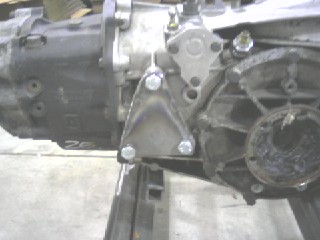

It sure is good to make some progress. I made some mounting plates for the rear mounts of the transaxle. I used a piece of paper and rubbed the bolt pattern and transfered it to the steel using a paint marker and a centerpunch. A bit more grinding to straighten up the sides and I'll be done.

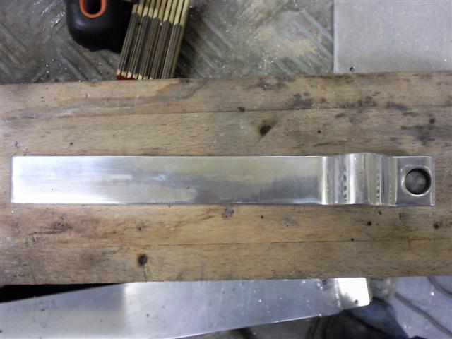

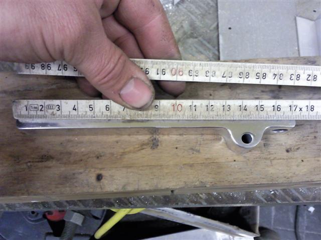

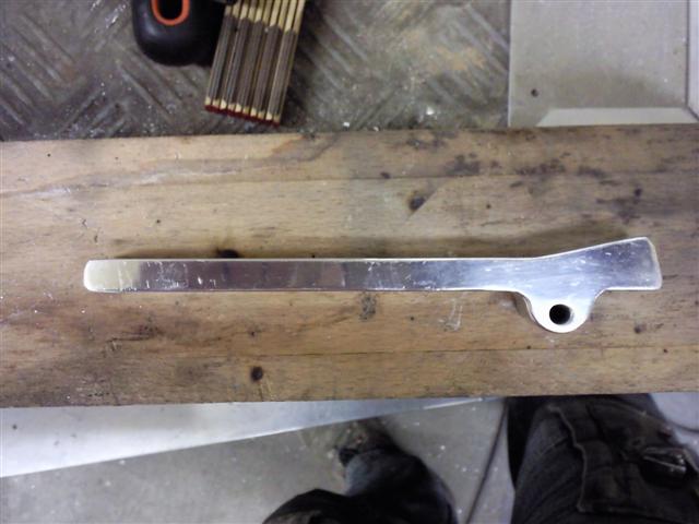

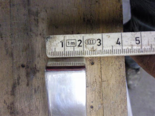

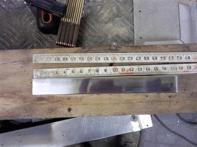

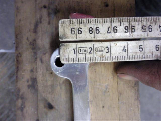

Dave here are the pics

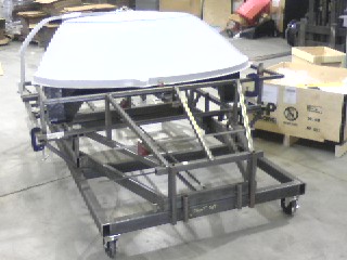

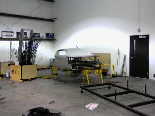

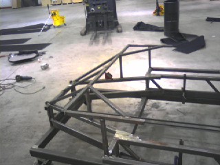

Have made a bit of progress lately. The dash bars are cut and tacked in place. I did have to cut my rear bulkhead uprights loose to reposition them farther back on the chassis

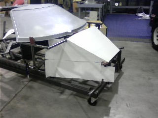

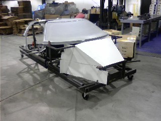

Made some cardboard templates for the aluminum cladding.
Suspension mock up is the next part of the project.
Hoping to buy a mig welder after Christmas and move the 40 home.

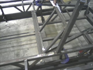

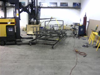

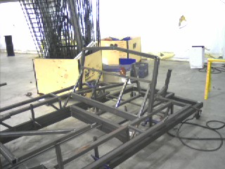

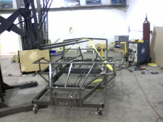

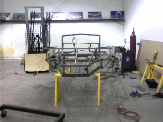

Have made a bit of progress over the last few days. I had to go back a bit to go forward. The side pod frames were a little to long so I had to shorten them about 2 1/2 inches. I also moved the upper cross member behind the seats back 1 1/2 inches. Lots of suports were tack welded in place and I have been going back and welding them completely. Once all the major welds are done possibly tomorrow I will cut the chassis loose from the jig.
A few of photos of work I accomplished during the last few days.
I mainly work on the car during my lunch break which is about an hour.
Some days I run errands to run so it has not been an everyday ritual.

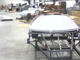

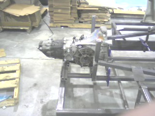

Yesterday was a great day got a lot done! All the welds on the upper side of the chassis are done:pepper: Russ Noble and Kalun D had said the chassis would spring and possibly twist which I knew to be true. It was my hope that by tack welding and using clamps in key locations it would be a small amount. The moment of truth had arrived. I cut the tack weld and loosened the clamps. The chassis sprung about .150" over the whole length side to side and the chassis stayed flat to the jig no twist:pepper::pepper::pepper: The next step is suspension after Christmas celebrations.
Fit the body parts without the chassis jig also welded the door latch supports in place to the bulkhead frame work. Also made end caps for some tube ends.

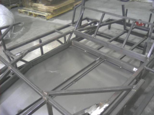

Have a bit of progress to report. The floor pan is welded in place. I chose to use .045" steel instead of aluminum.
