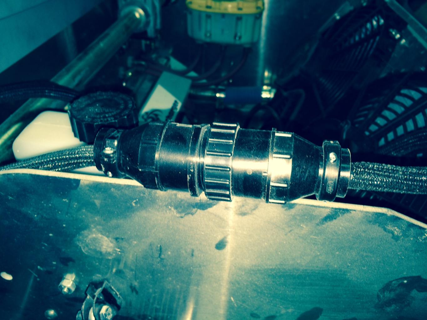

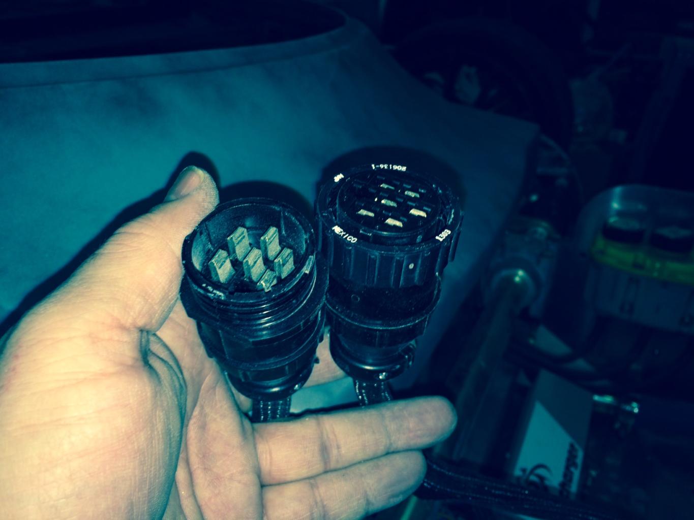

I made a new much better fitting front wiring harness with a coupler to help make it easier to pull the front end off.

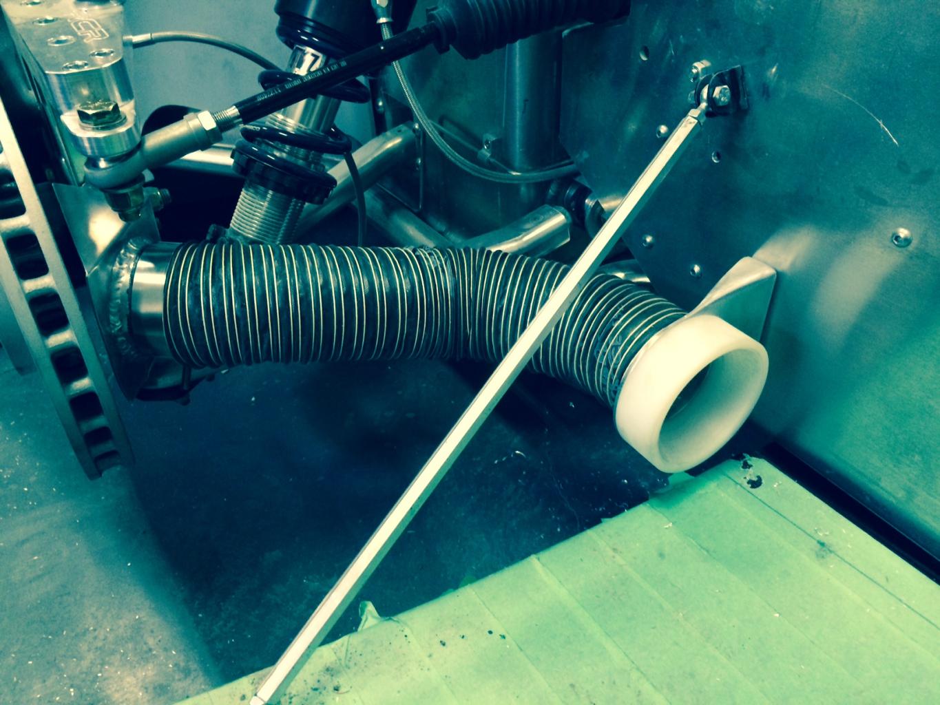

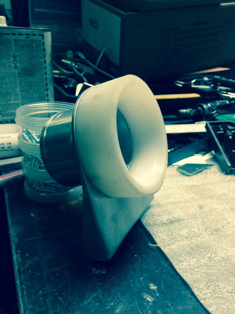

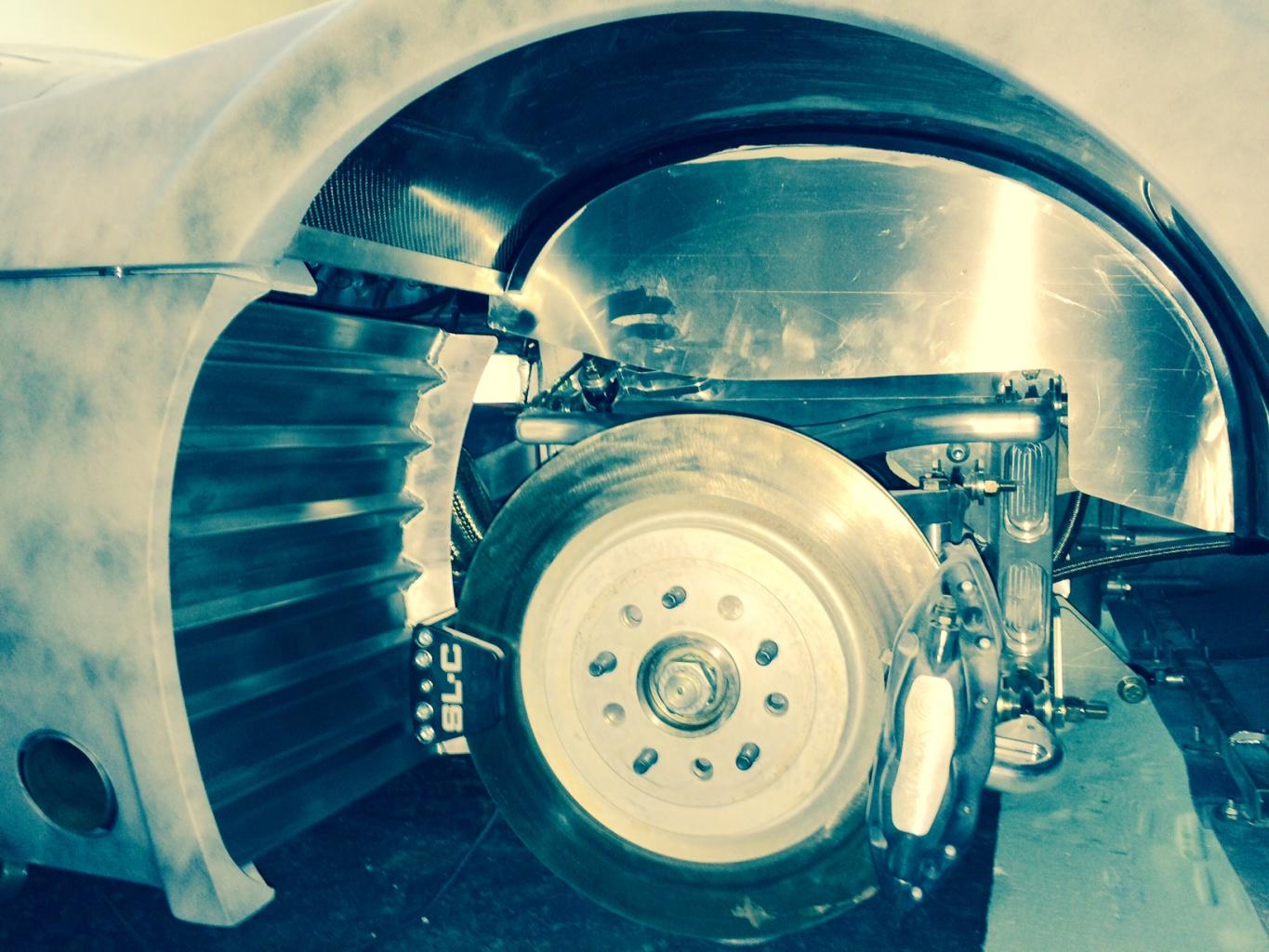

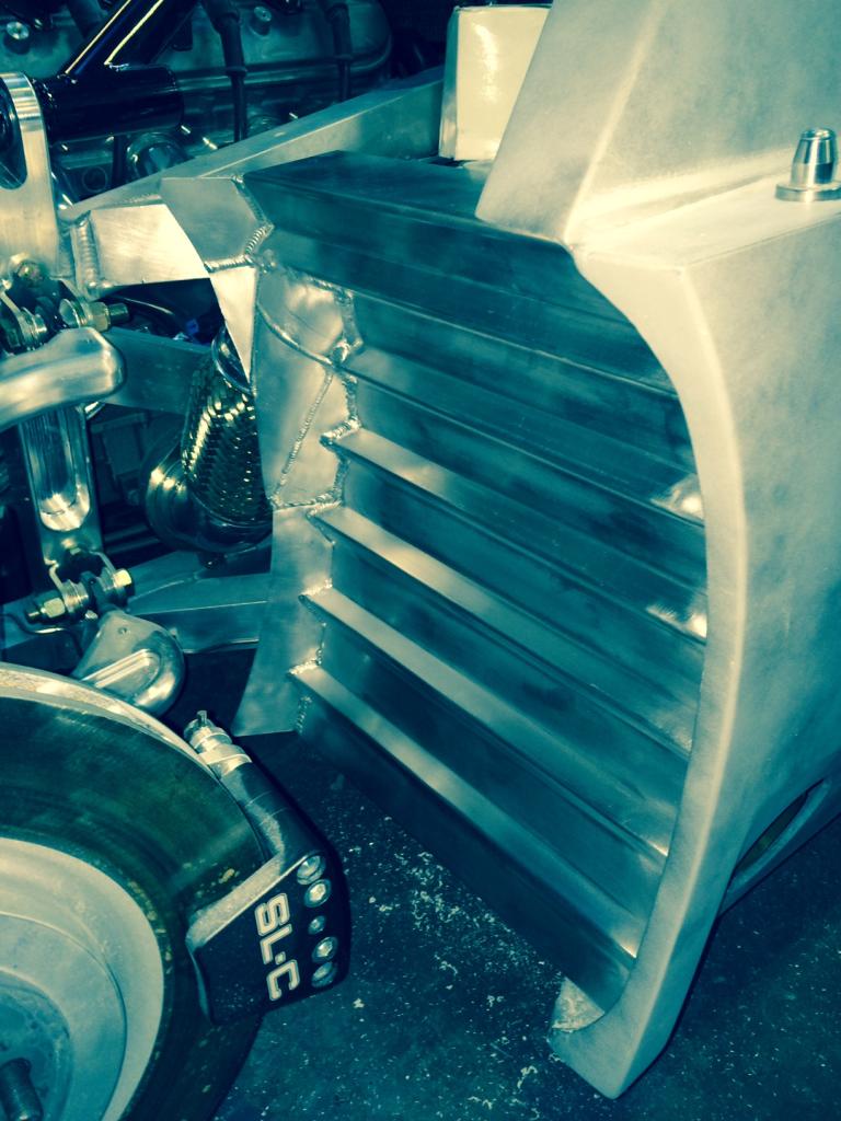

made a quick coupler for the front brake air duct as well nothing to disconnect
they just slip together.

Please let us know the part number for the connector. Is that connector weather rated as well?
Also, do you have drawings for the brake duct brackets and a supplier for the brake ducting? I assume that you buy this type of material from Pegasus or another site? What size duct are you using? It looks like (3 inch)?
Thank you,
Aaron Hamilton
Hi Aaron,
for the connector companys name is Newark element, part numbers are
1 req 46F1149
1 req 46F1150
2 req 76K2522-Clamp
7 req 52K3913-PINS
7 req 52K3480-SOCKETS
The air duct and mounts to front brakes I bought from Toby at CRC racing,
the front and mid connector I made, have no drawings but they are simple to do.

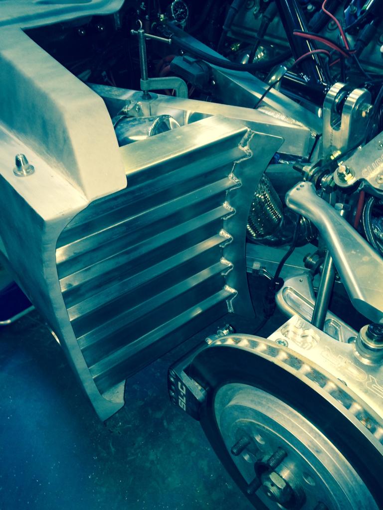

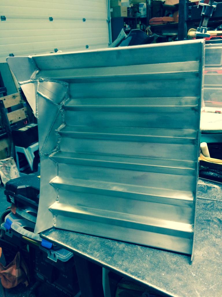

Made up new Alum rear inner wheel wells, the passenger side needed to be modified for clearance due to the exhaust being further back on that side of the engine.

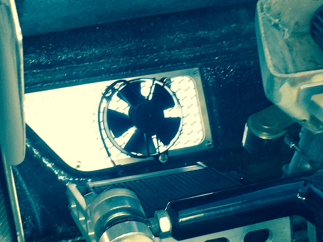

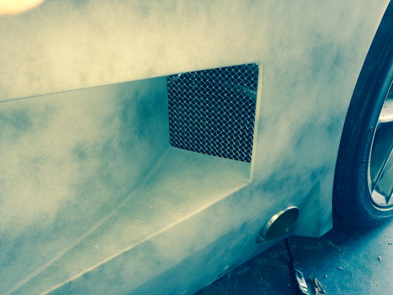

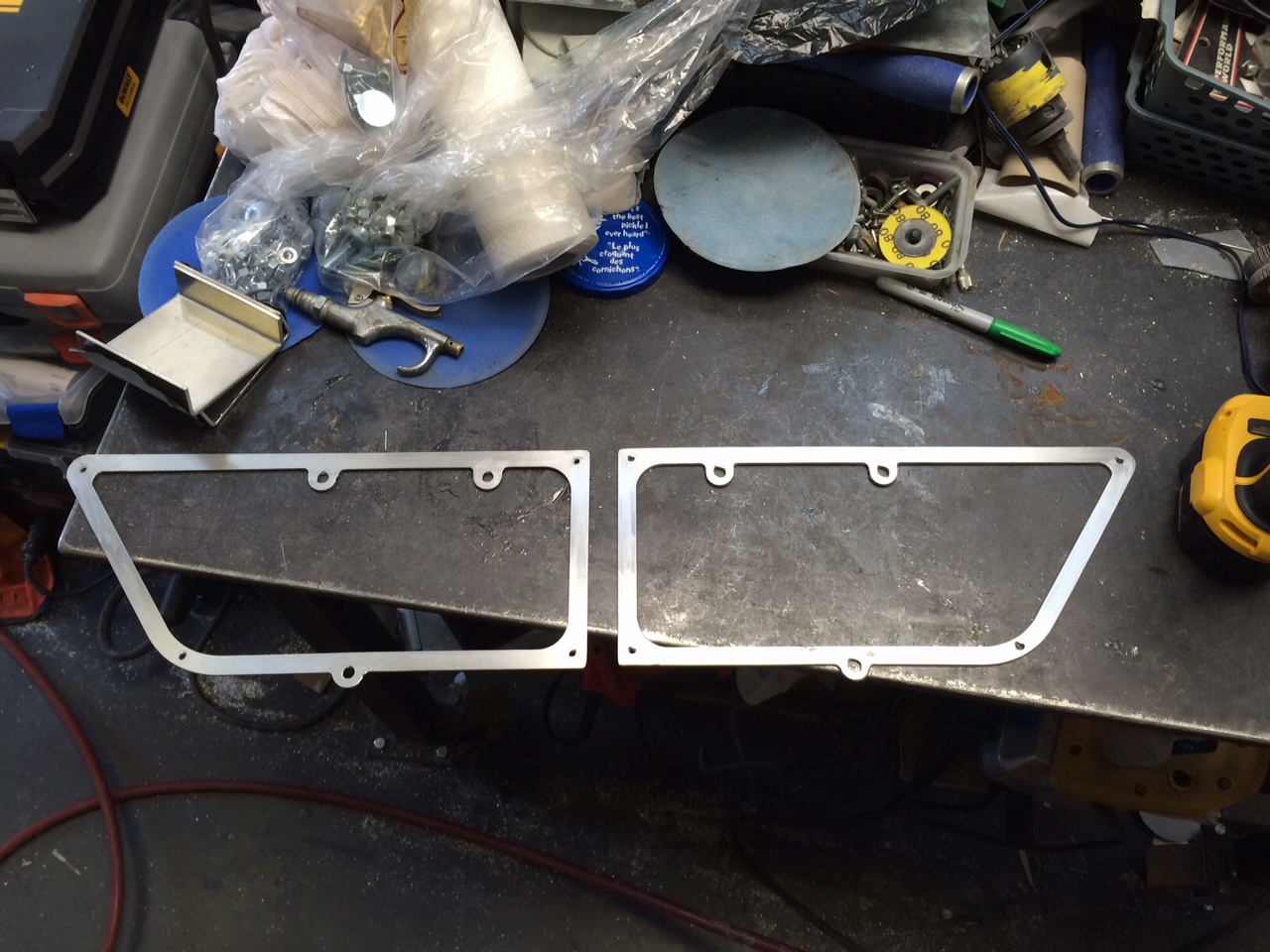

just started messing with the car again. I extended the scoopes inwards an extra 1.5"
and made the screens for the side vents used a SS woven wire mesh.
Then made some brackets to hold the small fans at the back to help extact the hot air out of the engine bay.

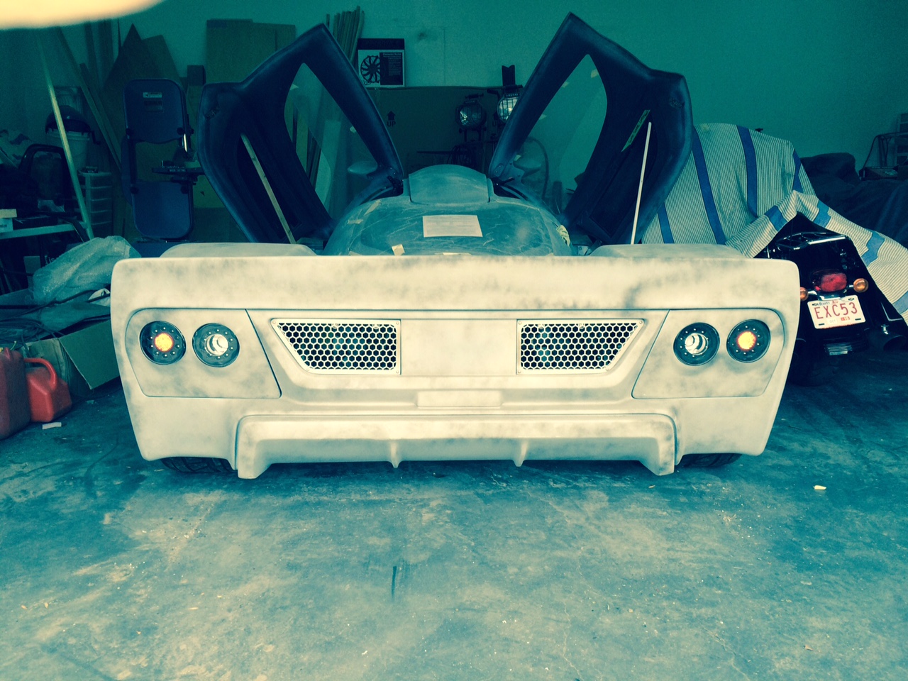

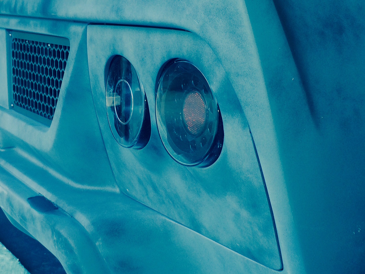

After many hours of fiberglassing, shaping, re-fiberglassing and reshaping I finally got the covers to fit the led tail lights. Still some tweeking to do but they should look ok after the paint go's on.
