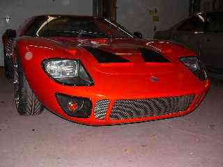

Went for the first legal drive today. Was pretty eventful. I had a co-pilot to help with the SDS adjustments. We thought we were doing OK until it died on the side of the road. I got the car going again when we came to the conclusion that one of the gas tanks was empty. Got going again just to run the other one dry a few miles down the road.( The fuel gauge did not read correctly) Then called for assistance and got more fuel. Still would not start. Finally decided to open the return side of the fuel rail to bleed out air and the fuel pump started pumping fuel again and we were off again. Gassed up both tanks and were off again just to hear the clutch release bearing squeeling again. (Already changed one out and checked the clearance).The engine seemed to run poorly on the way back and was popping thru the throttle stackes so bad that 2 of the screens blew off.As I said before, One step forward and 10 back.I do believe the fuel injection will ultimately be the way to go, but I am tempted to just take it all off and go to the old simple ways of carburation. Well now it time to take it apart again and try once more. Other than all that I cannot wait until all the kinks are out and can just drive. The attention this GT was getting was unreal.

Sounds like fouled plug/s.
Probably from all the mucking around with the fuel problem or just way too rich somewhere.

It appears as though the clutch slave cylinder is the problem with the release bearing. It is stuck partially out. I am going to spend the afternoon removing the transaxle an inspect the clutch. Hopefully a new slave cylinder and bearing will cure the problem.

Its all apart now and it looks as though I need to have a sleeve made longer to go on the transaxle. I think the bearing is getting cocked a little and does not return correctly.
Hmmm, maybe the problem is with the master cylinder... The travel/diameter may be driving the slave further out than it needs to go. You may need to add a stop to the pedal or change the piston diameter for a smaller one. Another possibility is that there is too much dead travel on the slave cylinder before it does any work. Just my 2 cents, good luck !

I am using the renault un1 with a Tilton master cylinder. I had a bushing made for the clutch release bearing that I believe was too short.I now have a new one that will cover the total travel of the bearing.I am also planning to monitor the pedal travel and adjust the stop accordingly.I will do it this weekend.As for photos, The transaxle and slave cyl. are currently out. Photos now would not be much help.Again, Thanx for all the help.

Spitting back through the intake when giving it throttle is usually a sign of being lean. I don't know all the features of your ECU, but concentrate on the steady state fuel curves first with the engine up to operating temp. One you get that pretty close, then mess with the "fuel pump" additions (to make transient throttle movements smooth), engine and air temp trims, cold start (and warm start) calibrations, etc. There is a ton of them (in the E6K I use), and I'm still messing with the ones that vary fuel for varied air temps since I've been driving the car in 30 degree weather as well as 90 degree weather.

Wayne has been here and has done his magic! With a total of about 2 hours time the GT goes like H@&!!I still have a leak in the transaxle but the clutch throw out bearing problem seems to be cured.Shake down miles now. Yee Haa!!
