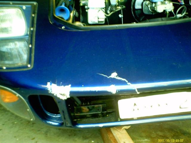

Diagnosis :
- When the handbrake was pulled on hard, I had failed to notice how much the main handbrake cable assembly moved
(the DRB has a self-balancing setup where the inner core pulls a slider on one side & the outer sheath pulls a slider on the other side).
- The handbrake cable assembly pulled up against the main battery feed terminal on the starter with the handbrake on hard
- Over the last couple of years, this finally wore thru the plastic coating of the handbrake cable, so this day was "arc-welding day" !
- With the inner spiral steel cable sheath arcing to the starter terminal, the remaining surrounding plastic sheathing caught fire
- This fire was cleverly located just under the hydraulic hose running to the clutch slave cylinder
- Being rubber, this hose caught fire too, melted, then fed clutch fluid onto the fire - there was so much smoke that I thought Lucas had escaped !!
- The heat from the conflagration surrounding the handbrake cable caused things to expand enough to ease off the handbrake
- In my panic to get out of the car with a fire-extinguisher, I totally forgot to shove it back in gear
- Gravity then took over for a while - until it was quickly brought under control by the corner of a brick wall !
Consequences :
- Upon reflection, I figured that I got off fairly lightly. It might have happened on a big hill with no brick wall in the way - not a pleasant thought.
- I was going to have to do some glasswork anyway - to clear the front tyres from the guard / tank-cover lips (caused by the wheel spacers)
- I was also planning to eventually do other glasswork on the front clip :
- Open up the fake NACA ducts in the guards
- Strengthen under the flat sections (across the nose, & just in front of the windscreen) to get rid of some sink-holes & general ripples
- Hollow out the insides of the recesses for the clip latches to provide more clearance for the brackets on the chassis
- Given the above, a full resto on the front clip was started - oddly enough, the repair of the crunched-in nose was the easy bit
- Opening up the NACA ducts & making short extension ducts under the clip was not all that easy
- The "weather guy" hates me : every time that I had things prepped ready for sealer, primer, etc, the heavens opened !
( I reckon that I could make a living by driving around drought-stricken areas in a freshly primed GT40 & with a spray-gun on my belt ) !!
I finally finished all the repairs & mods on the front clip (including re-inforcing under the flat sections of the nostril panel). The latter just seemed like "a good idea" at the time, so I finished that & let it cure for a couple of weeks, Then I blocked back the top surface & discovered the distortion caused at the front corners by the prang ! (You can see the yellow primer showing thru in the "after" pic - I had to sand away 4 coats of clear & 4 coats of colour, plus some old primer, to get it flat !).

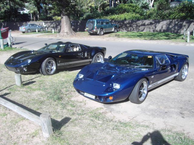

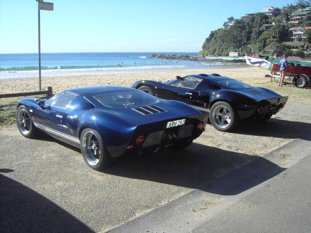

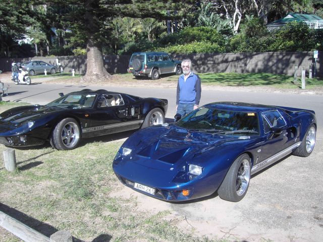

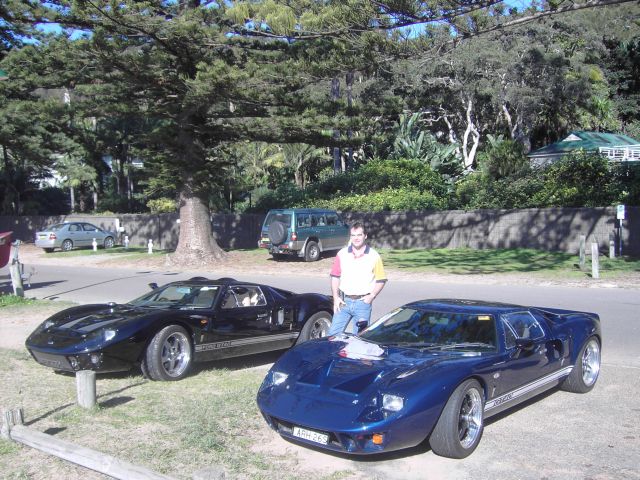

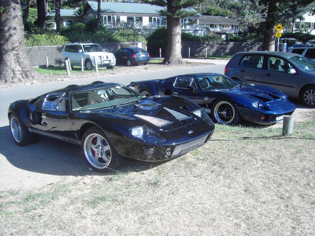

Hi Pete
Copies of the photos of today's run to Palm Beach.
Dimi

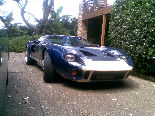

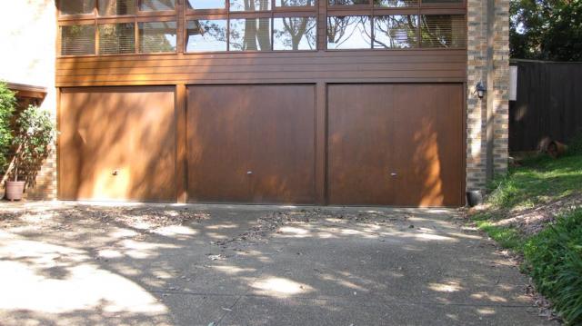

Peter Delaney
Guess which garage the GT40 is parked in !
Bloody expensive, but lots more fun than a a 32cc Homelite leafblower !!
