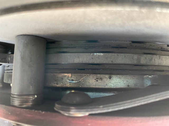

Thanks for posting the pictures. You may find the clutch discs are glazed and flywheel heat pocked, hence no bite.

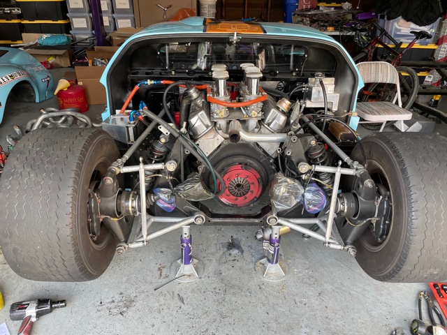

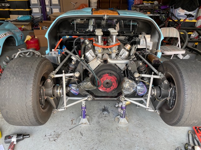

Any tips on removing the gearbox from the bellhousing with the bellhousing still attached to the engine? I have the 2 main bolts at 12 o'clock removed and 4 other bolts holding the gearbox to the bellhousing. But the dang thing will not budge!
We moved into a new house in November that we are completely tearing down and rebuilding so my lift is out of commission and I don't have an engine hoist. Was hoping to pull the gearbox from bellhousing that way I don't have to lift motor.
I've tried jacking up the gearbox, turning, twisting etc. Nothing, won't budge.

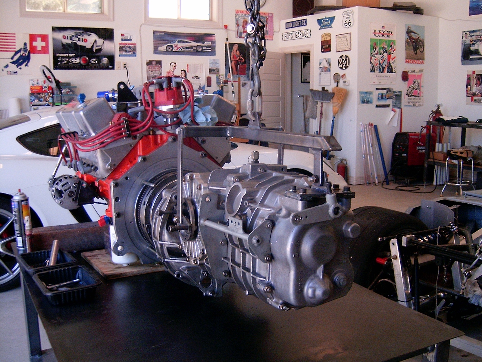

For the cast aluminum bellhousing the two inner bolts are not accessible without removing the bellhousing and gear box as a single unit. Many Pantera owners leave them out for that reason, although personally I do not advocate that.
Well, I finally got the entire bellhousing/gearbox out. Had to remove a lot more stuff due to having to jack the engine up. While I have this entire thing apart I plan on doing the rear main seal, any other preventative maintenance I should do? I have the external slave kit coming.

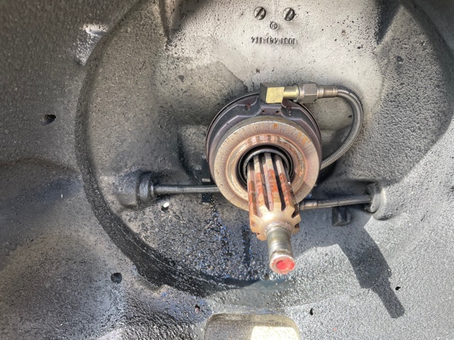

It was absolutely the slave, and my guess it's been leaking for a while.
Also the clutch is done, ordering a new one today also.
