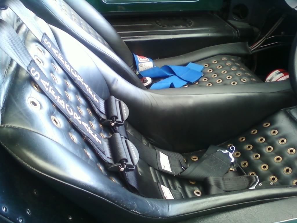

Here's P1061's interior from an earlier post by Mike Drew.

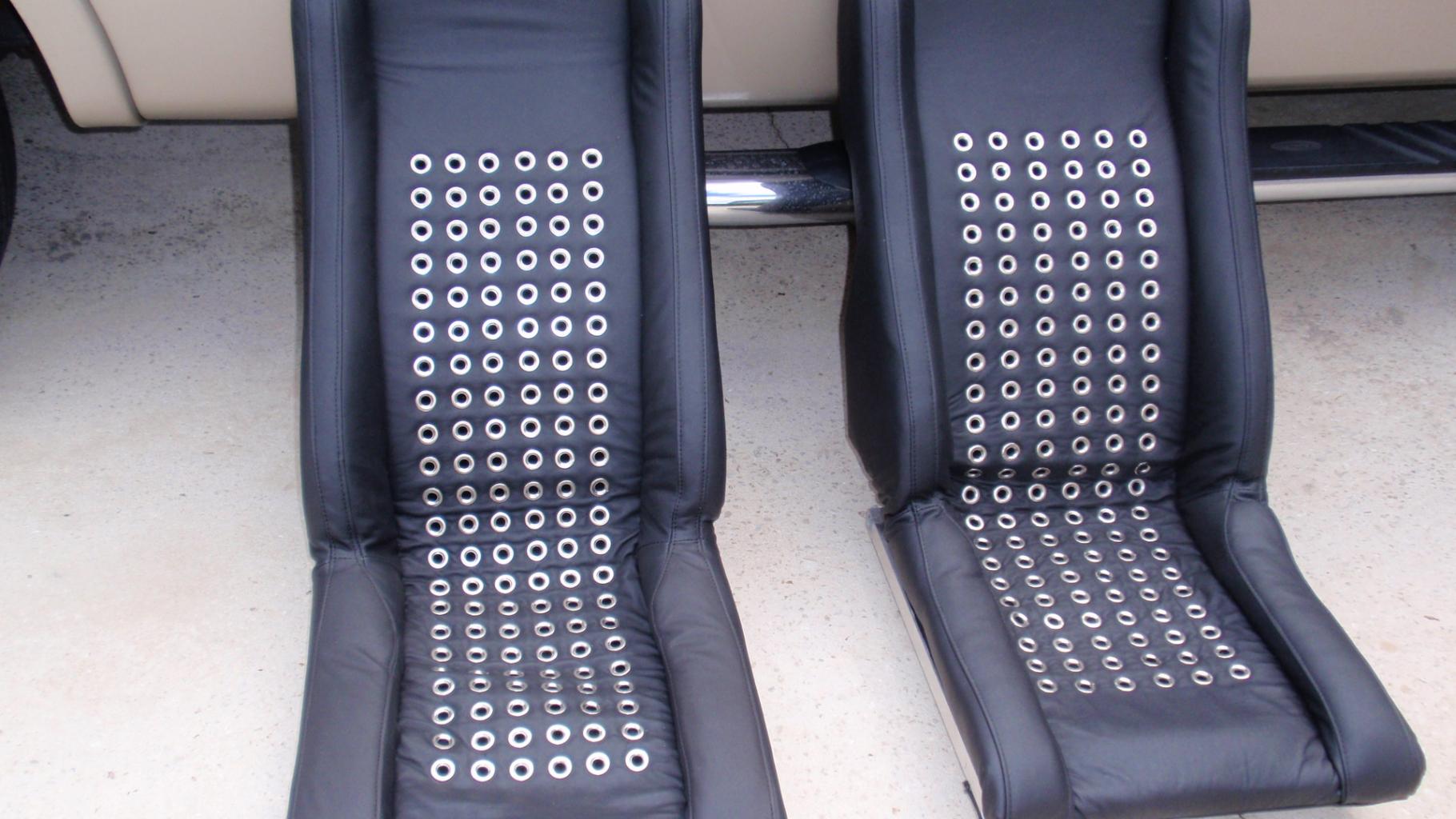

Here's how mine turned out.

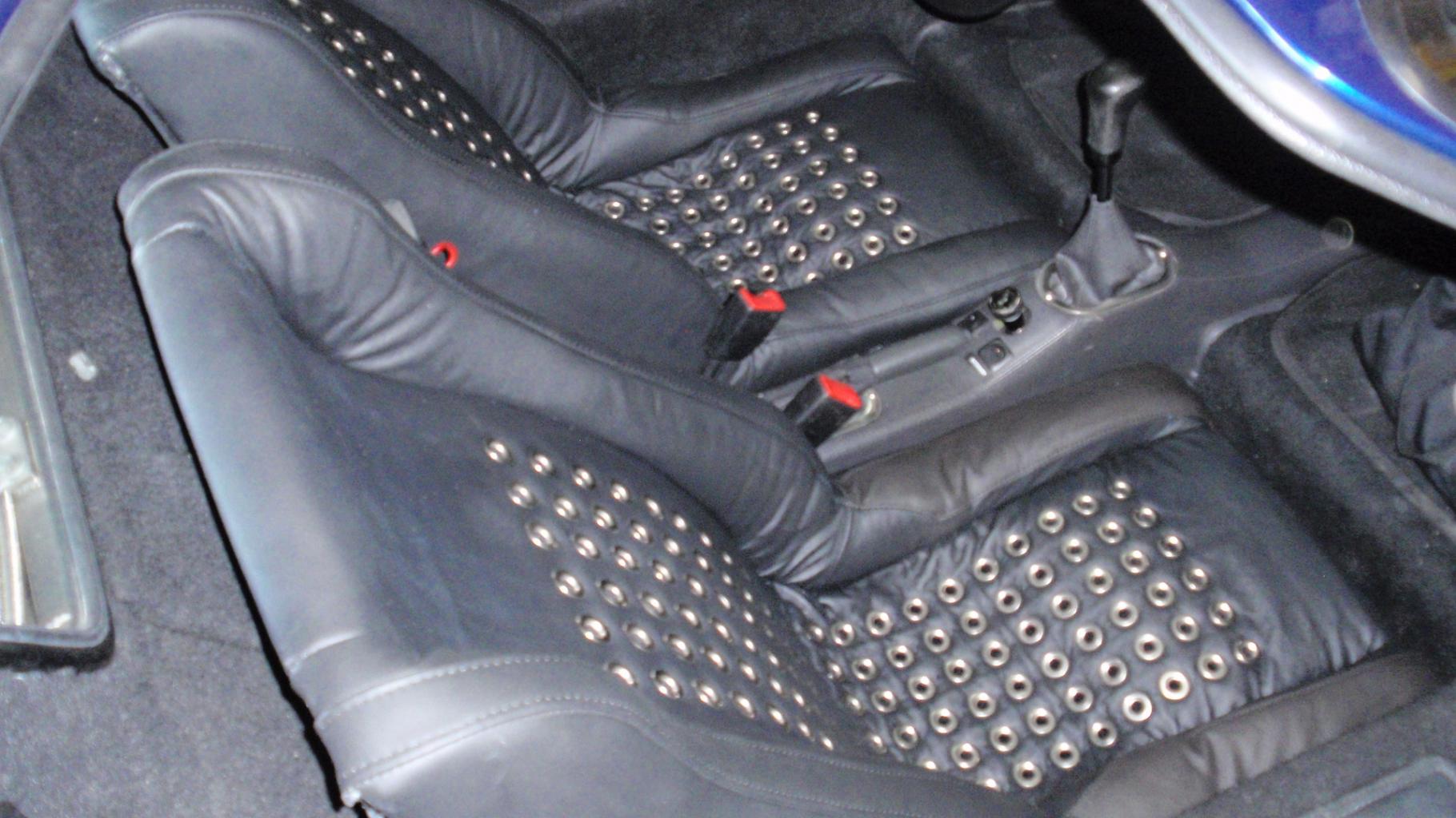

For those of you that want original seats, I collected some nice shots of 1063. Something to think about.
The top one shows the "parachute material"
