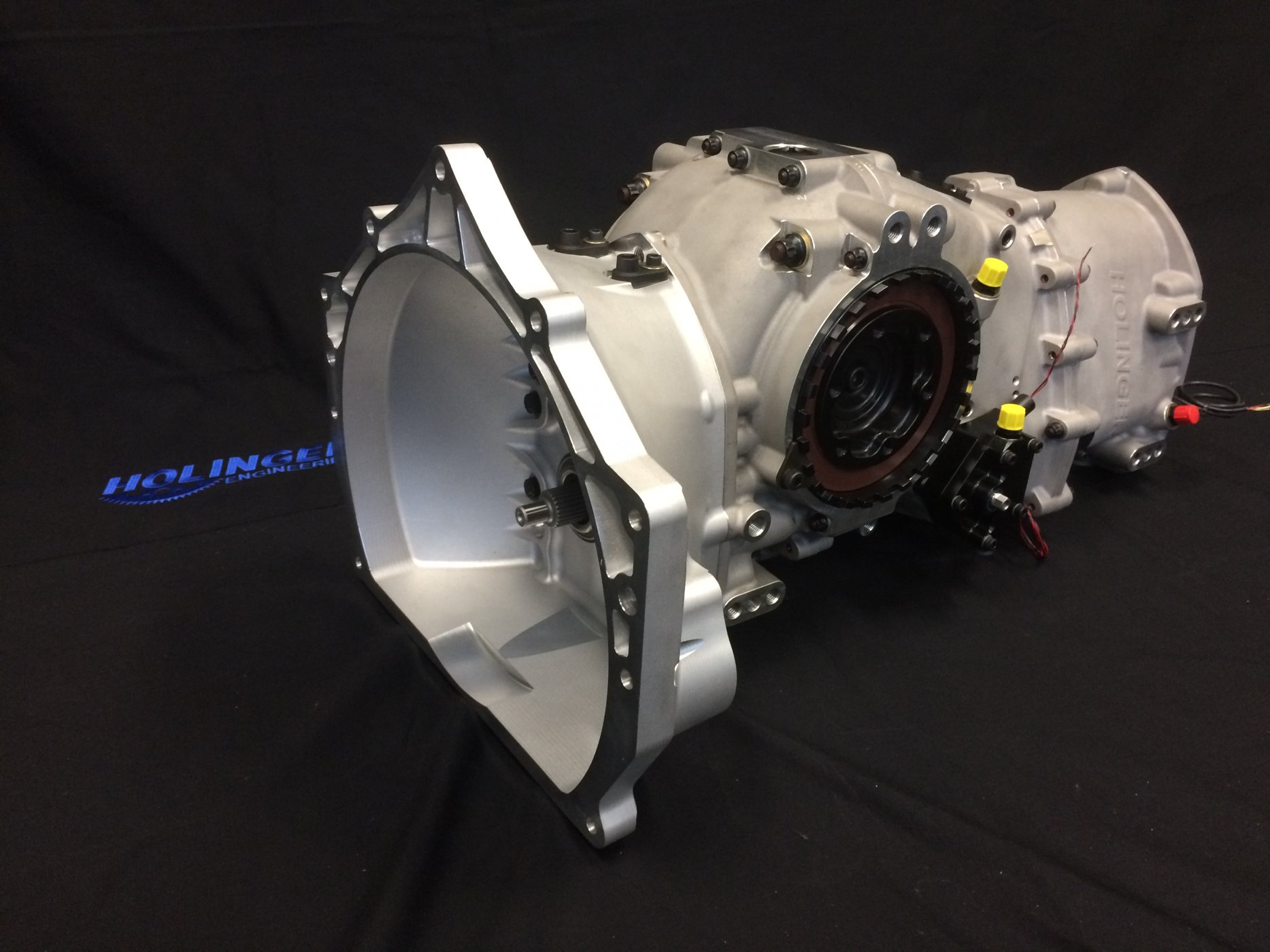

Isn't this what we might need? Same internals but is configured for a car like a GT40. What do you get for the $30K............just the basic GRBX I bet.

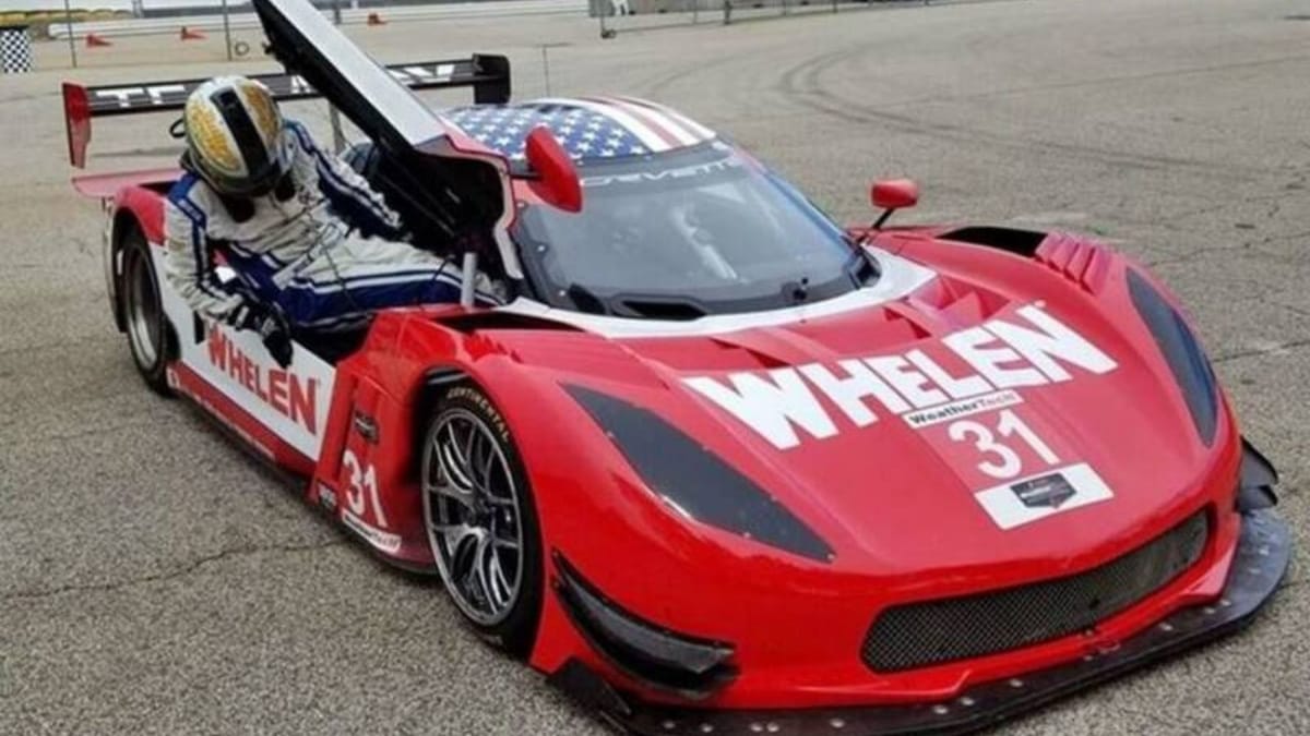

Or you can just buy this. There are also a LOT of equally quick, used LMP3 prototypes for sale for a lot less and equal to what it would take to build a modern equipped GT40 in the $100-200K range.
