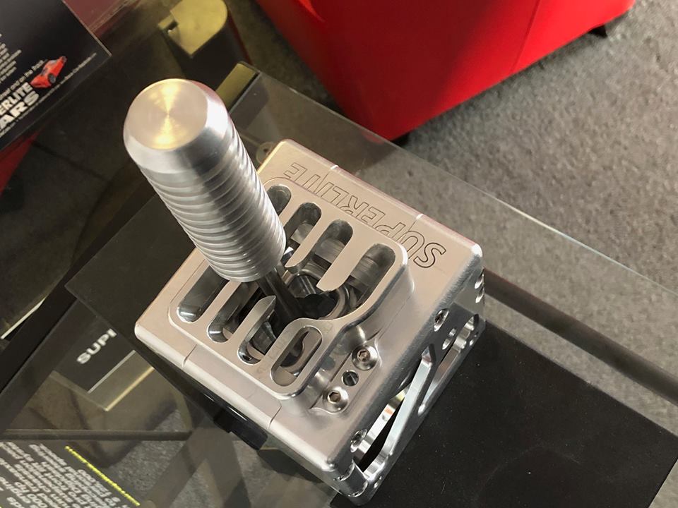

H I forgot to ask is the flat surface on the center console in the shifter area big enough for the new gated shifter that comes with the new GTR kits
