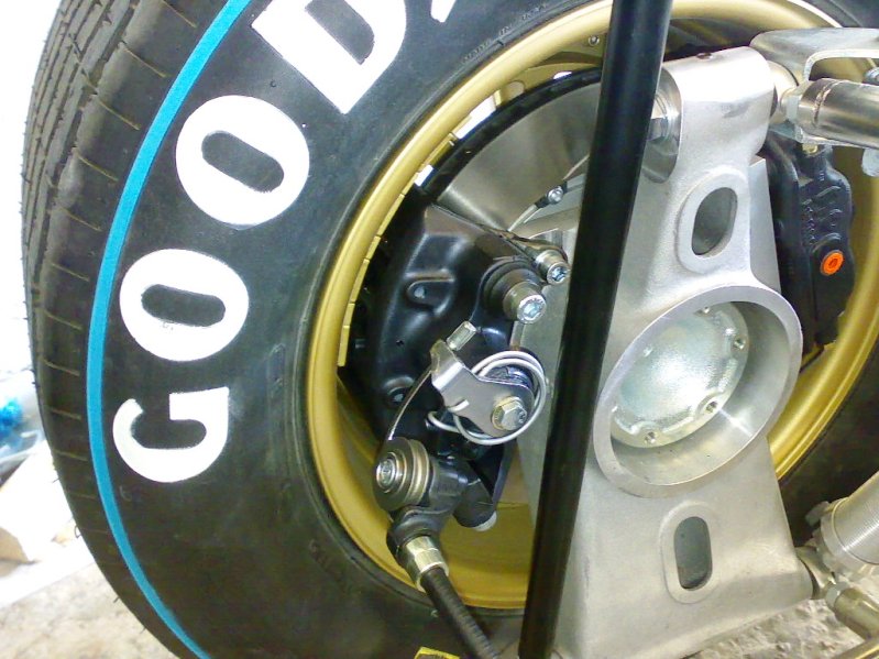

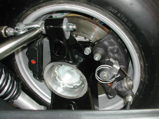

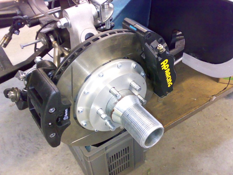

Hi Mark,
This might be what you are looking for.
The non-mounted caliper is mine and that one is off a Ferrari 360. I'm quite sure this is what MDA used for their factory builds...
Cheers,
Mattias
