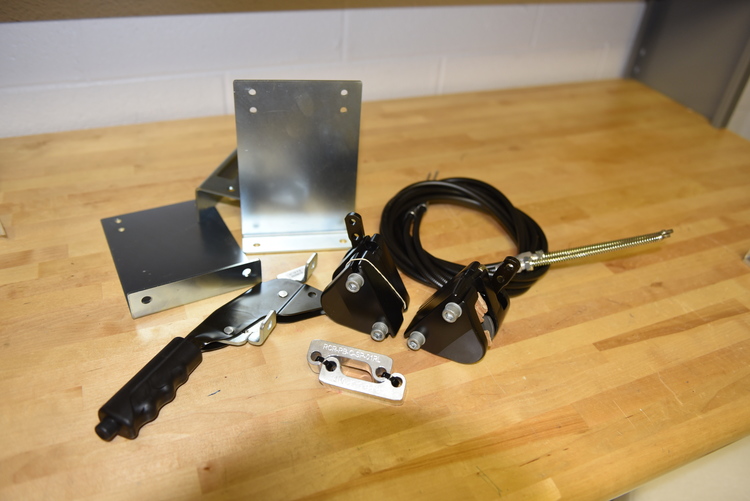

I have been asked to finish off an rcr40 and have stumbled across a slight problem. I'm getting the car to a road legal standard and it will need to go through an IVA test to do so and will obviously require a handbrake/parking brake setup of some sort. I'm struggling to find any info on what RCR supply in their handbrake optional extra and the only calipers i can find that will fit over the 30mm (1.18") wide discs are wilwoods electric parking brake caliper of which I'm reluctant to use as its not very authentic. so, my question to you is. What setups are you running if not what RCR supply? and what is used in the RCR handbrake optional extra?

This is the rcr photo
