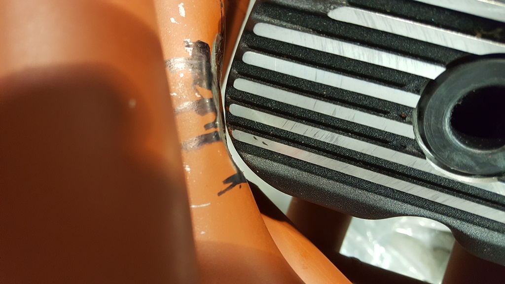

I need to dimple the #1 header tube (bundle of snakes) to clear the rear of the passenger side valve cover on my Roush 427SR. Any suggestions what to use to apply a gentle dimple/depression in the tube at the valve cover?

If you have the Windsor "FE" style covers from Roush you must dimple the header to clear the corner. A large (2" plus") socket and a mallet will be one way. You will want to put the side that does not get dimpled on a sandbag to prevent damage to the ceramic coating and denting it.

Thanks for that suggestion. My friend and I spent a couple of hours banging gently on it last night. We used a 1-1/4" socket and a sandbag behind it. It's very close to what I want now - just need to mock it up with a gasket and double-check the clearance before sending it off to coating.

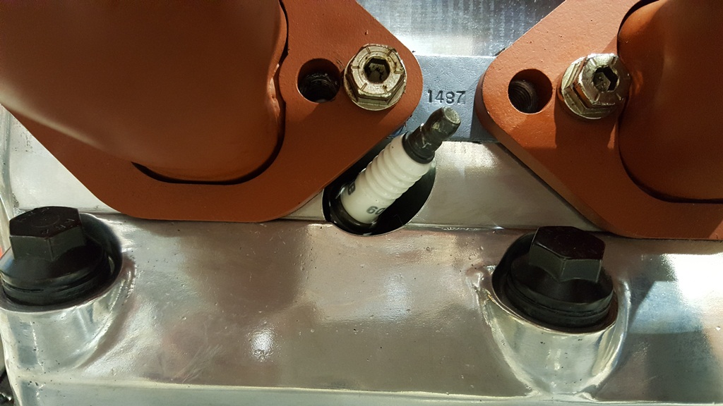

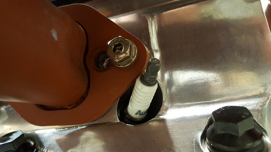

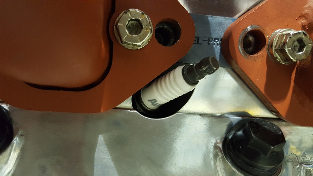

Following up to show clearance on #1 tube and the header flanges and spark plugs. I'll have to cut several of the flange "tabs" and grind smooth before coating.
