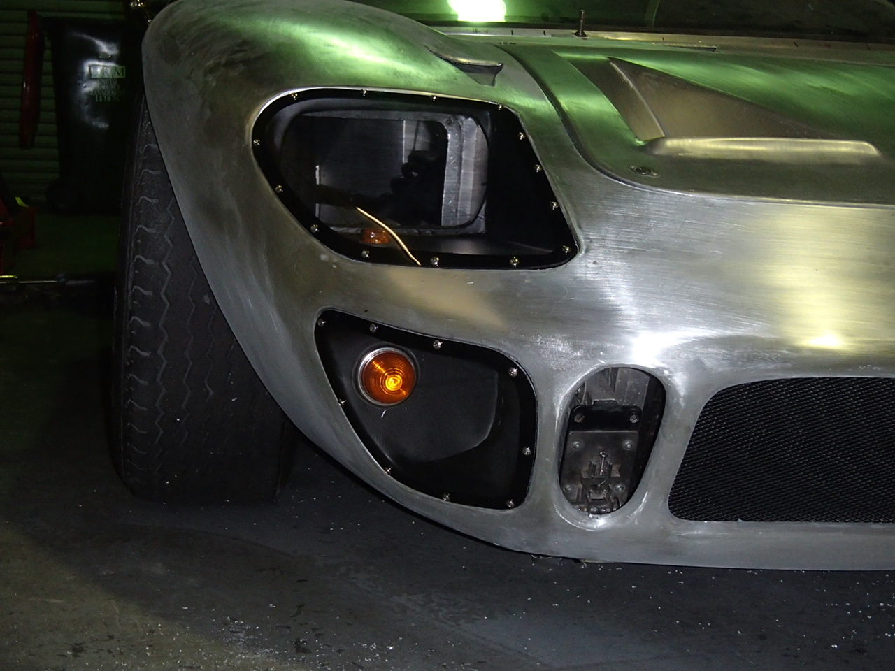

Had to make new covers for the headlamps because the hole spacings didnt suit me for the alloy body.

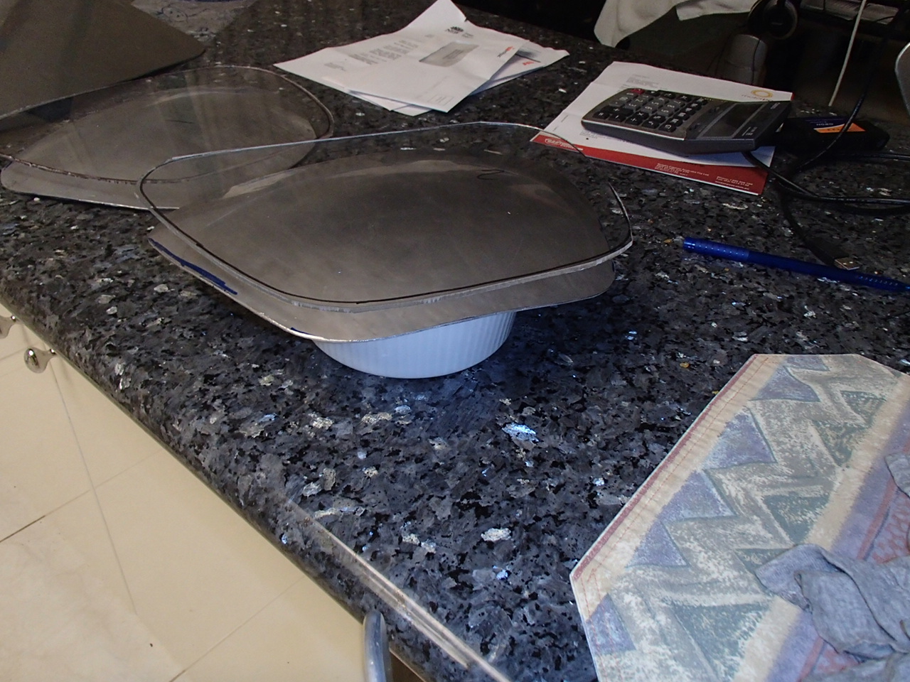

Firstly I made 4 dies they are 1.6 alloy ,I just wheeled them and did some bending and tweaking till they fitted.
This is a shot of one lower lamp cover die.

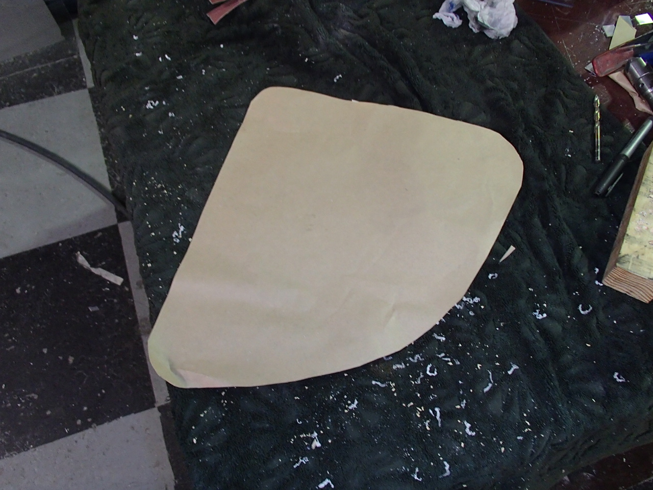

As the dies are radiused you need a pattern, I just use paper this gives a true indication of the correct shape to cut out.
I only made them about 5 mm larger as to much is your enemy , bit like shaping metal.

I tried this with a hot air gun it does not work well as the heat is isolated.
I used the oven at home on 250, I preheated for about 15 minutes.
The sheet came with a plastic film on it you need to leave this on as it stops any imprinting of your die.
I poped the die and the plastic in and I just watched it till it started to slump , when I felt it was time I just pulled it out and applied very light pressure so it would sit on the outside edges.

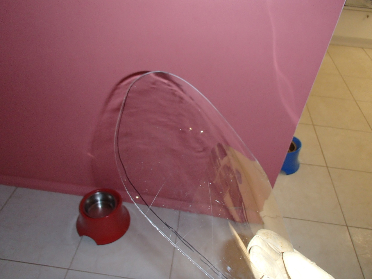

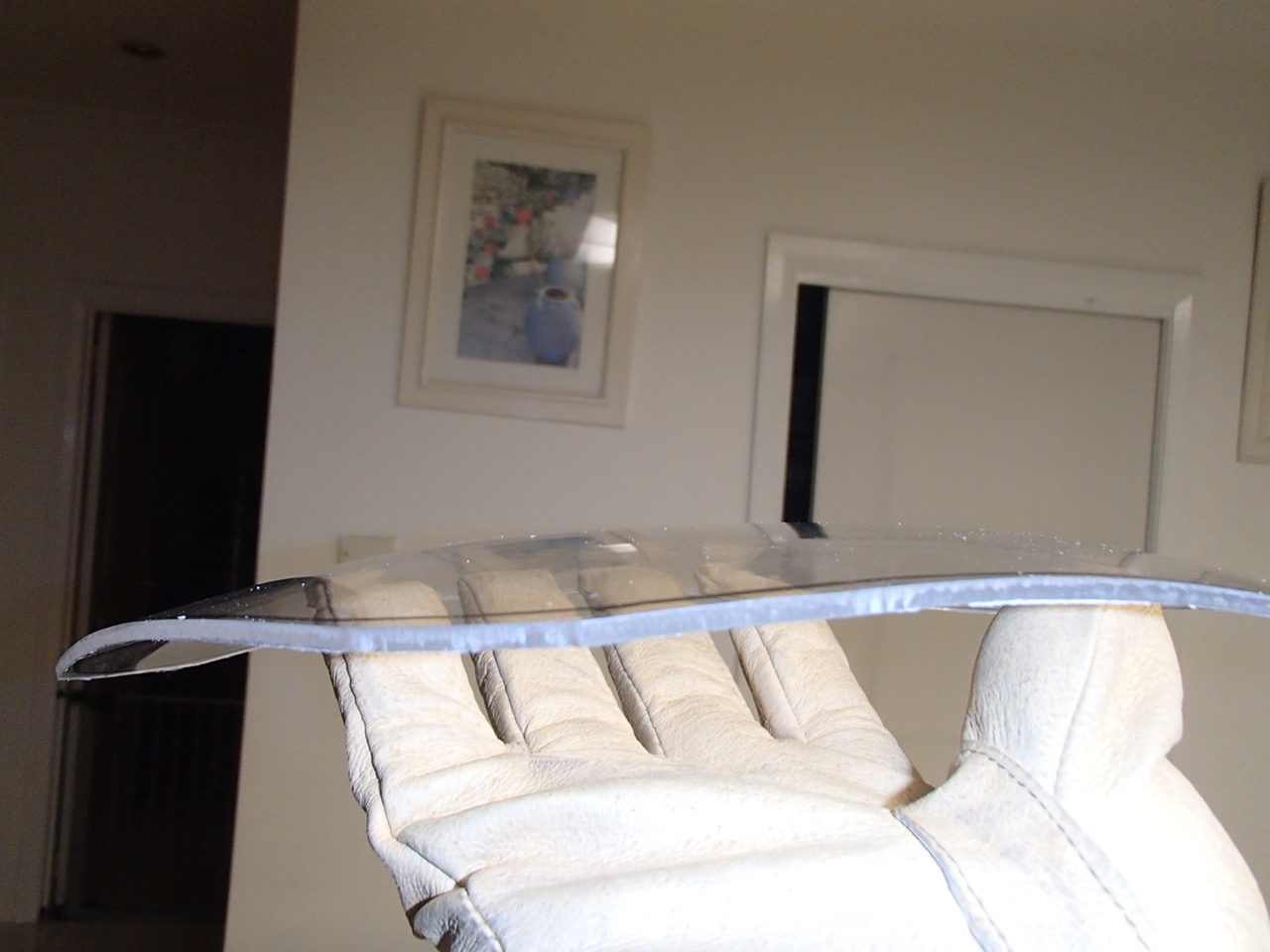

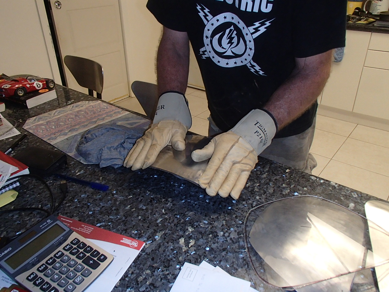

The last pic is a headlamp cover the photo is of the top corner ,it will not slump under its own weight ,when I pulled it from the oven I put a towel on the R/H side and with a gloved hand kept pressure on it till it started to cool.
All these where test pieces made out of scrap, once I had it worked out I made another set.

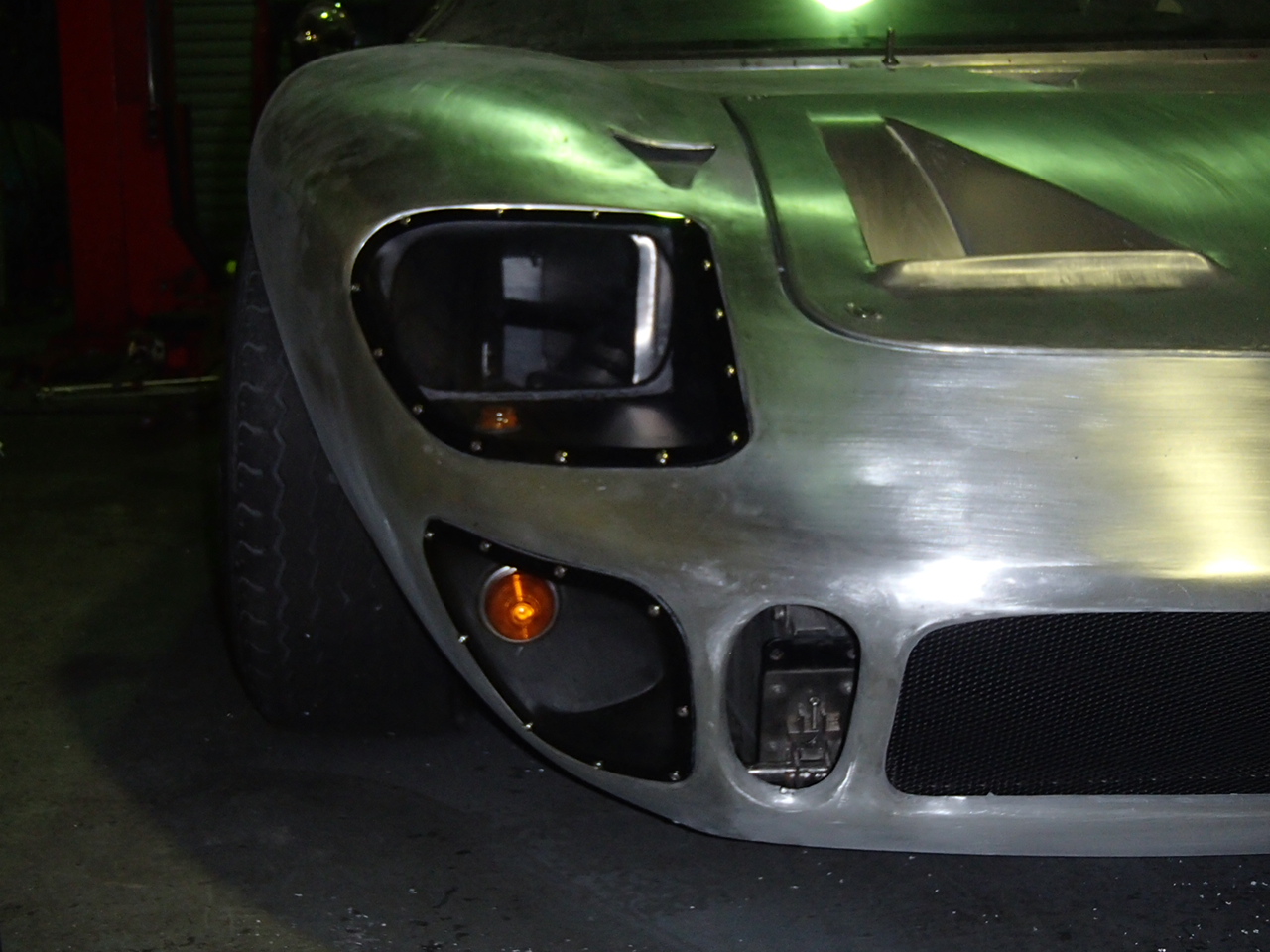

End result
Hope this is useful to those who want to give it a go
Jim

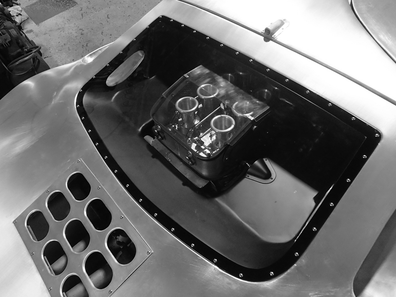

Thanks guys.

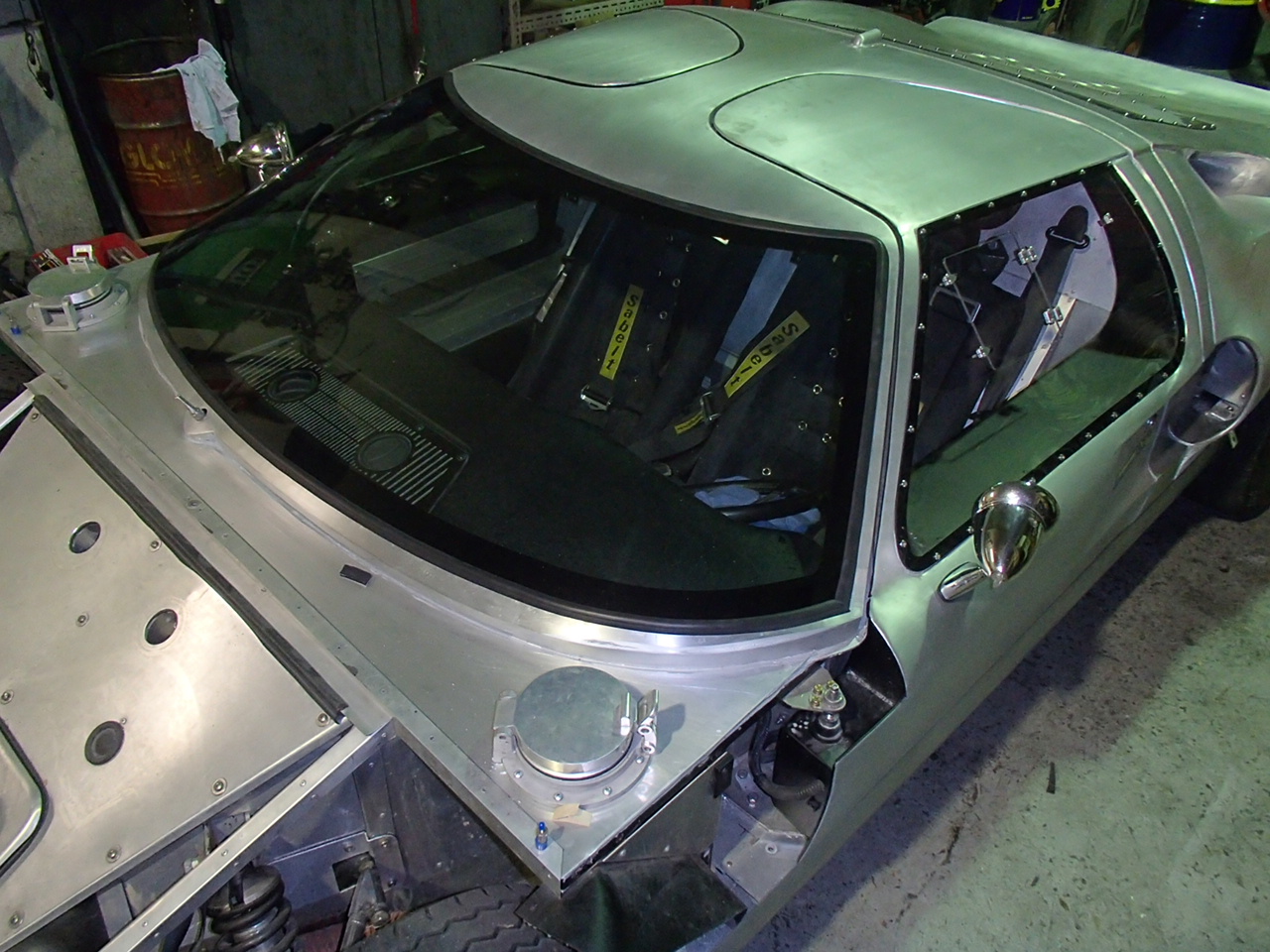

Already done Dave, I made them and the rear screen out of no scratch polycarbonate, very expensive.

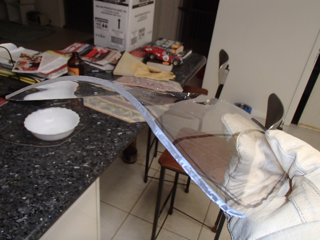

Its indestructible but I found it hard to get it to slump ,The PVC is similar in nature where you can bend it over on itself and it does not break like acrylic.

The PVC had similar flex properties to the poli in that you can roll it into a curcle and it does not snap, safer if you nail someone.
