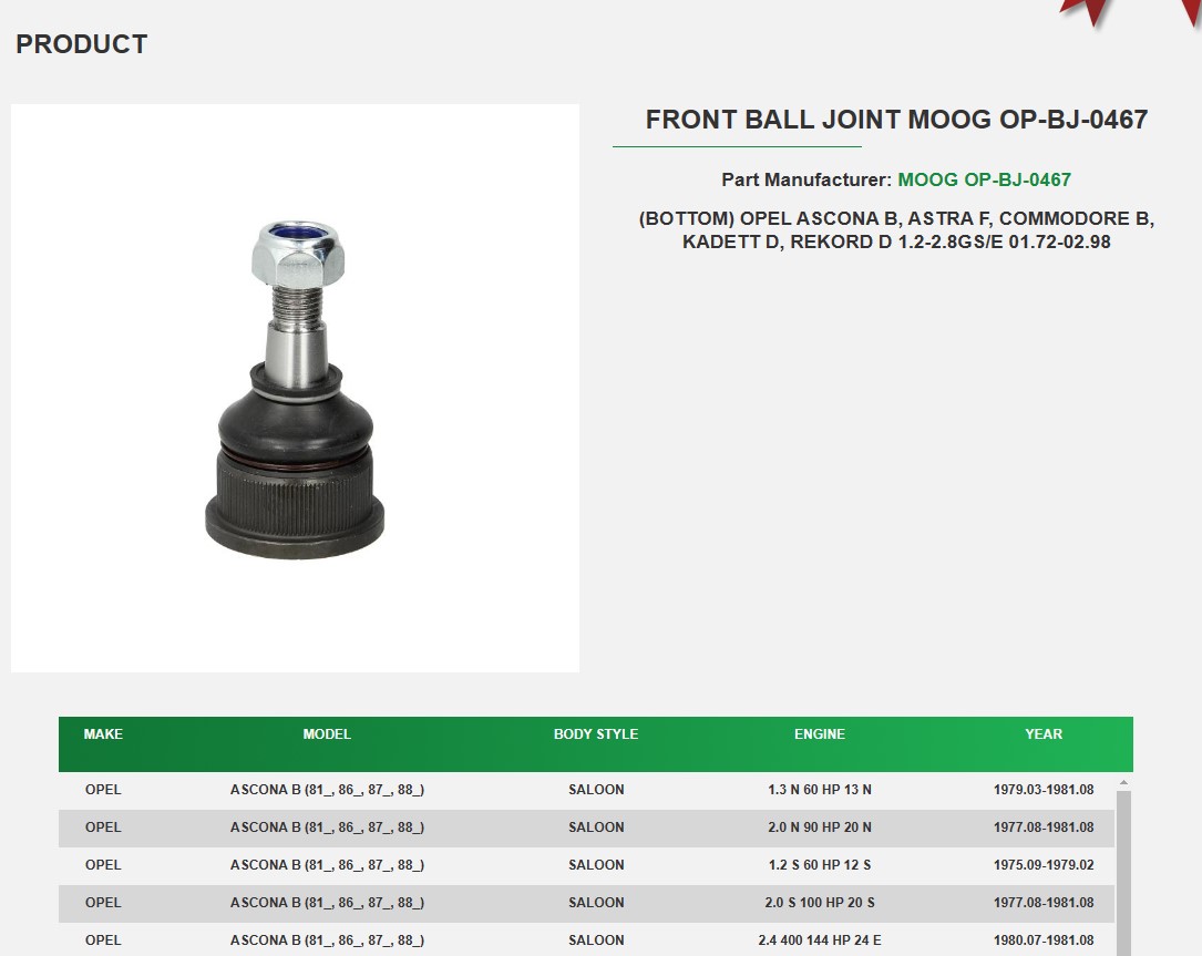

Hi Karl,
There are lots of "close but no cigar" ball joints out there. Wikipedia does not show any Opel or Vauxhaul cars (rear wheel drive platform) that use this ball joint imported to the states through GM, might explain the situation. Opel GT, a favorite car of mine, used the smaller ball joints...
I'm not sure if the European Moog part number is even listed on US parts or cross reference lists. It's nice to buy local but if there's none here the shipping isn't too bad coming from the UK or EU.
