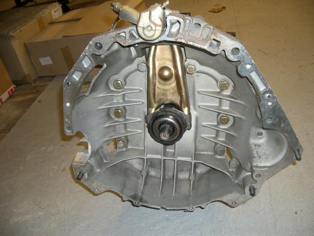

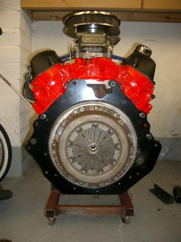

You didn't state which bellhousing/engine combo you are using but if it's an R30 bellhousing connected to a 302, these pictures of the two pieces separated may help.
Without seeing it it's difficult to advise why they are not separating, but double-double check you have'nt left any connecting bolts in the bellhousing. The adapter plate stays bolted to the engine block.
Also try giving the box a good 'wiggle' by hand. hope this helps!

As shown in the pictures provided by Julian the transaxle is also attached to the bellhousing on the inside.
If you have the purpose made bell, (not the R30 bell shown in the pics), you will need to remove the engine for adequate clearance to be able remove the transaxle as a separate component.
