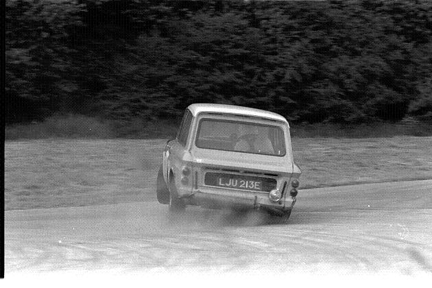

I don't have any answers to your questions, but since the subjects of Imps, and Curburough (MikeP) came up, and also Doune which is not far from me;
Many years ago I used to help a friend of mine with his Imp, also 1l wills rings and Webers etc, which we had a lot of fun with. Here is a pic, a long time ago at Curborough where he didn't realise until the last moment that he needed to go left after the start, not straight on. After this, he suffered a total loss of control, and ended up on the grass heading for the trees. I thought it was hilarious anyway:laugh: .
Graham, I watched your awesome video of the Imp at Doune, and see that you must be truly dedicated to want to go even faster:shocked:.
