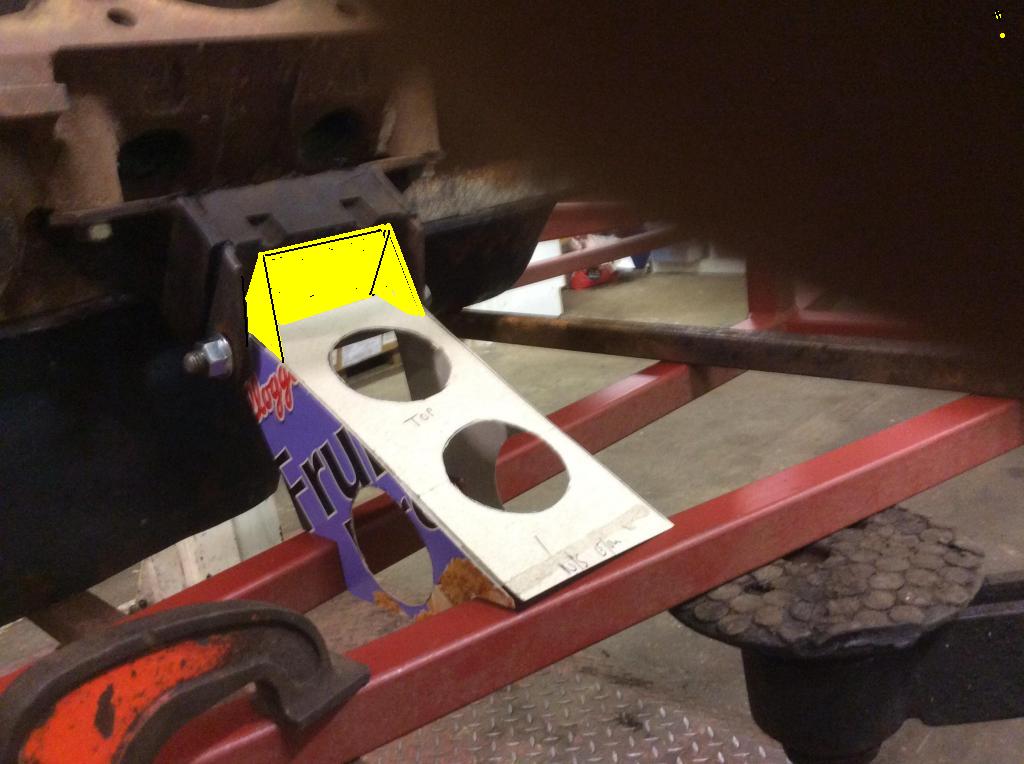

Just templating the engine mounts at the moment.

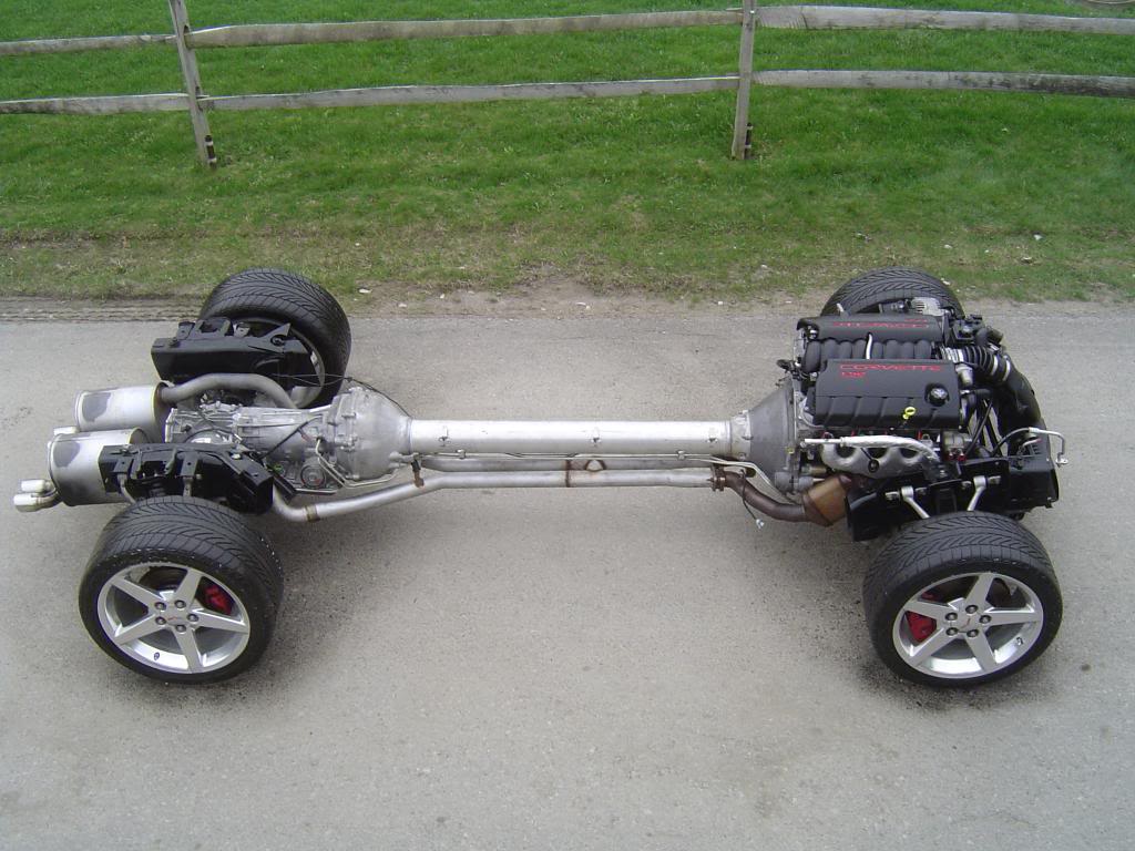

Thinking a bit outside the box, but what about something like a Corvette transaxle and torque tube arrangement? Trans in the back, only the torque tube running down the centre. Easy adapter made, just for the front end of the tube.

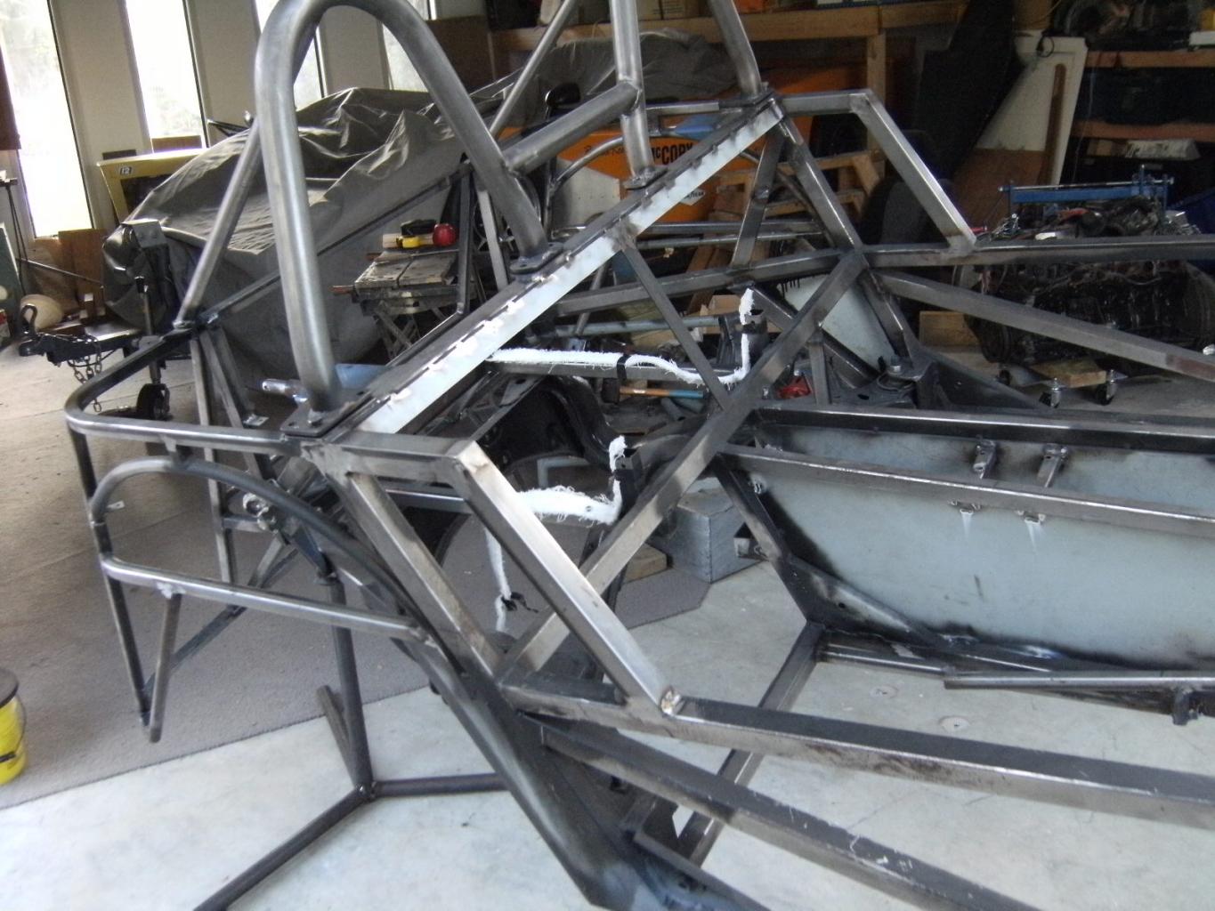

Just a bit of chassis rework, just forward of the diff frame.

Nice thought but I could not bring myself to wreck a vet to build something as primitive as this :evil:. The stumbling block for a transaxle on this type of chassis is the seating position . The back of the seat is virtually against the rear halfshafts so you are sat between the tunnel and the wheel, there is no room for a fat transaxle in fact its quite tight for a prop in the tunnel. The seats are 420mm wide which is a challenge for me and I am having to have some specials made :thumbsdown:. I have managed to keep all the mechanical s within the original spec Haynes chassis to try and keep its proportion.

One mod you might want to make to the chassis, you see where the front upper wishbone mount hangs off the back of the chassis member, these have been known to break off, it needs some reinforcement behind the outrigged part.
And obviously you are still going to add diagionals in the frame opposite the engine?

I thought when I posted this thing up I was going to get banned from the forum :laugh: I read about the suspension lugs being a bit suspect Fred so I built the chassis using 2mm thick box instead of that paper thin stuff the Locost builders use. All the key suspension brackets will get a gusset for added strength. The BMW diff is a bit of a gem , loads of different ratios available , comes with a LSD and a speed transducer in the back which is handy because the Getrag box has no speedo drive. Also has the 108mm flanges on as standard which match the cosworth rear hubs I have. It also has top ,rear and front mounting lugs which is a plus.

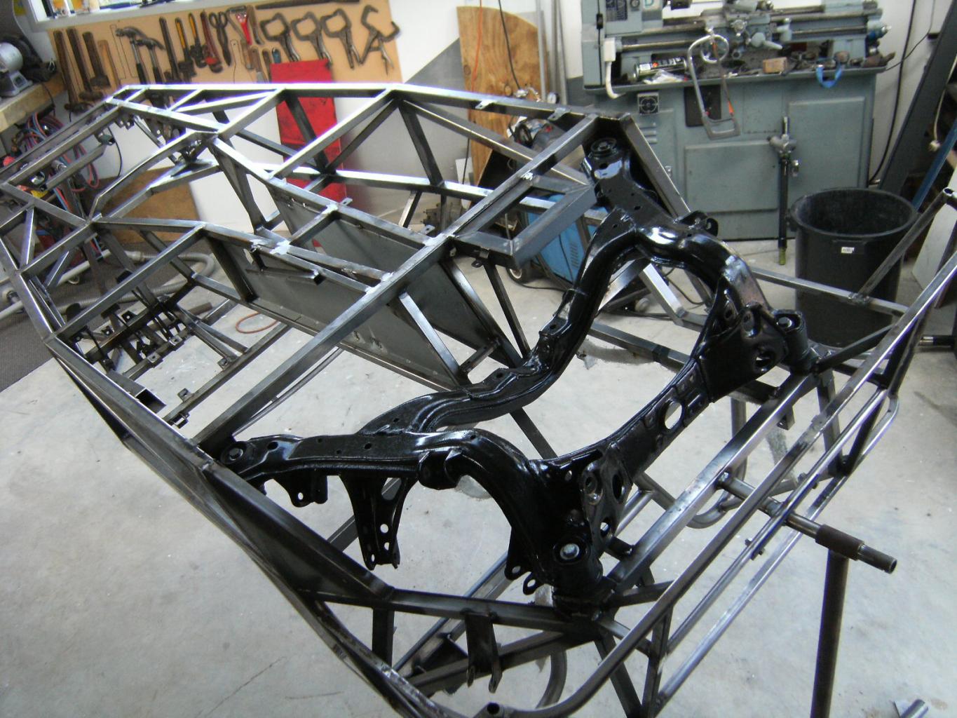

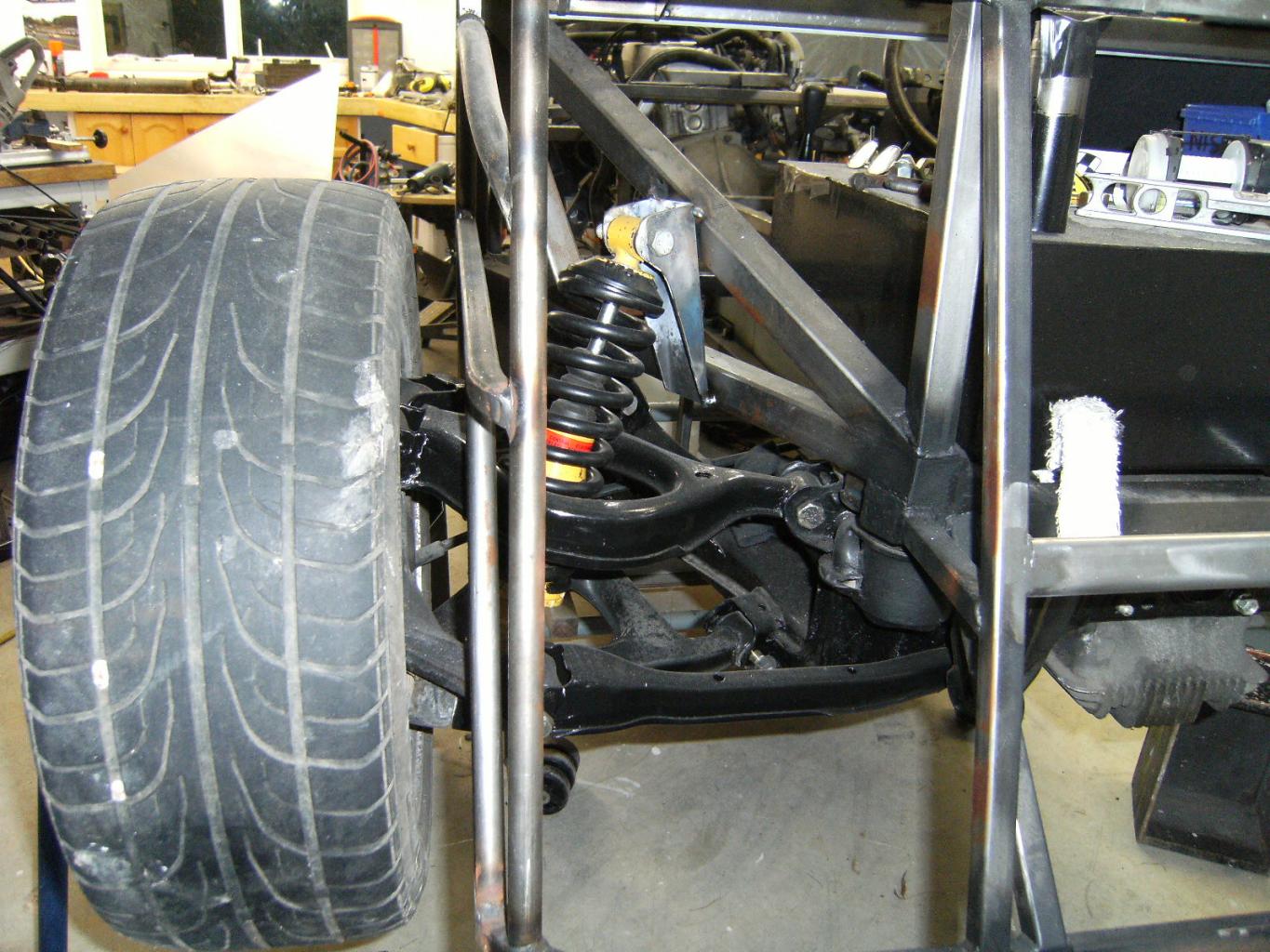

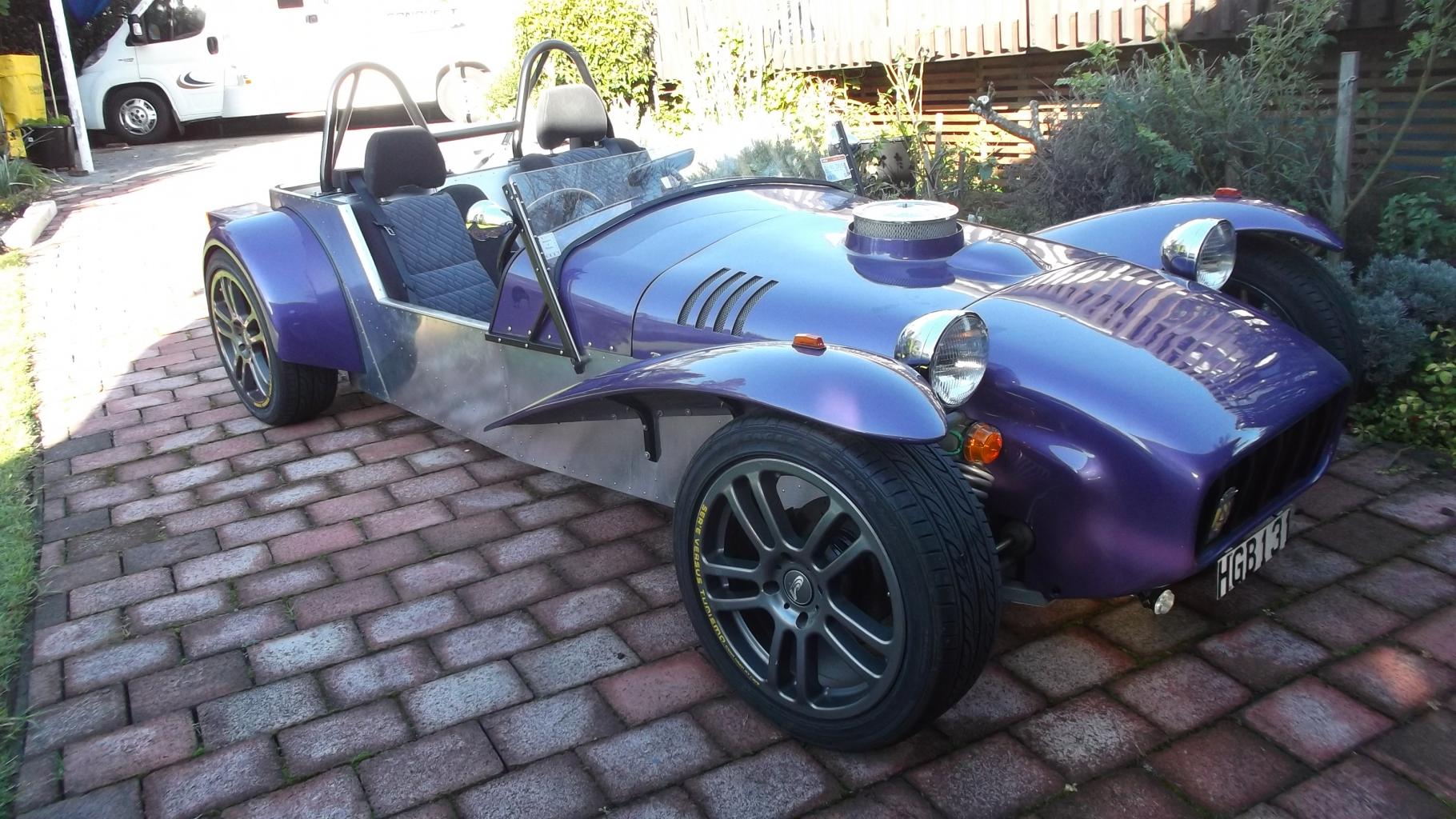

I realize that you already have the rear of the chassis already constructed how ever here is a variation that makes on road certification even easier because standard components are being used. I ended up using a Nissan Sylvia S14 rear sub frame complete, I had planned on fitting the chassis to the various arms and thought `why` its already job done. Admittedly my take on a seven is really an `8` because it runs a stock Rover v8 and its 10% wider. As you can see from the photos, I have tried hard at keeping proportions so that it does not look strange...just on steroids.
The stock Rover on a 2 barrel Holley has so much torque that you can almost drive it as an auto, even in over drive. I built this one for my wife and its is very docile and does not bite, so she is happy particularly as it sounds like a grunty V8. The gear box is from a 3ltr Nissan and handles it fine.

What a cracking job you have made of that Russel, I know what you mean about the rover lumps because I had a drive of a friends westy V8, twas fun to say the least:stunned:. Kaspa thanks for the heads up on the under bonnet temperatures I will give that a bit of thought.

Hope your going to add a flat plate such as the one Ive added to your photo, this plate should carry the engine weight, not the bolt that goes thru the mount.

I have used the same method and mount as the GTD uses Mac , the profiles wrap round a tube spacer. On reflection that added profile will give more support so I will include it, Thanks.
Bob

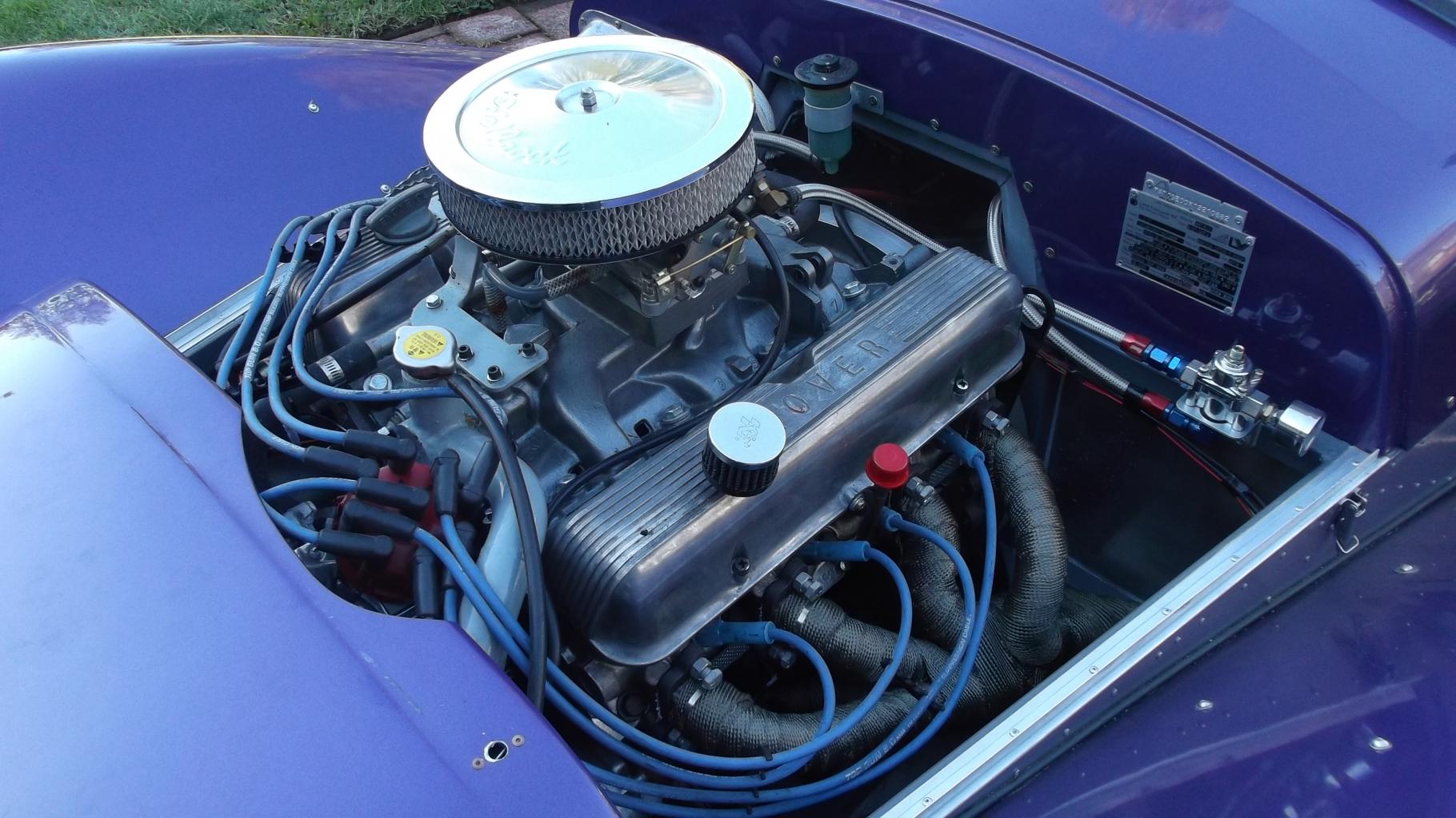

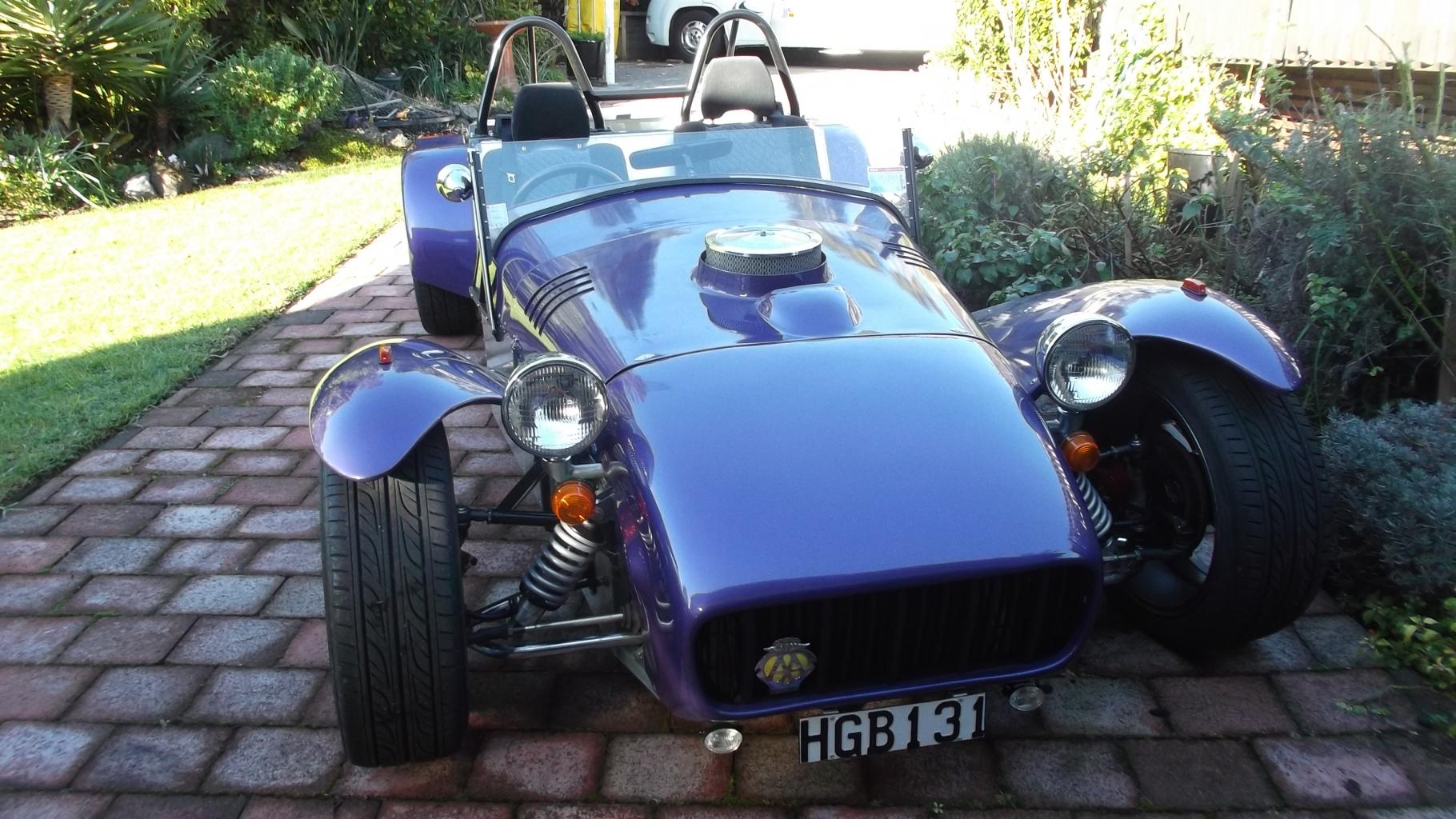

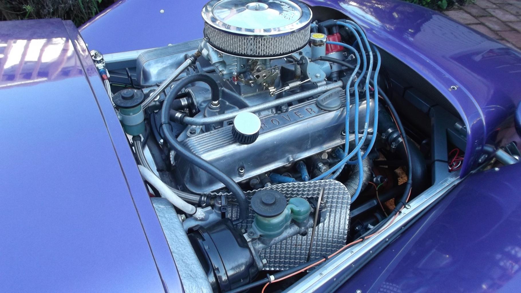

Hi there
Seeing that you are putting a V8 into your cars, I thought I would share with you my version, I have built it for my wife so choice of colour and some details like guards, I had no choice on. It also very quiet so its a bit of a wolf! running a Stock Rover 3.5 ltr with a 2 barrel Holley carb , its very tractable and will pull from almost a standstill even in over drive. The gearbox is a 3ltr Nissan box originally from a Holden and the rear end is a complete Nissan Sylvia S14 subframe with a 4.2 ration LSD. The car may be quiet but it can sure growl when you stand on it, overall its very nice to drive with no grab and snatch... it just purrs.
The car is fully certified and registered on the road and is a pleasure to drive, had it out this morning when it was only 5 deg, bloody cold on the face....bikers must be brave!
The motor is a bit of a storey...bought it as spares for $84.00 including the starter motor( that's all I was looking for) and its absolutely mint, almost brand new and starts like a dream every time.
The dimensions are about 10% bigger all round and the carb is just grafted onto a stock Rover inlet manifold with the SU carbs chopped off.
Enjoy your build.
Russell

Thanks for posting up the pictures Russel, I hope the wife appreciates what you have done there :)
I have noticed the heat shield round the brake servo and the wrap on the exhaust which bolsters Jacks comments about getting the heat away from under the bonnet.
