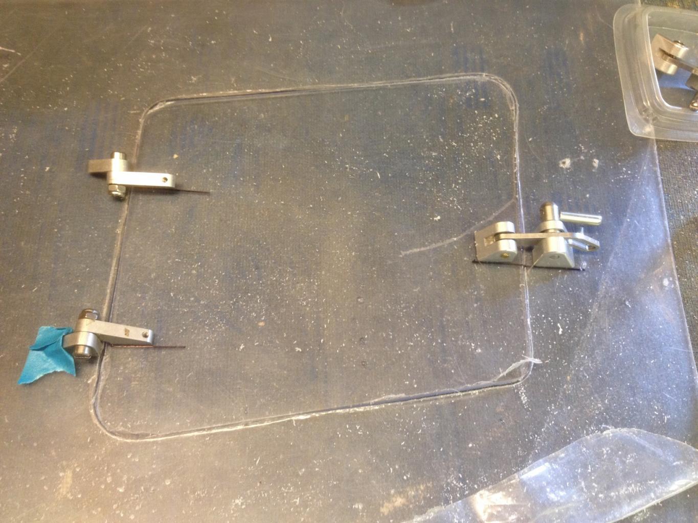

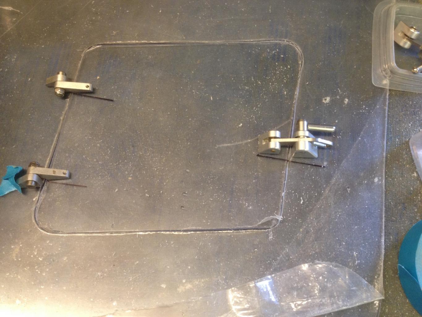

Hi,
Should the hardware for the window run parallel with the cutout as in picture 1, horizontal as in picture 2, or what appears to be a mixture of both as in picture 3.

Hinge pins should be parallel to the opening edge, otherwise it will lock-up (picture 1)
Rgds,
Andy
Thanks Andy, suspected as much wanted to make sure I got at least one thing on the build right first time ;)

Ideally, the hinge pins should be co-linear, that is you should be able to replace their individual pins with a single long one.
