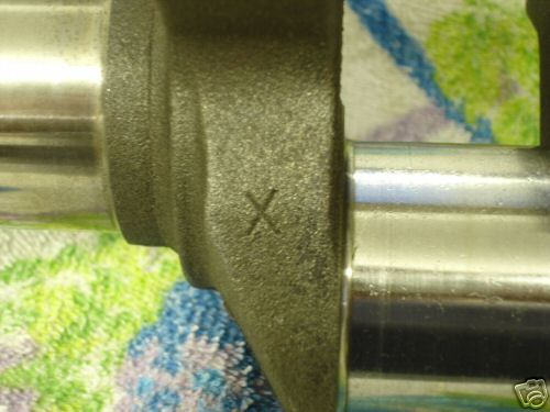

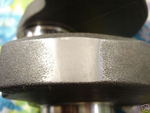

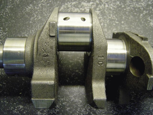

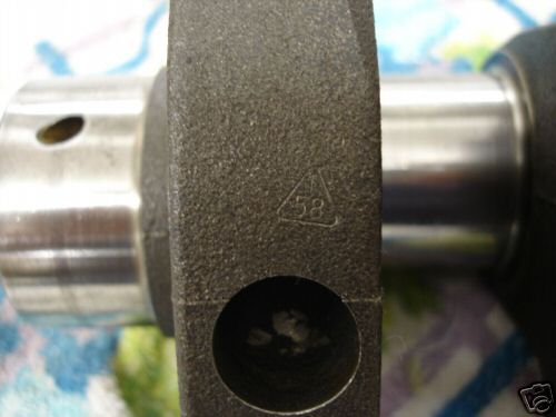

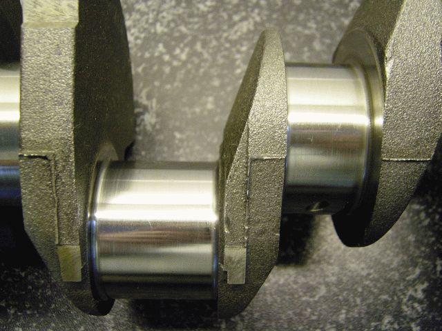

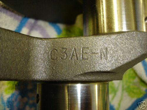

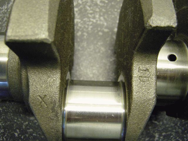

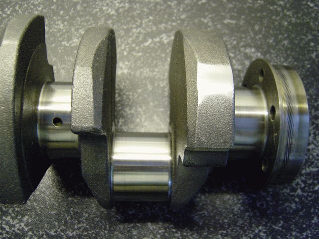

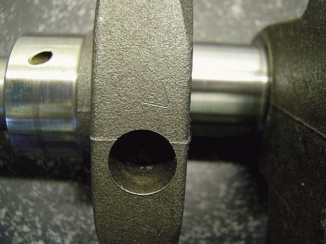

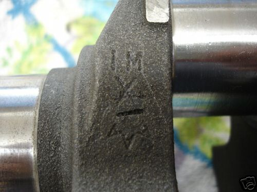

I purchased this NOS crank a while ago and it went down pretty well with the guys on that forum since it apparently has a full set of correct foundry and inspection marks as a true HiPo crankshaft.
In the meantime, I have considered building the HiPo engine a couple of times but hum'd and haw'd and got involved with too many other things. Now my GT40 is progressing well and I am having a clear-out and so thought it best to get the engine assembled to get rid of a few more boxes for some space around here.
Here are a few pictures of the said crank:

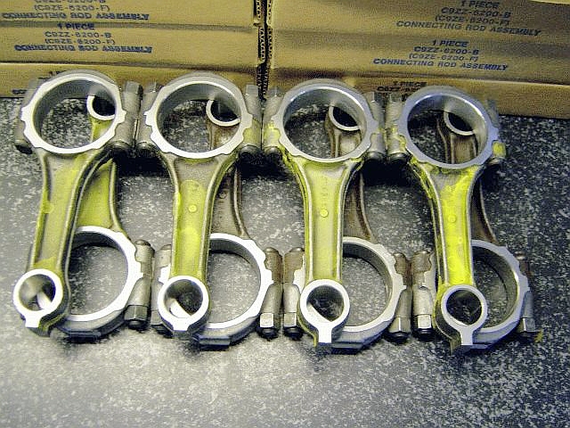

Carefull, the rods shown are 1969 Boss 302, which is a whole other animal than the earlyer "hi-po" 289 engine.........
The 302 Boss rod superceded the HiPo rod as a replacement part. Same length, the Boss piston had the same comp height as a 289, but had a lot better bolt with the oval heads instead of the square HiPo. It meant the bolt seat was spot faced instead of broached.
Possibly slightly heavier but you need a balance job anyway so it doesn't matter. You do get a lot stronger rod.

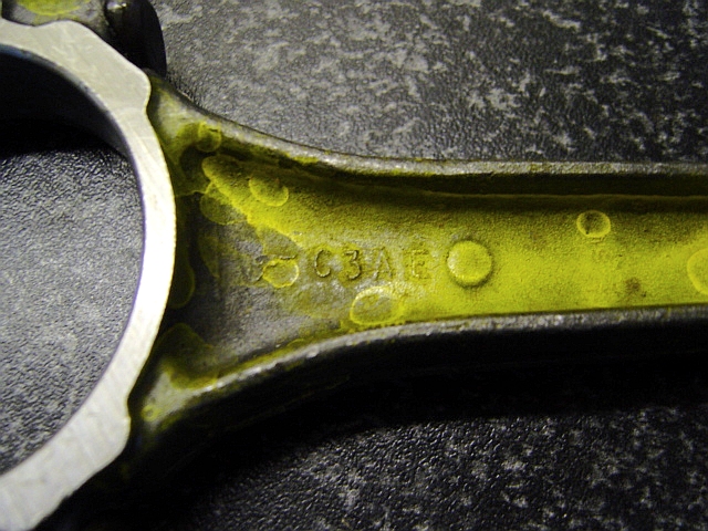

These Rods are C3AE numbered and yellow coded.
HiPo forgings in my opinion with oval headed bolts and they came in Boss boxes?

C9ZZ-6200-B is the same part number for both 289 Hi Po AND Boss 302
All had C3AE some later ones had C3AE-D
And according to the '78 Hollander ( the breakers yards bible ) which I have in front of me, they sold for $51.80 plus tax !
The 302 Boss rod superceded the HiPo rod as a replacement part. Same length, ***** the Boss piston had the same comp height as a 289******, but had a lot better bolt with the oval heads instead of the square HiPo. It meant the bolt seat was spot faced instead of broached.
Quick correction, Boss 302 piston had shorter comp height than 289 HiPo to make up for stroke difference between 289/302..
James, I just happened to be going thru a box of assorted 289/302w rods yesterday in an attempt to bring some order about... amongst the 289 rods( all C3.. 5/16 bolt) I found three different forging/machining shapes around the big end area, no wonder confusion reigns in this area.
