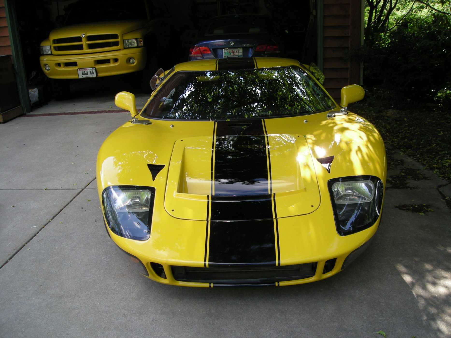

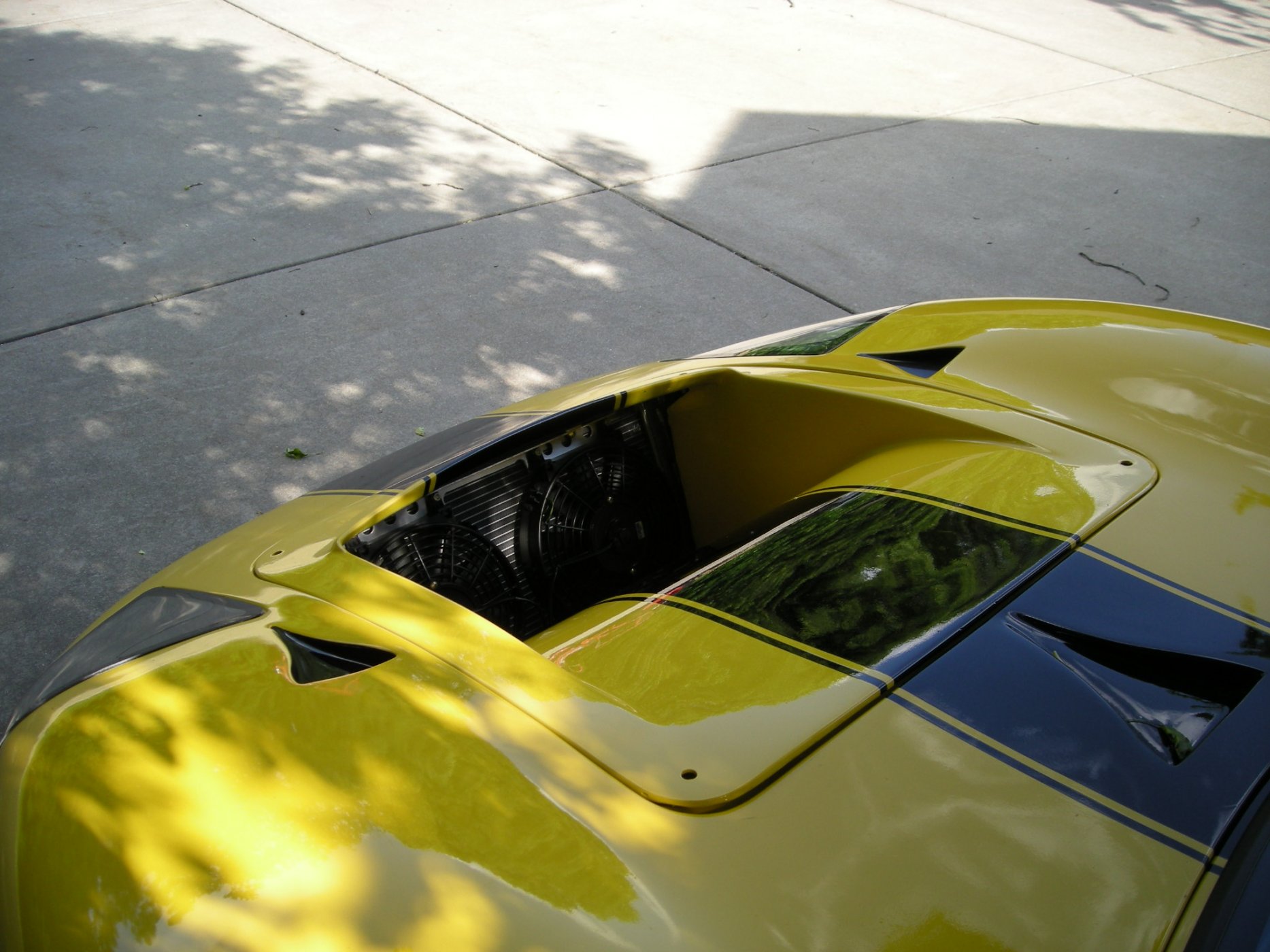

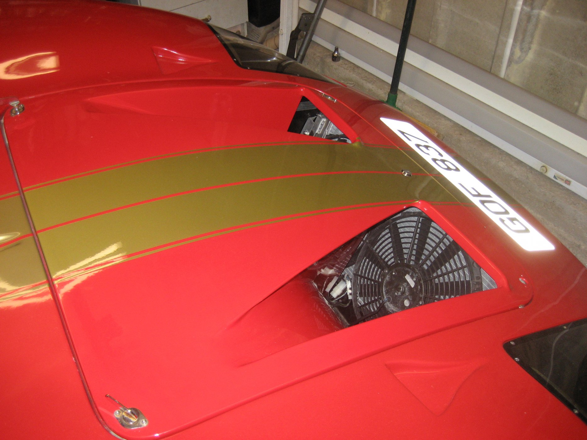

After reading a post the other day I got to thinking, why is my car so hot inside the cabin. At first I was thinking that it is just engine heat coming through the firewall but now think it is a totally different problem. I was looking at the depth of the nostrils and realize that they only go down about half way on the radiator leaving the other half blowing under the bottom of the nostrils. I am thinking this heat that is going under is getting into the cabin. Has anybody had this problem as well? If you look at the picture you will see that I have a scoop on each side that has to have the heat from the radiator pumping out of these scoops and blowing in through the door jams. Do I need these scoops? Do the other cars have them? If I block them off will it give me more problems? I have to tell you that it gets so hot inside it could give you heat stroke. Before you ask, yes the car has a/c and it works, however my face stays cool and the rest of my body is as hot as the engine.

How do you think it is getting in? Do you have the scoops pushing it into the wheel area? I am thinking of doing 2 tests tonight 1. block of the scoop and 2. drive it around without the nostril panel installed.

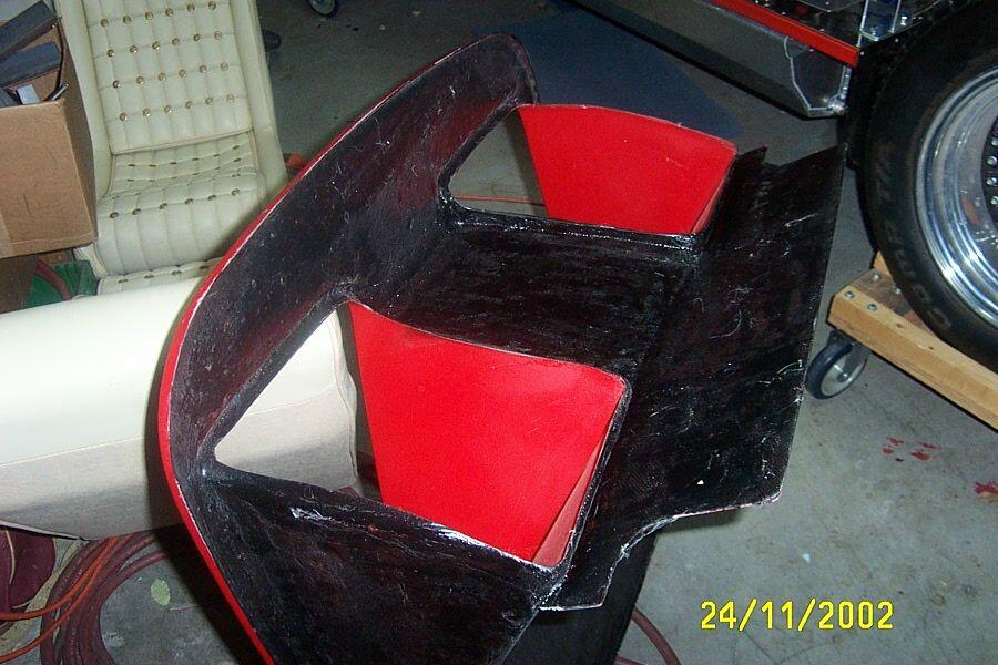

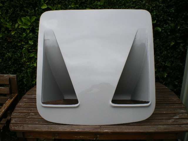

A deep nostril which goes all the way down to the floor will be a big help as it will deflect the hot air upwards and prevent it going into the front bulkhead area. It also has a beneficial effect on the amount of lift at the front of the car at speed. I noticed that with the half height nostril the whole panel was lifting as the air pressure built up under it. This high pressure will force hot air through any holes in the bulkhead and heat the cabin. With the deep nostril panel the front of the car is much more stable and the panel is pushed down rather than lifting. The triangular wedge in the centre of the nostril panel can be panelled in and used for a bit of extra storage.
Keep the top surface of the nostril panel and cut off the half height bit underneath. Bond on the deep panel with fibreglass and smooth with filler. Trim to fit round water pipes etc. It will need to be painted but at least the top surface will still be OK. Lee Dawson can make you a deep nostril panel.

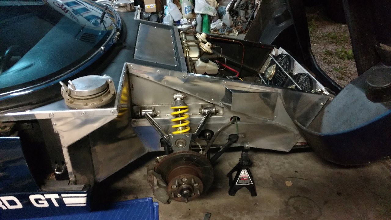

You don`t need to buy a deep panel, just make a panel to fill the gap from the bottom of the rad to meet the bottom of the panel you already have and stop air going under and around edges. The deep panels you sometimes see were as far as I remember a GTD invention and not something I ever saw on original cars. The extended part on my car is fixed to the chassis and does not lift out. good luck.

My daughter will upload my pics. Poor photos so hard to see any details but its just folded aluminium painted black with foam and rubber around edges to seal it. First chance we get she will do it for me. I built it before the internet was here so bear with me.

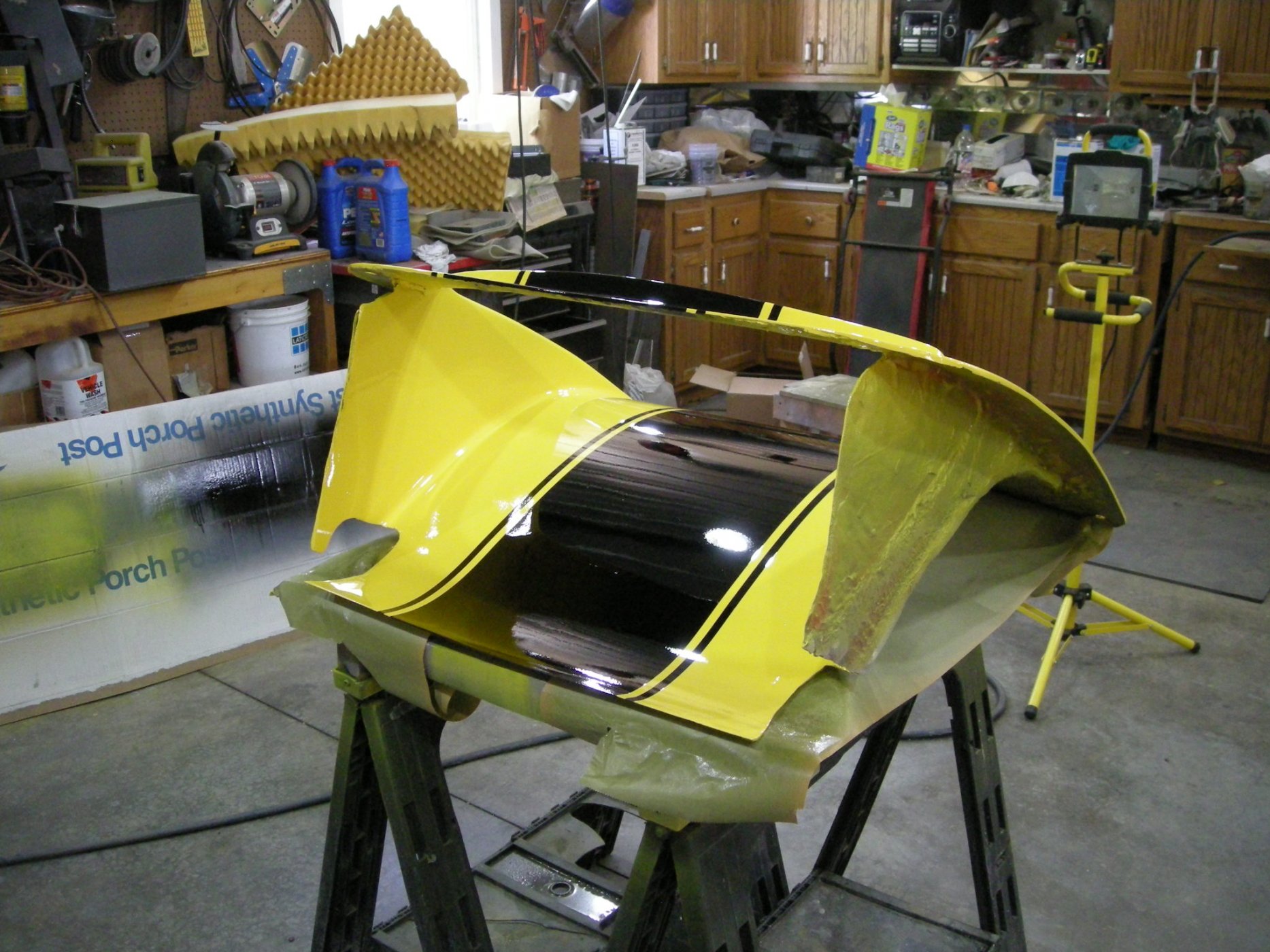

That looks really nice, I have to go with the bottom section only in hopes of saving my paint. I was looking at my panel last night and wasn't sure how the insert could be cut in back where the nostril is almost flush with the top of the panel but now I see that it is cut across before it gets to that area. Do you have a picture of the insert only? (where it meets the top panel) I got your e-mail response this morning I will be in contact with you later today.

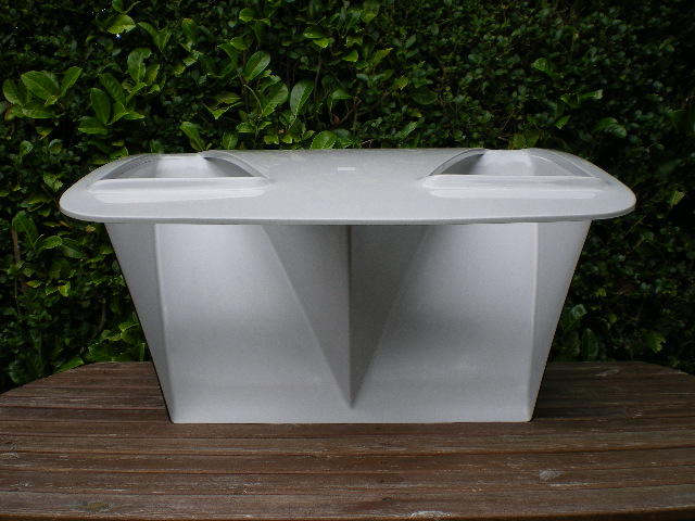

Hello All,
I make a replacement twin deep vent nostril panel for the GTD. I also make a single deep vent panel.
the vents are tapered at the bottom to fit inside the radiator inlet and outlet pipes.
I can supply the whole panel or just the bottom section so you can modify your own panel yourself.

Dan , I had the same problem with my GTD I went to the single nostril and modified it to cover the entire radiator, it really helped. My car did not have the side scoops you show on yours so I'm unfamiliar with what they do.
