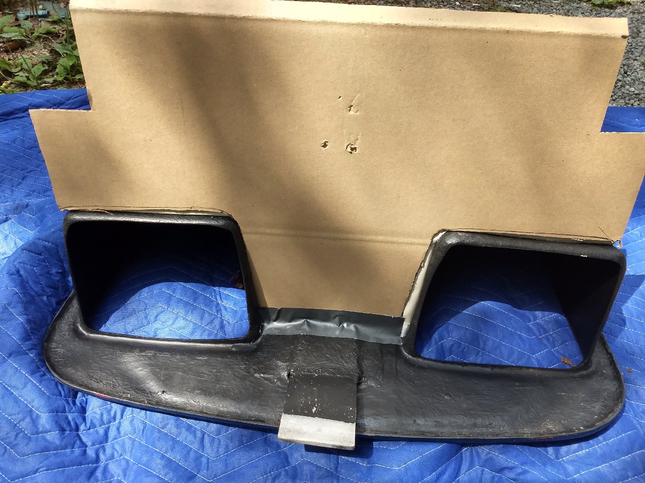

On Sunday I had a few friends over everyone working on their cars so I got to building (don't laugh) a cardboard wall below the nostrils to deflect the air up and out and to see if the problem would be resolved inside the cabin. The result was astounding, The cabin temperature dropped about 90%. The inside of the cabin with the ac on got cold almost immediately and completely comfortable. The scoops inside the wheelwell no longer had flow blowing into the door jams. The increase in flow out the nostrils was blowing air to the top of the windshield and over the roof. I can't wait to get the insert from Lee to do the job right. I ordered the bottom panel from him on Sunday. Here is a pick of my handiwork LOL

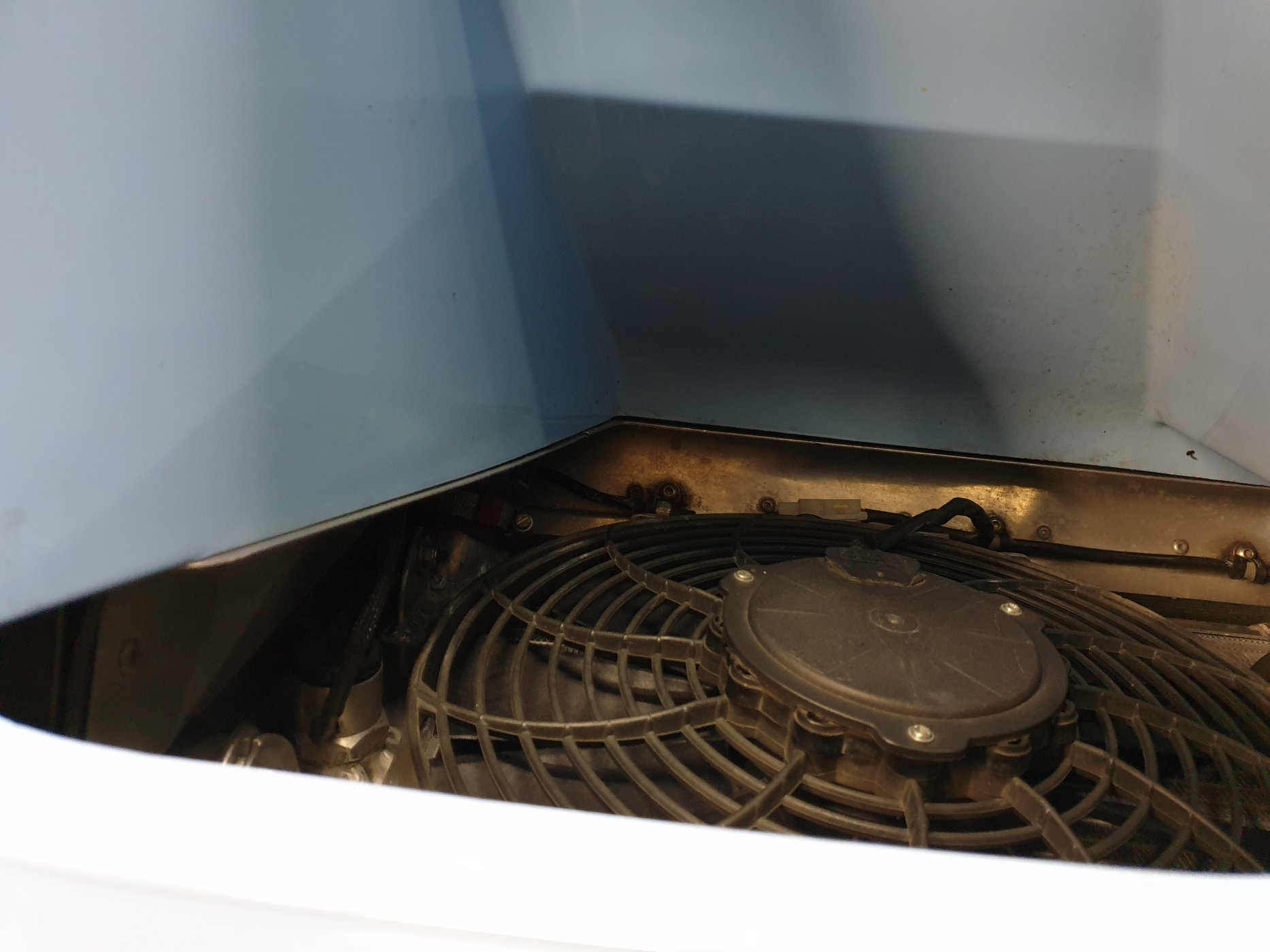

You will be happy when you get the full deep nostril fitted as you will be much cooler and it really does help with front lift at speed. Lee makes really good panels. If you want detail pics of my deep nostril just let me know.

On Sunday I had a few friends over everyone working on their cars so I got to building (don't laugh) a cardboard wall below the nostrils to deflect the air up and out and to see if the problem would be resolved inside the cabin. The result was astounding, The cabin temperature dropped about 90%. The inside of the cabin with the ac on got cold almost immediately and completely comfortable. The scoops inside the wheelwell no longer had flow blowing into the door jams. The increase in flow out the nostrils was blowing air to the top of the windshield and over the roof. I can't wait to get the insert from Lee to do the job right. I ordered the bottom panel from him on Sunday. Here is a pick of my handiwork LOLView attachment 100693

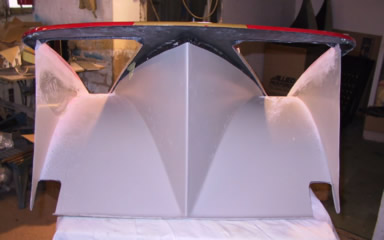

Reminds me of the double-nostril panel that came with my RCR. I cut it up and deepened it all the way to the floor behind the radiator. Took a fair bit of work, but no one was offering any solutions back then.

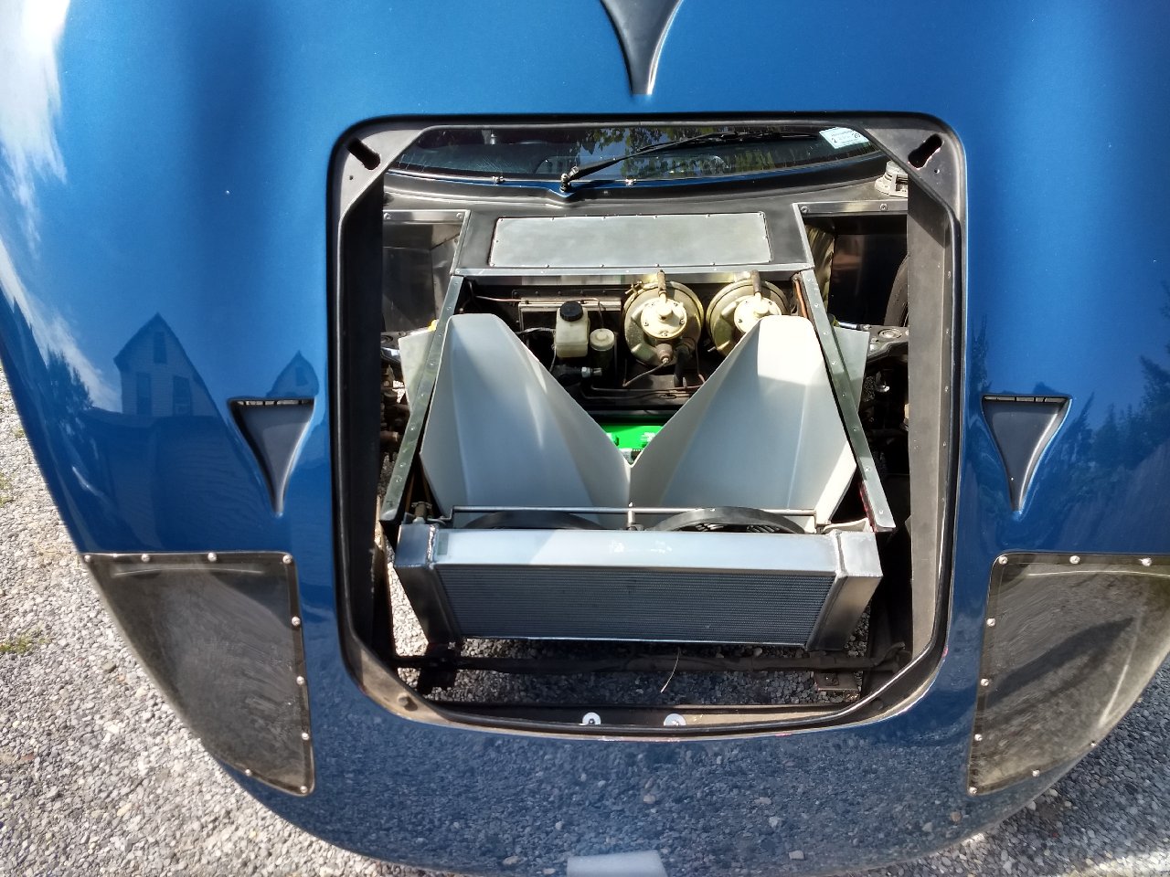

I use one of Lees deep double nostrils, highly recommended. (both the panel and him!)
I made a flange that the bottom and sides of the nostrils butt up to, to prevent any air from spilling around the sides.
Hopefully the pictures will make it clear;
100815
100816
And with the nostril in place;
100817

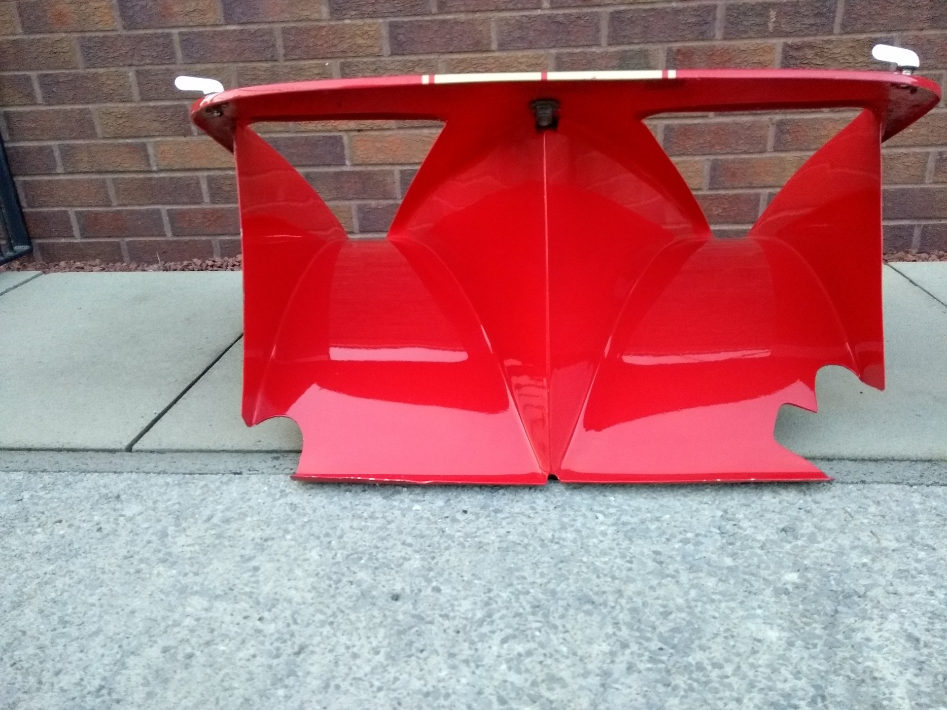

So guess what I just received? My panel- looks beautiful! Really nice work. It got to me in perfect condition. I can't wait to start this project! I just can't get over how good it looks.

Hello Dan,
if you follow the measurements in pictures I sent you, you will find the panel supplied is just about the right shape.
it will need a little fettling but not a great deal.
Lee

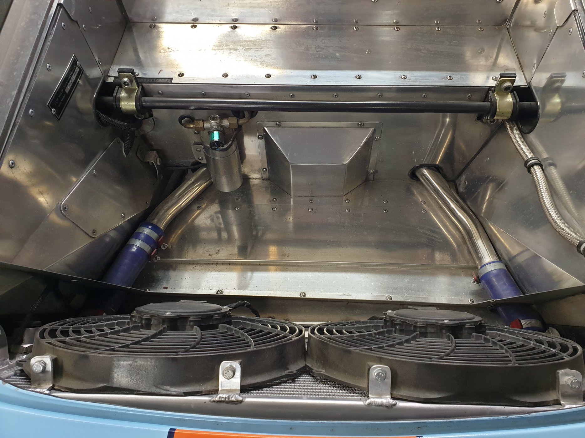

Hi Dan,
Here is a pic of the deep nostril from my GTD which should be a bit clearer.

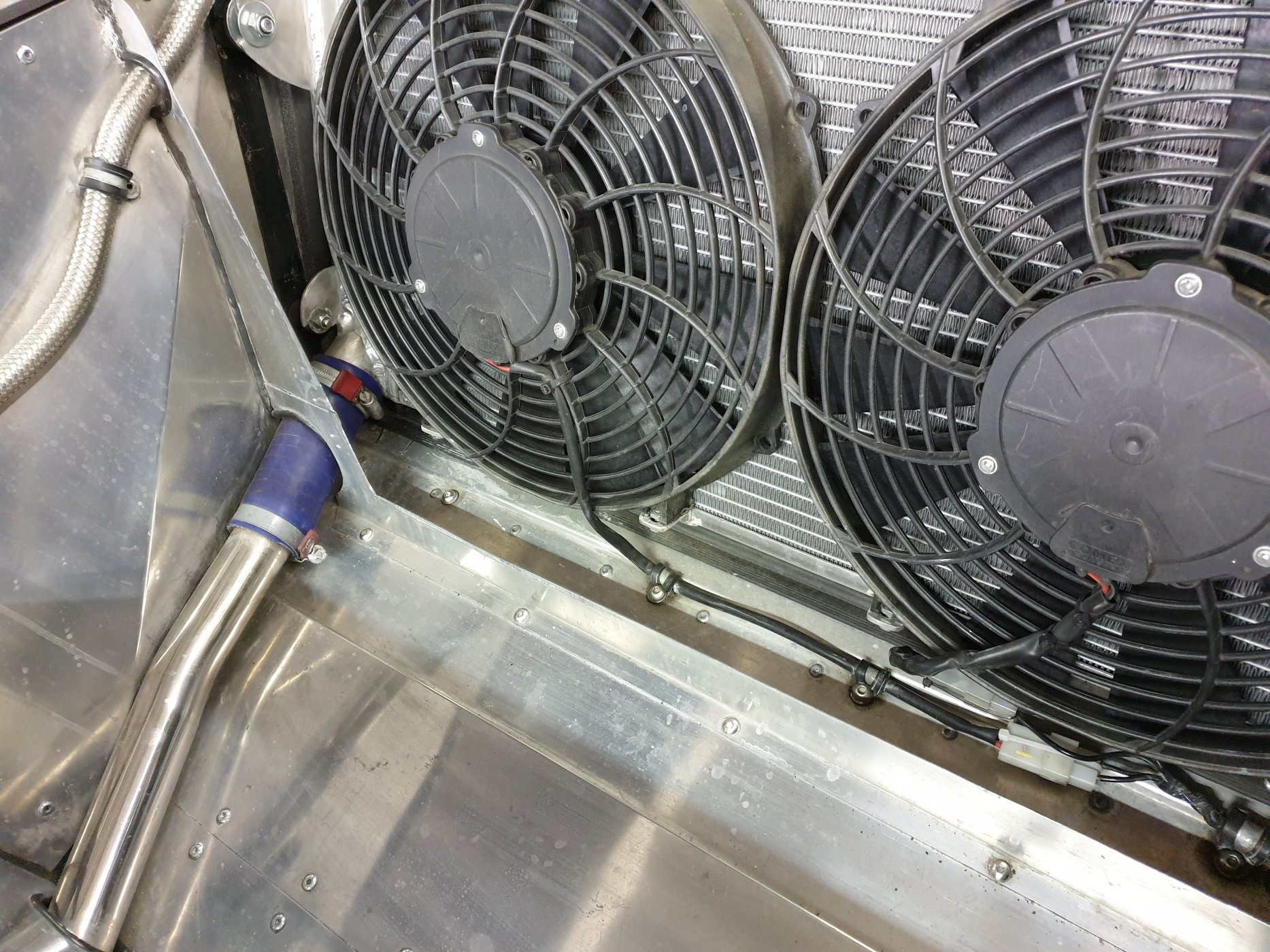

I did a little test fitting the other day to see what would have to be modified and found out that my fire system bottle has to be moved but thankfully the battery can stay. I am not going to install the panel right away but instead wait for the season to end first. I have been working on this car for 3 years and I am having the best year yet with it and don't want to rush anything. Here is a test fit pic.
