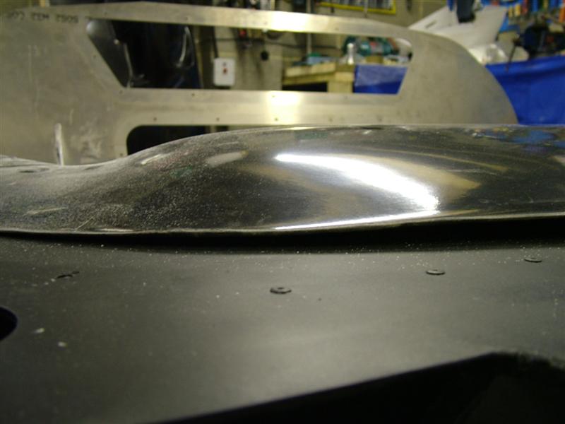

As you can see it varies massively from side to side, if I pull down the pass side it'll pull out at the front & there'll be a lot of tension on it. Seems like it came out of the mould warped.

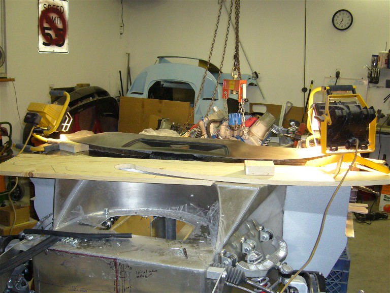

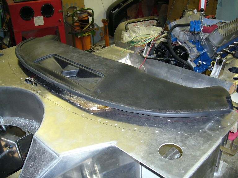

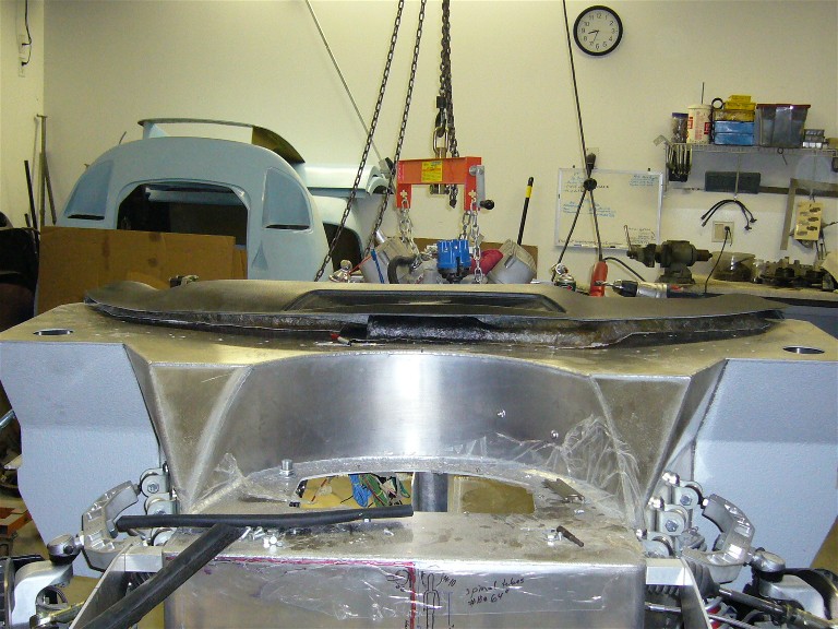

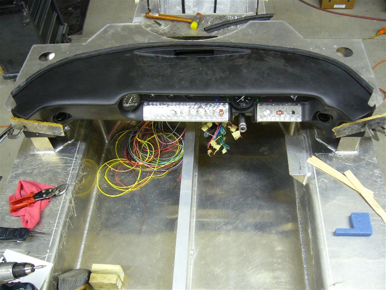

Jay,

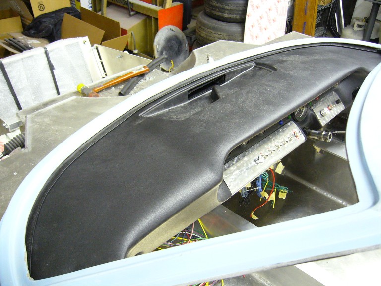

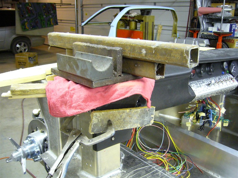

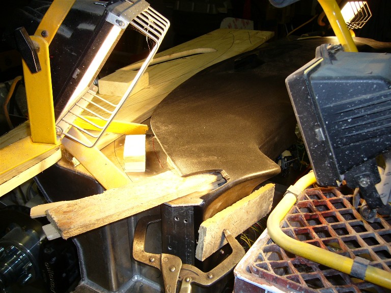

Rather timely discussion, as yesterday I tackled the same demon. Below are pics of the process I used. I first fit the dash, by trimming the bottom legs to sit flush to the pillars, then notched the top of the legs to fit the dash sub structure, clamped in place, fired up the spot lights (aka poor mans heat lamps). Once the material was getting hot to the touch, I started inserting paint stirring sticks one at a time (with some time between). I exceeded the desired position by ~10% assuming some relaxation (historises) would occur. Let cook for a while at this position, then removed lamps and applied weight. Added bulb type weather strip..and Baddaboom...baddabing... good to go. Hopefully this helps you.
Rob

The substructure is the plenum that we have been working on for the AC system to eliminate all the hoses dangling under the dash....it works well and is very clean....its a standard part with the RCR AC system that everyone with a DP kit will receive...very very shortly.

I also noticed that Rob has cut a hole in the dash for the demister air. Is that where the originals were cut? Do I need to add rubber weatherstripping to the front edge as Rob has?
Bill D
The RHD dash is moulded from an original car and as such the dash would nest against the steel innner roof panel...being fiberglass our roof does not have this surface and Vintage Venom/Rob solved this by adding a rubber Bulb type seal to eliminate any gaps or fitment issues that this may have caused. The LHD dash does not have this idiosyncricity as we moulded it around using a fiberglass roof..not steel....
The hole is his choice of location ..as far as I can determine....it becomes invisible once installed in the car anyway.
